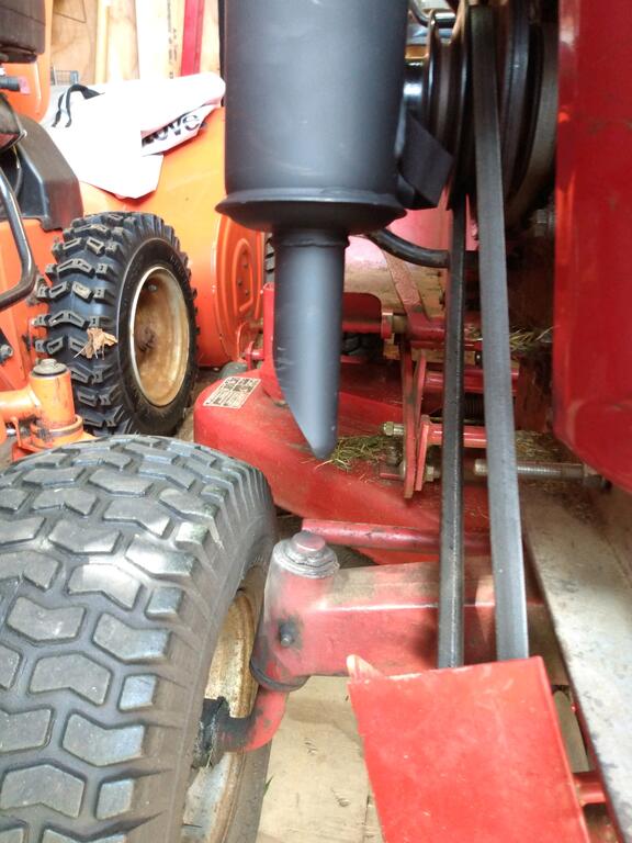

CCW 1,505 #1 Posted July 30, 2023 First a testament to keeping the tractor garaged. My 36 year old 312-8 has always been garaged and today I finally had to replace the original muffler. After 36 years it did not owe me anything. Amazingly the bolt that secured the muffler bracket to the engine came right out with a simple box wrench. The two nuts on the muffler clamp unscrewed without difficulty using a socket wrench. I was able to reuse the muffler clamp without any difficulty, just a bit of oil on the threads. Now my question and concern. My new muffler had to be positioned facing straight down and the exhaust point is just a couple of inches inside the front tire and only a few inches above. I am a bit concerned with the heat of the exhaust hitting the tire all the time. 3 Share this post Link to post Share on other sites

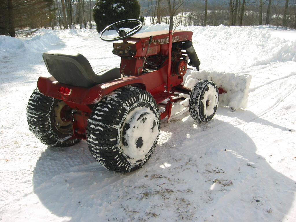

pfrederi 20,655 #2 Posted July 30, 2023 Probably won't hurt the tire unless it sits in one place while running. I just angle mine forward. 4 Share this post Link to post Share on other sites
ebinmaine 79,116 #3 Posted July 30, 2023 Just now, pfrederi said: Probably won't hurt the tire unless it sits in one place while running. I just angle mine forward. Exactly what I was thinking. My muffler on the Automatic C160 is a Gravely replacement so it's shorter than yours but I angled it forward as well. 2 Share this post Link to post Share on other sites
ri702bill 12,230 #4 Posted July 30, 2023 Or... take it to a good Muffler shop - have them cur the exhaust tip off half way up, rotate it (forward or back) and weld it up...... 2 1 Share this post Link to post Share on other sites
CCW 1,505 #5 Posted July 31, 2023 The original muffler was supported with the bracket. I notice in the @pfrederi photo that the muffler does not appear to have this second support. Do you, @ebinmaine, support your muffler in a second location. I have the option of turning the muffler straight up and removing the second support bracket completely or is this a bad practice? Share this post Link to post Share on other sites
ebinmaine 79,116 #6 Posted July 31, 2023 31 minutes ago, CCW said: The original muffler was supported with the bracket. I notice in the @pfrederi photo that the muffler does not appear to have this second support. Do you, @ebinmaine, support your muffler in a second location. I have the option of turning the muffler straight up and removing the second support bracket completely or is this a bad practice? I have two tractors with after market mufflers. My 1974 c160 8 speed has a stack with a black iron pipe inlet and elbow and a fairly heavy muffler. I do have a brace bracket supporting that. My 1975 C160 Automatic has only a short piece of black iron for the inlet pipe and the muffler is clamped directly to that. It's a much smaller Gravely style muffler which is much lighter than the other one. No outlet pipe exiting the muffler. It's a big difference in weight compared to the other setup and I'm confident that it will be fine without a bracket. Share this post Link to post Share on other sites

CCW 1,505 #10 Posted July 31, 2023 (edited) Hopefully final solution. I turned the muffler 180 degrees and it is now facing up. Exhaust pipe points out to the right and hopefully this works without putting exhaust in my face. Once clamped in place the muffler support bracket that is part of the unit is just far enough out to allow the hood to open and close without interference. Edited July 31, 2023 by CCW 1 Share this post Link to post Share on other sites
