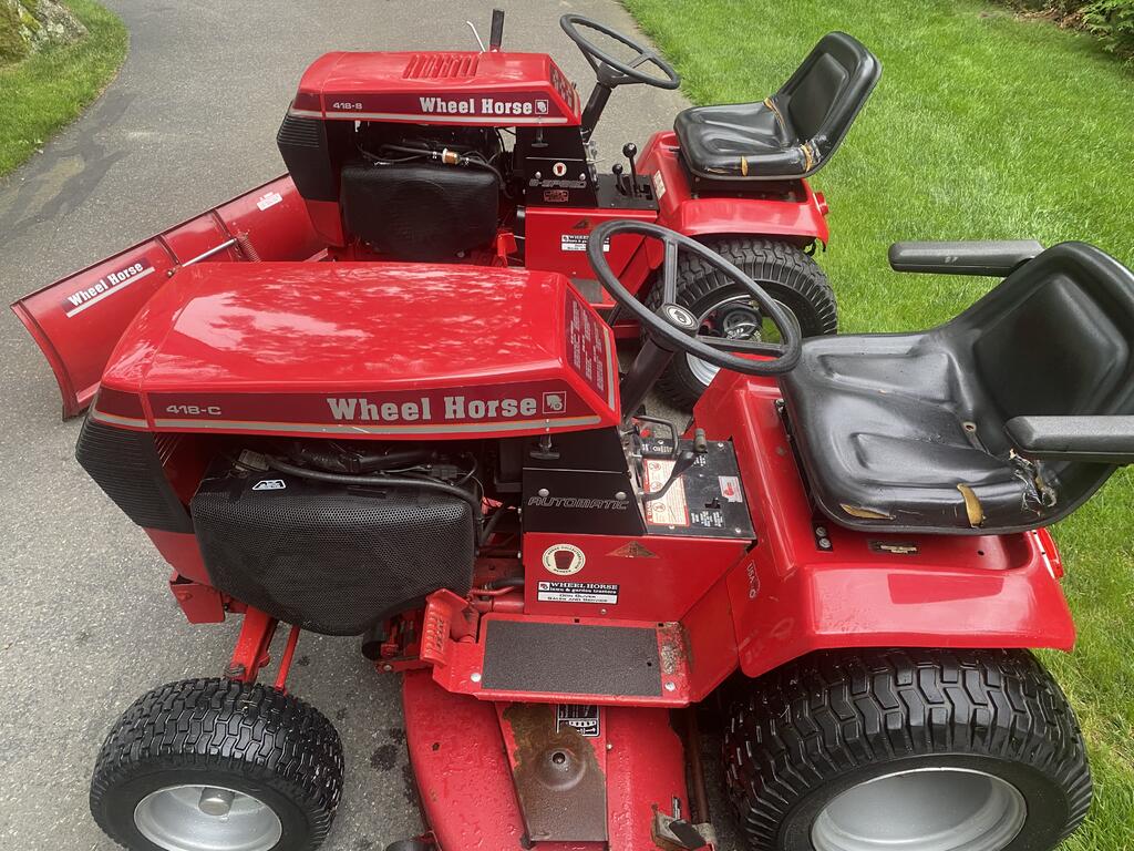

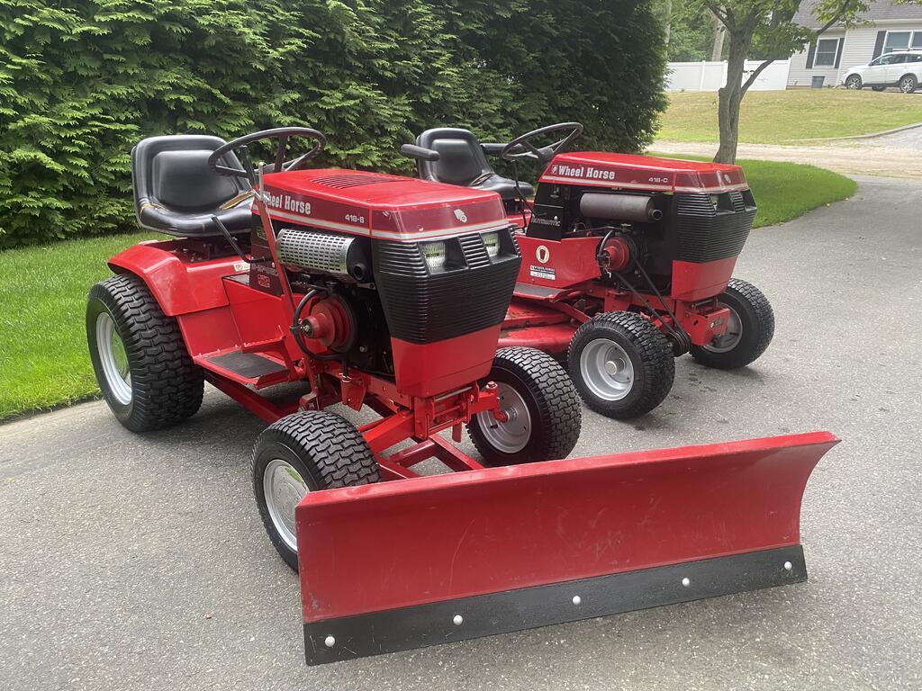

c-series don 9,984 #1 Posted July 22, 2023 I recently bought a 418 that sat for years. So when I got it home I drained the fuel until the tank was basically bone dry and replaced the fuel line. I put an inline filter in the new line. It then ran okay, not great but okay. Recently it would start and run for about two minutes then die. Not wanting to remove and clean the carburetor, I tried to cheat and just use some Seafoam in the gas. Well that seamed to help but I know I’m going to have to remove and clean the carburetor if I want to to run correctly. Today when I let it run for a while I noticed that the intake manifold was sweating profusely, I mean it was dripping!!! I’ve never seen any of my other tractors do this? Yes today it is warm and humid but again I’ve never seen this before. I have three tractors with the same motor. Can someone please tell me what would cause this?? Also it seems like it’s getting too much fuel and I want to turn the high speed adjustment screw in a bit but there is no screw! Only what appears to be the low speed screw and I turned it all the way in and nothing changed? Could excessive fuel going through the manifold cause the sweating? Share this post Link to post Share on other sites
