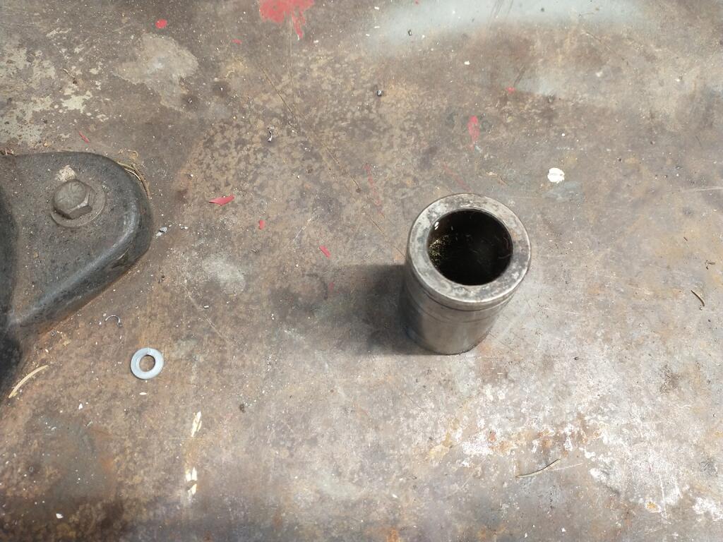

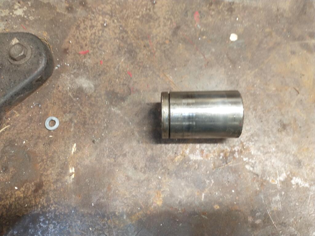

TC10284 124 #10 Posted July 25, 2023 (edited) So I've found out that the clutch disc plate will fit, but when I put the race bearing on, it causes it to misalign and I cannot mount the retainer clips. The PTO shaft is a lot smaller on the M8 than a K301 or M10/M12 that I have compared to on my other tractors. Yet the race bearing P/N on partstree is the same for a 308-8 and 312-8. Does anyone else know if this is correct for the PTO shaft of the M8? Additionally, I've found that some of the aftermarket clutch disc plates are not thick enough and will bend the retainers when trying to mount. I'd have to use a washer on each bolt, behind the retainer, to attempt to get it to line up with the groove on the race bearing. Is it an issue if a washer has to be used? 308-8 https://www.partstree.com/models/21-08k802-308-8-toro-lawn-tractor-1986/pto-clutch-and-control-20/ 312-8 https://www.partstree.com/models/21-12k804-312-8-toro-garden-tractor-1987/pto-clutch-and-control-20/ Edited July 25, 2023 by TC10284 Share this post Link to post Share on other sites
TC10284 124 #11 Posted July 26, 2023 (edited) Just wondering if anyone had any input on the pto shaft size on the M8 vs M10/M12 Edited July 26, 2023 by TC10284 Share this post Link to post Share on other sites
gwest_ca-(File Mod) 12,533 #12 Posted July 26, 2023 The 8hp Kohler engines Wheel Horse used have 1" diameter pto shafts along with the first 10hp models 1964-1965 The B&S engines Wheel Horse used also have 1" diameter pto shafts. The rest have 1-1/8" diameter pto shafts. 3 Share this post Link to post Share on other sites
TC10284 124 #13 Posted July 27, 2023 (edited) On 7/26/2023 at 8:11 AM, gwest_ca said: The 8hp Kohler engines Wheel Horse used have 1" diameter pto shafts along with the first 10hp models 1964-1965 The B&S engines Wheel Horse used also have 1" diameter pto shafts. The rest have 1-1/8" diameter pto shafts. Thank you sir. You're always helpful any time I post and I appreciate that. I assume I need a race bearing that is 1" on the ID instead of 1-1/8" on the ID. And that's where I get messed up because there doesn't appear to be a different sized race bearing that I know of. Unless I can get a shim of some type. Edited July 27, 2023 by TC10284 Share this post Link to post Share on other sites
Gasaholic 398 #14 Posted July 27, 2023 11 minutes ago, TC10284 said: Thank you sir. You're always helpful any time I post and I appreciate that. I assume I need a race bearing that is 1" on the ID instead of 1 and 1-1/8" on the ID. And that's where I get messed up because there doesn't appear to be a different sized race bearing that I know of. About 8 or 10 years ago, I had a Work Horse (Wheel horse tractor in grey paint with Briggs engines) that I needed a race bearing for, only one I could get at the time was the 1-1/8 ID bearing, then I found a 1" to 1-1/8" sleeve adapter that I bought aftermarket - I cannot for the life of me think where I found it, however, just that it was a sleeve adapter (They were more commonly used in heavy duty truck service to repair axle spindles that would otherwise have leaked at the wheel seals... I might have gotten a sleeve from CR (Chicago Rawhide) Seals might be worth searching around sources like that? 1 Share this post Link to post Share on other sites
TC10284 124 #15 Posted July 27, 2023 (edited) 6 minutes ago, Gasaholic said: About 8 or 10 years ago, I had a Work Horse (Wheel horse tractor in grey paint with Briggs engines) that I needed a race bearing for, only one I could get at the time was the 1-1/8 ID bearing, then I found a 1" to 1-1/8" sleeve adapter that I bought aftermarket - I cannot for the life of me think where I found it, however, just that it was a sleeve adapter (They were more commonly used in heavy duty truck service to repair axle spindles that would otherwise have leaked at the wheel seals... I might have gotten a sleeve from CR (Chicago Rawhide) Seals might be worth searching around sources like that? Thanks! I actually remembered I have a couple Workhorse GT's sitting waiting on me to fix them up. I may check to see if it has that part/sleeve that I could use. Otherwise, I will start googling. Edited July 27, 2023 by TC10284 Share this post Link to post Share on other sites
76c12091520h 4,292 #16 Posted July 27, 2023 I have plenty of the 1 inch Id races in stock if you need. 2 Share this post Link to post Share on other sites
squonk 48,326 #17 Posted July 27, 2023 This is what you need. PTO sleeve of of an 8 HP Kohler. 2 Share this post Link to post Share on other sites
