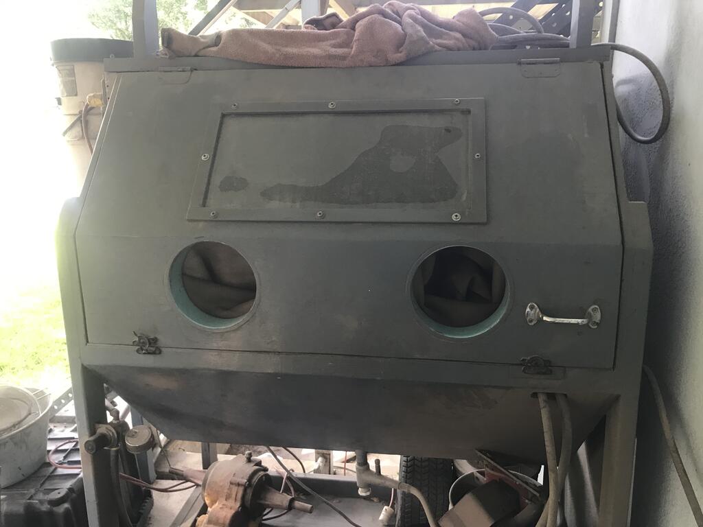

rmaynard 17,549 #6 Posted July 11, 2023 I have a Harbor Freight blast cabinet that I've heavily modified with brighter lights, better air flow, easily removable viewing glass (it will get etched quickly), a foot pedal, and other things. I have a dust collection system that is a must. As large as it is, it's still too small for parts like hoods, frames and fender pans. An outside blaster will handle bigger things, but it will consume a lot of media, and you must wear protective clothing, mask, and face protection. Sandblasting is great, but there are a lot of limitations. Liquid paint removers have gotten ridiculously expensive, but they do work well. 4 Share this post Link to post Share on other sites

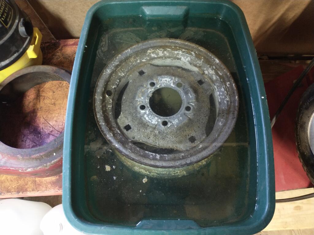

squonk 47,990 #9 Posted July 11, 2023 Another thing about blasting. I'm getting a lot of arthritis in my hands. They cramp up holding the piece and pulling the trigger for hours. A foot pedal is a must. I bought a pair of wheels at the show. They were in pretty good shape but the inner side had some rust. I had it in the electrolysis tank for about a week. Pretty tough paint. I power washed it and I have it in the vinegar bath to soften the remaining paint. Garage smells like my Grandmother is making salad. Thanks for the bin @rmaynard! 4 Share this post Link to post Share on other sites

pacer 3,180 #19 Posted July 11, 2023 @oliver2-44 Looks like you have adapted one of the - many - improvements on the HF cabinets .... dropping the work surface. I have also done all the many improvements to the cabinet and dropping that work surface has to be one of the better ones. I also did the media drop from the bottom, added better lighting, foot pedal, water filter, heavy duty dust collector, etc etc. 1 Share this post Link to post Share on other sites
