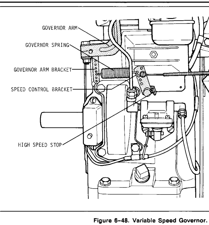

oliver2-44 11,214 #5 Posted July 9, 2023 I'm grasping at straws, but I'm wondering if your governor spring is weak? Can you borrow one from another Kohler and try it? Also for safety and to protect your engine you could adjust the high speed stop bracket on the carburetor to limit throttle travel to equal 300 rpm. This doesn't "fix" whatever the reaal issue is, but is kind of a stop gap measure. 1 Share this post Link to post Share on other sites
squonk 45,533 #6 Posted July 9, 2023 (edited) You can limit the top speed with the high - speed adjustment arm Edited July 9, 2023 by squonk 3 1 Share this post Link to post Share on other sites

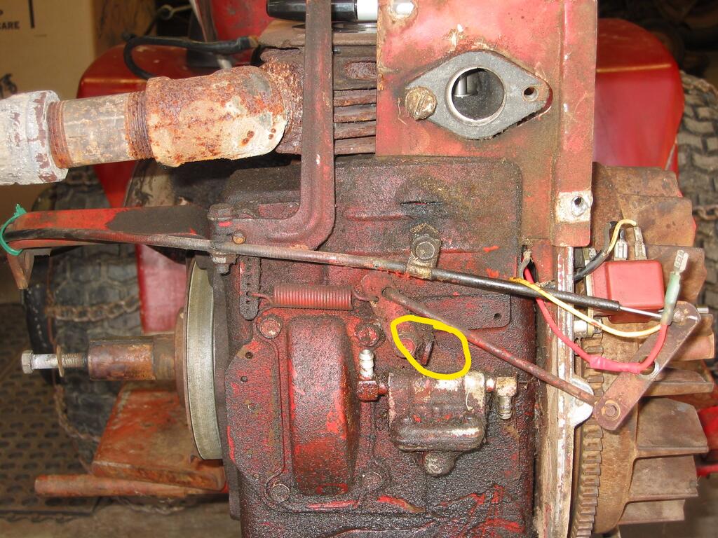

pfrederi 19,887 #7 Posted July 9, 2023 Loosen the bolt and rotate the stop (yellow circle) counter clockwise a bit. 3 1 Share this post Link to post Share on other sites

cafoose 3,594 #11 Posted July 9, 2023 @squonk @pfrederi @oliver2-44 Mike, Paul, and Jim. The throttle stop did the trick. Now it idles at 1350 and high speed is around 3200 if I hold the throttle out. 1 3 Share this post Link to post Share on other sites
