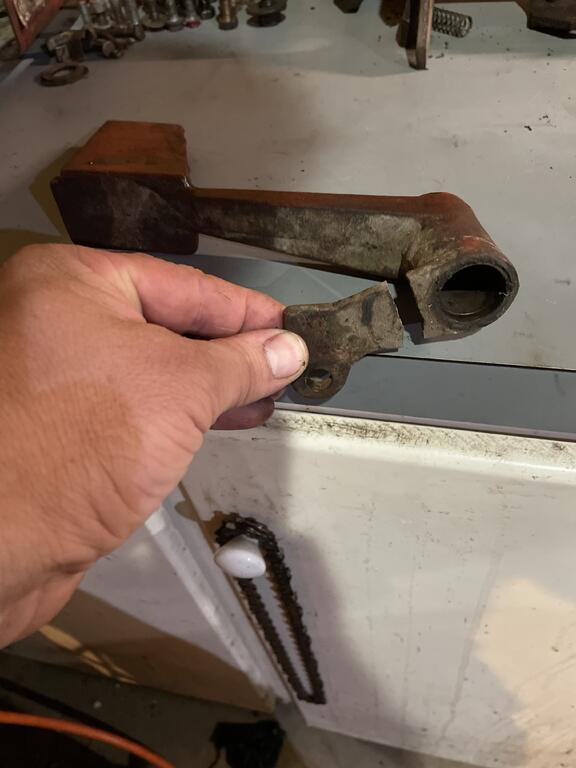

I was wandering are the parts on these tractors cast iron? I broke this off of the foot pedal and was wanting to weld it back together..
Edited by mower
Mickwhitt
Mower, yes its cast iron I believe.
It can be welded but I'm not sure how strong it would be for a control pedal.
Maybe someone here has a spare laying around.
Mick
What's the print on the foot surface of the pedal?
Thatoneguy
I am not sure what this means Ebinmaine.
Is it a plain pedal with no words? Or does it have something cast into it like CLUTCH or BRAKE?
Thatoneguy
It says "BRAKE"
It would be a good idea to put an ad in our Wanted Section. I can check with a couple guys up here too just for kicks.
Handy Don
Readily available replacements. Place a “wanted” in classifieds or go directly to K&B or A-to-Z in our vendor list.
Cast iron is, as you likely know, weldable but good resulting strength at the joint is challenging. I agree with @Mickwhitt that a welded, safety-related part would be a concern for me.

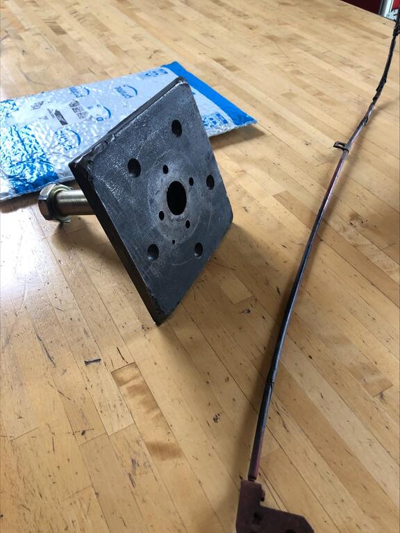

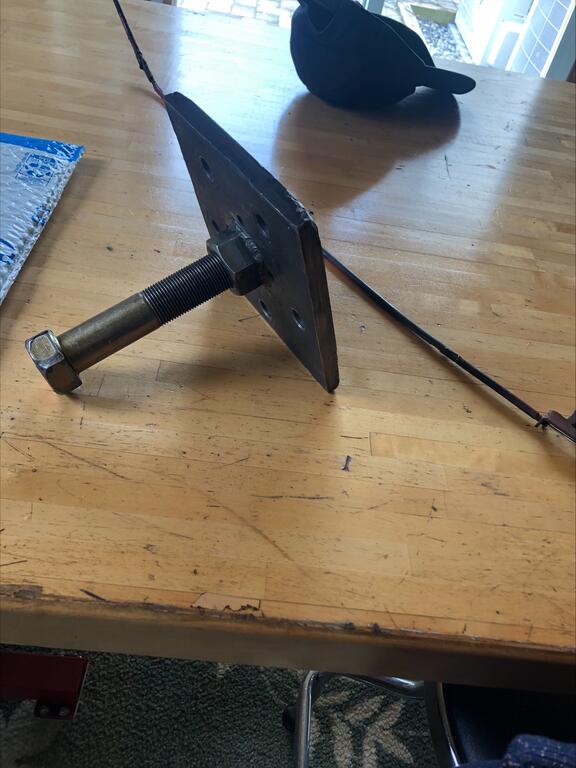

1 hour ago, richmondred01 said:
You need the right puller….
Just so happens I have everything on hand to make that and I am going to today!
Post pics!! :handgestures-thumbupright:

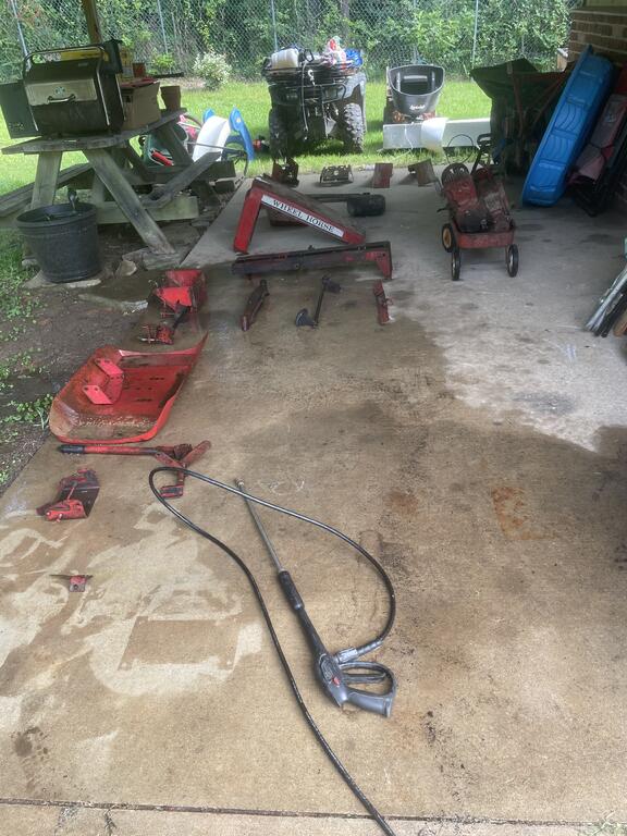

Thatoneguy
It’s wash day! :happy-partydance:47C93949-D5C0-45B6-93C6-A1B3E4FC008D.jpeg.60cd57234953b2bffef8f803f8c0d4da.jpeg
Thatoneguy
@richmondred01 what size bolt is that?
Bolt size is optional.
Can be anything above ¾ or so really.
@Achto what's your puller got for a center bolt?
Handy Don
Easier to control the force being applied if the bolt has a fine thread.
Thatoneguy
I went with a 1”x6 1/2. I just got the nut welded on and letting it cool off so I can drill the lug holes
