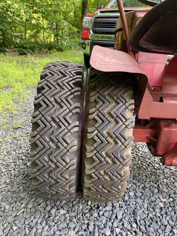

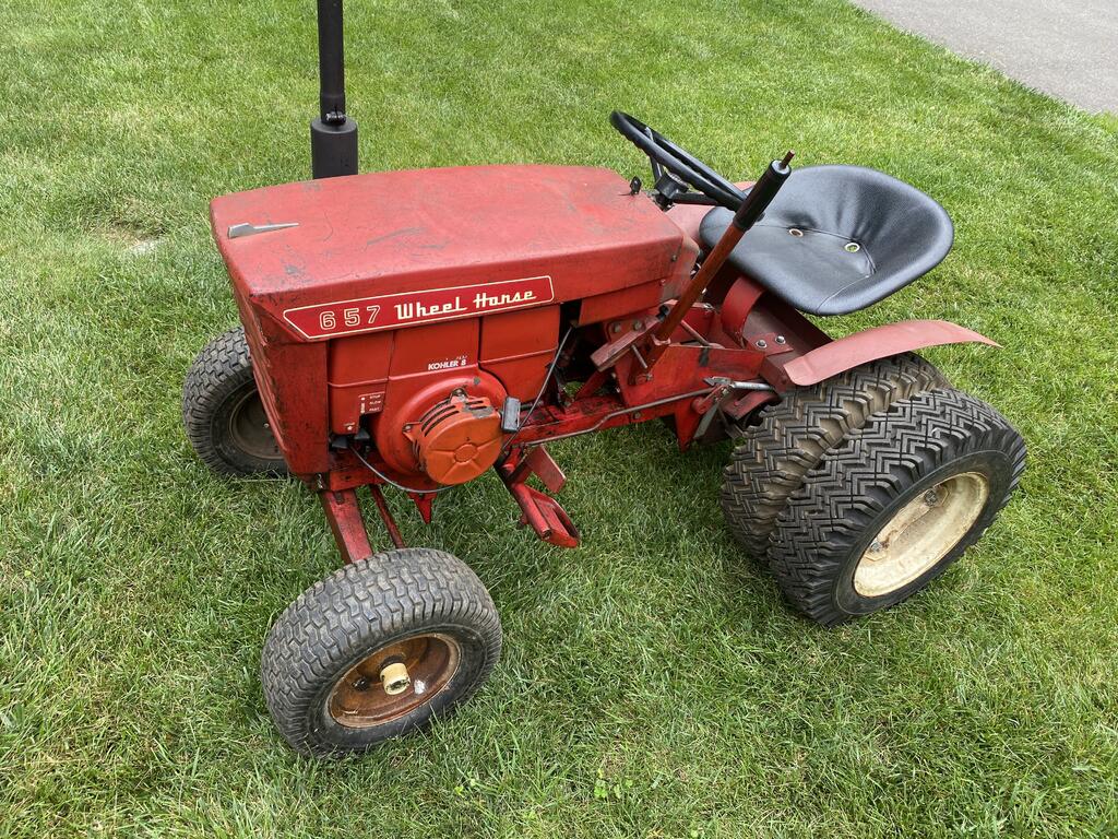

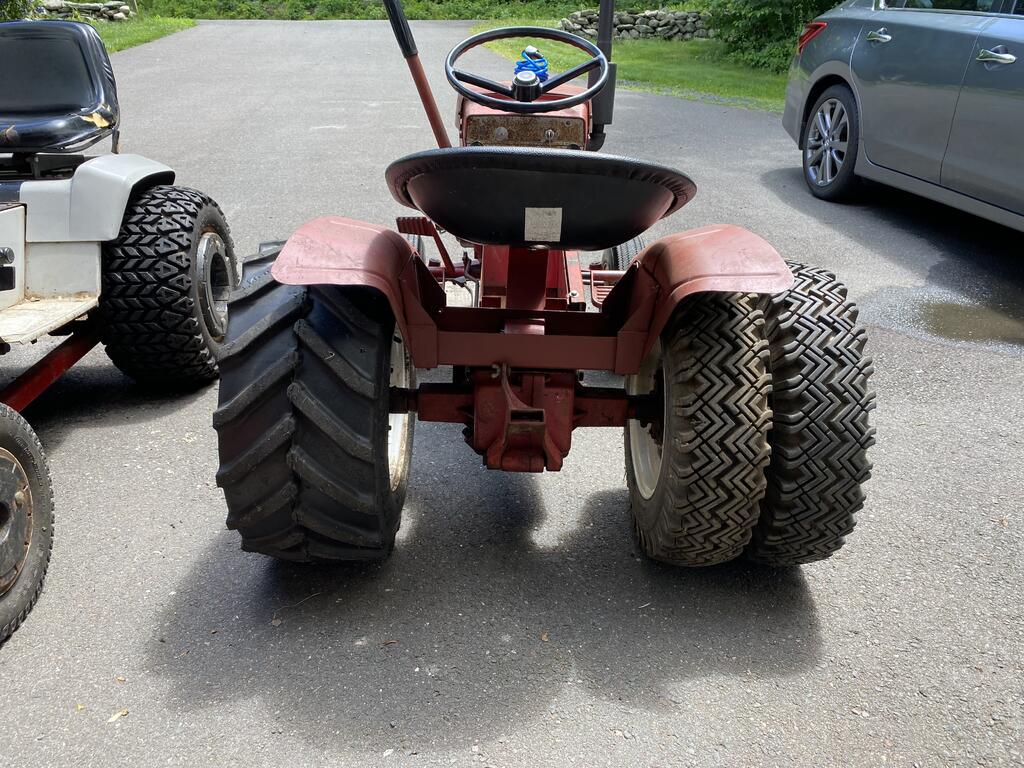

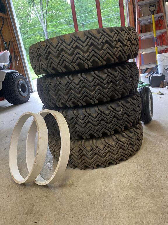

Sparky-(Admin) 25,509 #1 Posted July 3, 2023 Been considering trying dual 6x12’s on my mutt tractor. Kinda bored with the 23x10.5 Carlisle AG’s that have been on it awhile. I had a pair of tires and recently picked up a matching pair from @TonyToro & @TonyToro Jr.. Bought these rings from @Pullstart at the WHS and today was the day to get em installed. Wanted the space between rubber to be tight, Kevin cut them narrow, but I wanted tighter so off came almost another 3/8”. Hit em with sandpaper and a quick coat of flat red. Four 1/2”x8” pieces of all-thread per side and here’s the finished product. Might swap the fronts for something a bit wider. 10 1 Share this post Link to post Share on other sites

ebinmaine 79,103 #4 Posted July 3, 2023 Remember to knock the air pressure way way down in that outside Tire and maybe keep the inside one up pretty tight. 12, 15 lb. 3 2 Share this post Link to post Share on other sites

Darb1964 1,169 #9 Posted July 3, 2023 33 minutes ago, ebinmaine said: Remember to knock the air pressure way way down in that outside Tire and maybe keep the inside one up pretty tight. 12, 15 lb. I ended up taking mine off and has been the right move. They seem to bind up no matter what I did. 1 Share this post Link to post Share on other sites

Sparky-(Admin) 25,509 #11 Posted July 3, 2023 1 minute ago, Darb1964 said: I ended up taking mine off and has been the right move. They seem to bind up no matter what I did. This tractor doesn’t do any work, just goes to shows and putts around. 5 1 Share this post Link to post Share on other sites
ebinmaine 79,103 #12 Posted July 3, 2023 2 minutes ago, Darb1964 said: I ended up taking mine off and has been the right move. They seem to bind up no matter what I did. Can you please elaborate on that? 1 Share this post Link to post Share on other sites

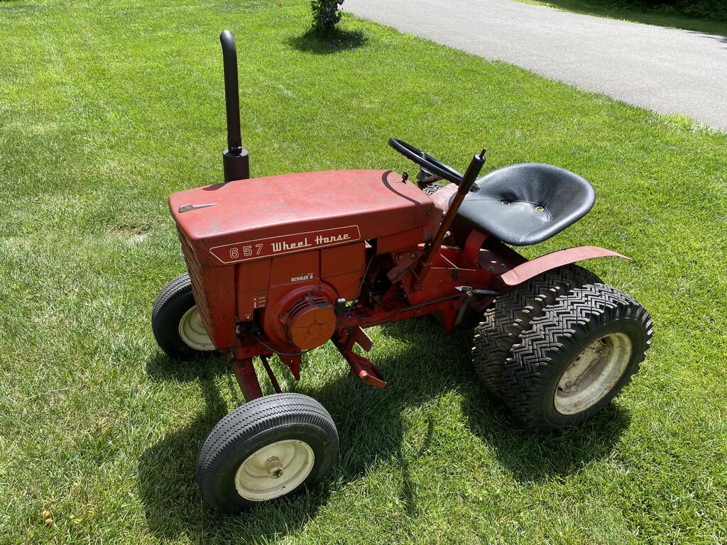

Sparky-(Admin) 25,509 #13 Posted July 3, 2023 Just put fatter fronts on it, looks a bit more proportional now. 6 2 Share this post Link to post Share on other sites
Darb1964 1,169 #14 Posted July 3, 2023 21 minutes ago, ebinmaine said: Can you please elaborate on that? I picked the tractor up very used and it had different brand tires on it but the same size. They didn't hold air well so I had to air them up and tighten up the lugs before each use. They would make crunching noises and loosen up under very little stress i tried the air pressure differences like you mentioned, it did help some. All was probably a factor, I had a pair of good tires and rims so I put them on and with a lot of weight it works very good. Don't need as much clearance either, amazing how many places I can get with the singles on. 2 Share this post Link to post Share on other sites
wallfish 20,025 #15 Posted July 3, 2023 Looks better with the wider fronts IMO 2 1 1 Share this post Link to post Share on other sites

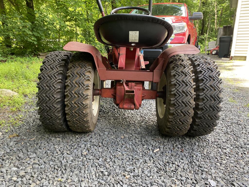

ri702bill 12,216 #20 Posted July 3, 2023 And glad to see 5 bolt hubs, not the winged flimsy 3 bolt 702 style (that would NOT hold up to the added side load) There is NO way to look cool chasing a runaway pair of tires and rims down a hill while attempting not to drop your straw... 4 Share this post Link to post Share on other sites

Wheel-N-It 2,978 #22 Posted July 3, 2023 3 hours ago, wallfish said: Looks better with the wider fronts IMO Ditto. I like the overall look much better Mike. That's one fine looking tractor now !! 1 Share this post Link to post Share on other sites
