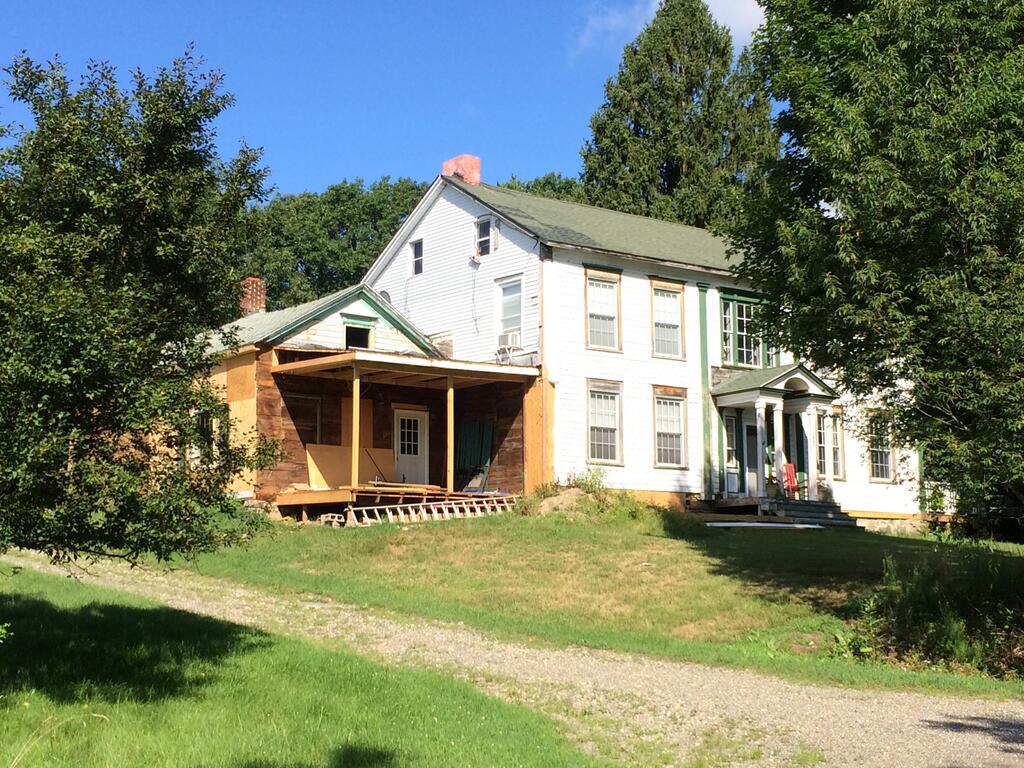

dalez 148 #1 Posted July 2, 2023 (edited) No idea how to title this thread so ir it gets anyone's attention that is good. The picture shown is my grandparents home, both long gone. House has been renovated but the structure is the same. What I am trying to do is figure out which was built first, the small building on the left or the colonial portion. They share the one wall between them. I may have some access if questions need to be answered. Supposedly the house is from late 1700's. In my eyes the small building would have been original and the colonial added on after but I have nothing to base that on except a low priced home at first then adding on. Upstate NY if it matters Dalez Edited July 2, 2023 by dalez add photo 1 2 Share this post Link to post Share on other sites
WHX?? 58,388 #2 Posted July 2, 2023 56 minutes ago, dalez said: the small building on the left or the colonial portion. They Hard to say from pics but looking at how the two structures are tied together would be a tell tale. Best guess from here the smaller one may have been added as summer kitchen? Share this post Link to post Share on other sites
formariz 12,381 #3 Posted July 2, 2023 House is classical style and design of period and location. Small building was added later. Photo with incomplete renovation shows where first floor window was located prior to small building being built. Gable end of house would have been similar to the one on photo below from nearby. can you get detailed photos of the details on the portico? 2 Share this post Link to post Share on other sites

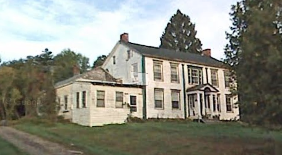

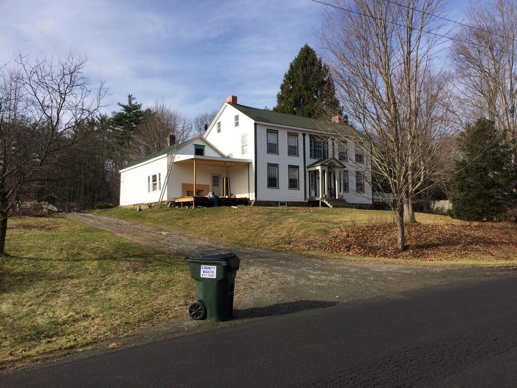

dalez 148 #5 Posted July 2, 2023 (edited) Realor pictures of house after remodeling. https://www.redfin.com/NY/Averill-Park/229-N-Nassau-Rd-12018/home/72346786 Google street shot from before remodel. Edited July 2, 2023 by dalez add photo Share this post Link to post Share on other sites
