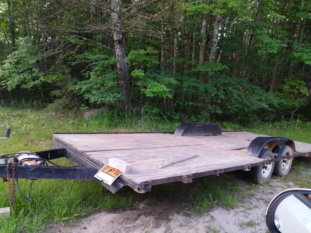

ebinmaine 80,458 #1 Posted June 23, 2023 (edited) **** Formerly titled "BOUGHT IT!! Thoughts and advice on this trailer?" **** I've decided to use this thread as the build documentation because there's a fair amount of good information already here. Used to be a camper obviously. Supposedly a 20 ft deck. I know at minimum every piece of wood needs to be replaced and I would put four new tires plus a spare. Price is right.... Edited July 2, 2023 by ebinmaine CHANGE TO BUILD THREAD 1 Share this post Link to post Share on other sites
ri702bill 12,911 #2 Posted June 23, 2023 (edited) My son-in-law bought the lower half of a 2 wheel popup camper, once the body was removed & scrapped. By design, the weight is somewhat evenly distributed from the factory. Once it is a flatbed, all bets are off. When they were moving to their present house from their first, he overloaded it with the 1500 lbs + of rock from their koi pond placed up front and furniture at the rear. He managed to distort and buckle the two C-shaped tongue rails where they join the front rail - leaving about 2 inches of ground clearance. He repositioned the rock and got home. The fix was to heat and bend the rails back, add a heavy cross brace in the middle of the triangle and add a "backbone" from a section of 3 inch iron pipe from the center of that brace, thru a hole in the front rail and into the second rail. My son welded it all up - no more bending issues. He also replaced the original springs and axle to a heavier unit that positioned the wheels outside the frame rails, not what is shown to give more load space. I have borrowed it on occasion, tows well. If it is priced dirt cheap, and the springs, axles, hubs are all good - it might be a good start. Does it have either elecrtic or surge brakes?? If it does and they do not work, it can get expensive to fix... One more - does it have a clean title and a previous registration??? The DMV will want one or both. Here, you have to jump thru hoops to register a built from scratch homemade trailer, as I posted before.... Bill Edited June 23, 2023 by ri702bill 4 Share this post Link to post Share on other sites

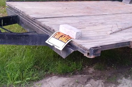

Handy Don 17,380 #3 Posted June 23, 2023 3 minutes ago, ri702bill said: elecrtic or surge brakes Is there a readable info plate on the tongue for load rating and other data? I’d really want to look at the structural members under the wood for: a) adequacy to support loads across the flooring (not just at the edges), and b) anything that has compromised them (rust, bending, etc.) The heavy front beam signals it was designed for a pretty heavy tongue weight. I’d also want to track down the wiring that I see. The stake pockets have been added...adequately? @ri702bill’s comment about brakes is also on point (and in your wheelhouse, right?) 3 Share this post Link to post Share on other sites
SylvanLakeWH 32,279 #4 Posted June 23, 2023 I would think the camper frame was baked into the design for rigidity / strength. Removing that would change the dynamics of the design of the bed. I would jack it up and spin tires to check bearings. Look closely at frame - cracks / past bends fixed etc.Appears the frame is lighter gauge than typical for a flatbed of that size... 2 2 Share this post Link to post Share on other sites
ri702bill 12,911 #5 Posted June 23, 2023 6 minutes ago, SylvanLakeWH said: Look closely at frame - cracks / past bends fixed etc.Appears the frame is lighter gauge than typical for a flatbed of that size... Strong points, all. As mentioned, the house ontop added to the rigidity of the lighter gauge frame that was "reduced" to lighten it. Definetly inspect the underside (not just for wasp nests!!) - a structural "field fixed" repair could be a show stopper. Is there any evidence of it being in an accident - I would measure diagonally each side to check if it either a square or a parallelogram.... 2 Share this post Link to post Share on other sites
ri702bill 12,911 #6 Posted June 23, 2023 (edited) I spotted a potential issue - maybe... Look at the shape of the front beam - is it just a cantilevered angle?? Are there stiffener gussets behind it.? That must flex a lot taking off or stopping..... makes a good arguement for a central "backbone"... Edited June 23, 2023 by ri702bill 2 1 Share this post Link to post Share on other sites
ebinmaine 80,458 #7 Posted June 23, 2023 3 minutes ago, ri702bill said: I spotted a potential issue - maybe... Look at the shape of the front beam - is it just a cantilevered angle?? Are there stiffener gussets behind it.? That must flex a lot taking off or stopping..... That's how All the old campers are that I've ever seen or owned. All good stuff people. Keep it coming. 2 Share this post Link to post Share on other sites
ebinmaine 80,458 #8 Posted June 23, 2023 1 hour ago, ri702bill said: One more - does it have a clean title and a previous registration??? The DMV will want one or both. I don't need either one of those things here 2 Share this post Link to post Share on other sites
ebinmaine 80,458 #9 Posted June 23, 2023 Bought it. Wiring is a little bit cobbled but he claims it works. One or two of the five tires is maybe usable as spares. Frame and suspension looks good. It does have brakes but he hasn't used them for several years. Can't really tell if the frame is straight just laying on the ground but it looks good. 2 Share this post Link to post Share on other sites
ri702bill 12,911 #10 Posted June 23, 2023 (edited) 19 minutes ago, ebinmaine said: Can't really tell if the frame is straight That is where the "X" diagonal check comes in - I would be OK if they were within 1/4" or better over that length. Used that method for making custom machine skids for years...And the 3-4-5 method to check if a specific corner is square - or not. Are you familar with the last method?? Edited June 23, 2023 by ri702bill 2 Share this post Link to post Share on other sites
