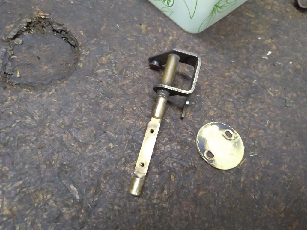

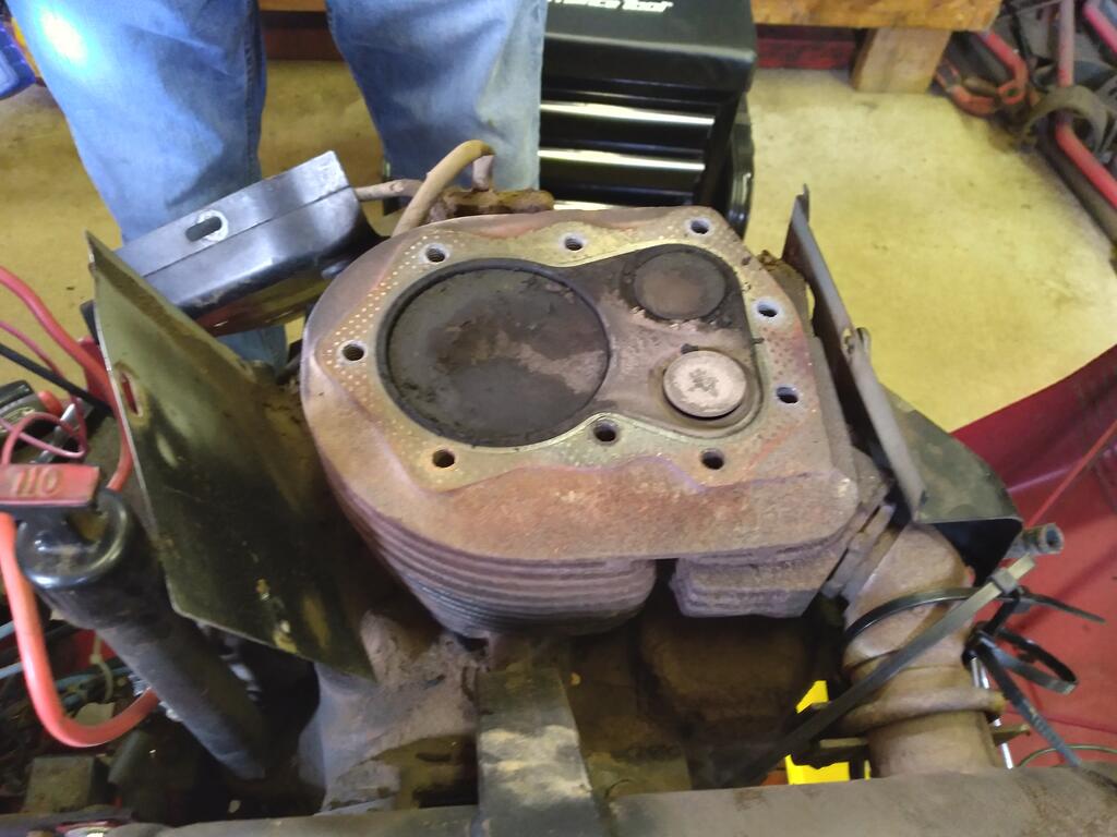

D_Mac 9,339 #1 Posted June 11, 2023 (edited) So some of you may know I picked up a 310-8 for free. Previous owner said it ran but ran at full throttle and would not idle down. He had it picked up and brought to a local repair where it was decided it wasn't going to be fixed. It was offered to me and I picked it up at the repair shop. The carb was damaged. Throttle plate had come loose from the shaft. Carb was worn badly where throttle shaft goes through the body of the carb. Pulled the head to look for damage and found none. Valves and piston working as they should. Replaced head gasket and ordered s cheap carb off Epay. Remember the previous owner said it was running and I have no reason to doubt him. Installed the new carb with new gaskets and fuel filter. Would not start. Ran on starting fluid but that's all. Figured I got a bad cheap carb and ordered another. When it arrived , installed it and it ran only with choked closed. Could it be 2 bad carbs? Talked on here on another thread and decided to order a carb from Isavetractors. Installed it as it was shipped, will not start or run. Only on starting fluid. Pulled the screen out of gas tank, cleaned it. Drained all gas out of tank and poured in fresh non ethanol gas. Pulled gas line at carb, turned engine over and it is pumping gas. Gas is flowing. Checked compression on engine , more then 100 pounds of pressure. Put spark tester on and it's getting a very good spark. It will start with starting fluid but I think it should start easier even with that. I called previous owner again. He said again that it started and ran at a very high speed when it left his house. That was close to a month ago now. He had owned the tractor 15 yrs. Well maintained. It is a Kohler 10 hp Magnum engine. Engine was completly rebuilt 15 yrs ago. I can't think of anything else to try. I am no mechanic by no means. Only thing I can think of is timing. Could timing be off and if so how and why? What else can it be ? I'm lost and out of ideas. Please, any help greatly appreciated. Thanks Edited June 11, 2023 by D_Mac 2 Share this post Link to post Share on other sites

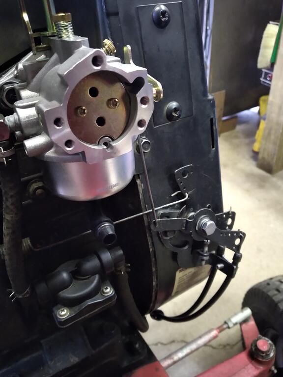

Skwerl58 843 #9 Posted June 11, 2023 In the picture of the carb there is some tape or something on the fuel fitting, make certain that the tape or ?? is not blocking fuel from entering the carb. The test with hand over it should confirm it. 1 1 Share this post Link to post Share on other sites

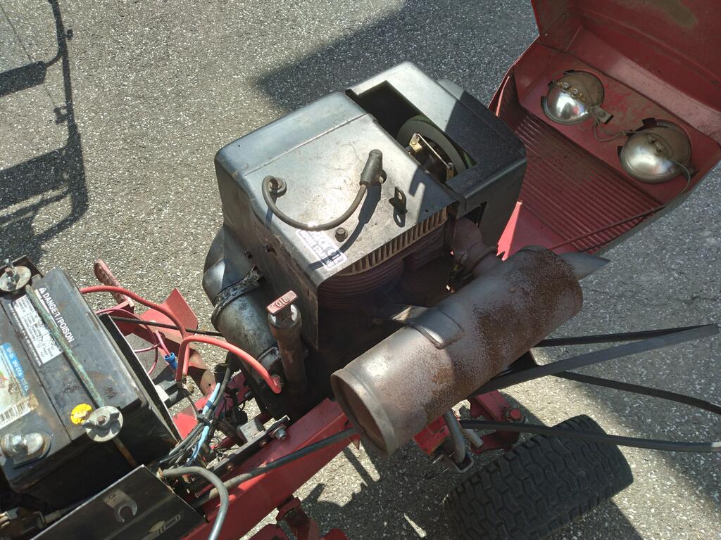

D_Mac 9,339 #11 Posted June 11, 2023 That's a small piece of Teflon tape at elbow. Only thing I can add is when reassembling the linkage we ran into trouble remembering how it went. With your help we got it back together. Before taking it apart we did put scratches next to the holes as you can see in photos. Throttle and choke work as they should. Gov arm not sure as to how you can tell but it is in the hole we marked. 1 Share this post Link to post Share on other sites

Wheel-N-It 2,978 #19 Posted June 12, 2023 (edited) 13 hours ago, Ed Kennell said: Is the governor / throttle linkage correct? I'm just now getting to read this thread. On my way scrolling down though everyone's post i was thinking to myself there could be a problem with the governor, then I landed here on what were Ed's thoughts. Go ahead and set the governor and try to start it. Make sure the governor spring has not fallen off. EDIT: I see I'm a little late to the party, but did you set the governor arm itself? Edited June 12, 2023 by Wheel-N-It 2 Share this post Link to post Share on other sites
D_Mac 9,339 #20 Posted June 12, 2023 Governor is put back to where it was. You can see in the photo we scratched the hole where the spring was on the linkage before we took it apart. 1 Share this post Link to post Share on other sites
Wheel-N-It 2,978 #21 Posted June 12, 2023 (edited) 8 minutes ago, D_Mac said: Governor is put back to where it was. You can see in the photo we scratched the hole where the spring was on the linkage before we took it apart. OK got it. So when you say high speed, do you mean wide open throttle (3,600 rpm) or do you mean way beyond 3600 rpm like it's not being governed down at all? I remember years ago we had someone on here with a similar problem and he had to go back and reset the governor arm that comes off the engine. Edited June 12, 2023 by Wheel-N-It 1 Share this post Link to post Share on other sites

squonk 48,325 #24 Posted June 12, 2023 Remember: The engine ran full speed because the throttle plate fell 😞 off the old carb. I don't think the governor has anything to do with it not starting. 1 1 Share this post Link to post Share on other sites
D_Mac 9,339 #25 Posted June 12, 2023 I agree with @squonk. It was running wide open because of the plate falling off. Like I said we took head off to check for damage thinking maybe that little screw got sucked into the engine. When removing head all the linkage had to come off. Replaced head gasket. Put linkage and new carb on with fuel filter, changed oil, checked compression, checked spark. No start. Replaced carb again no start. Replaced carb again with carb from isavetractors, drained gas, cleaned fuel tank screen. New gas. Pulled fuel line at carb verified it is pumping gas. Still no start. Share this post Link to post Share on other sites
