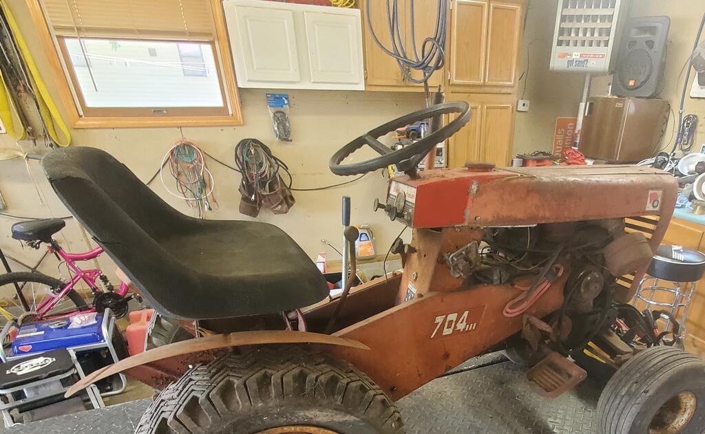

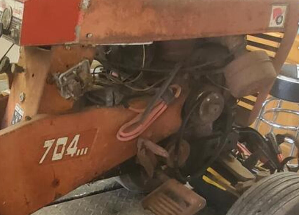

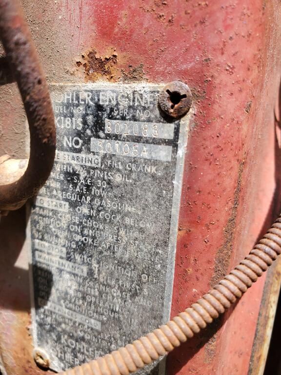

Bodean 35 #1 Posted June 5, 2023 Tractor says 704 on it but it has a k181s motor and a two piece fuel tank its leading me to believe its a 854 any help would be appreciated this is my 1st one 1 Share this post Link to post Share on other sites

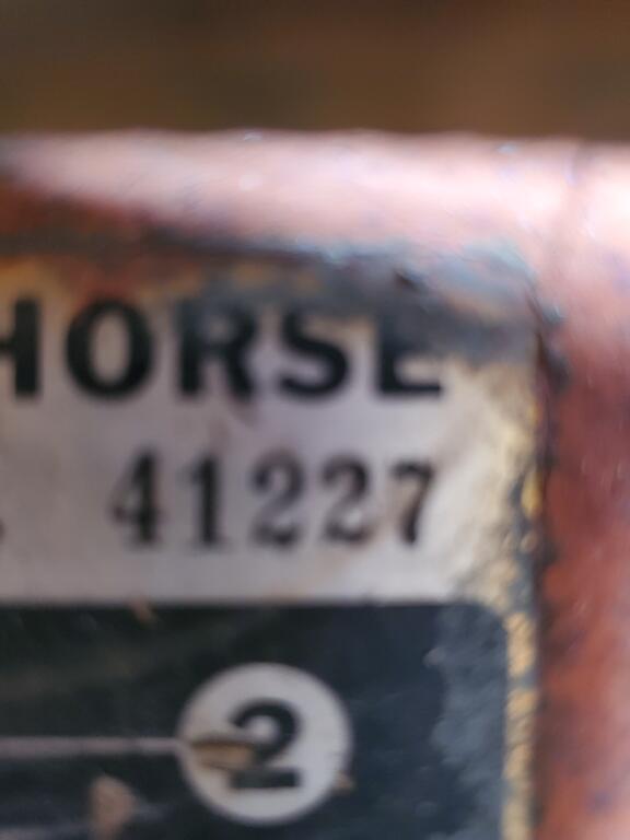

Sparky-(Admin) 26,898 #2 Posted June 6, 2023 Post up the serial number on the decal I circled in blue… I won’t be able to decipher it but someone here will. 3 Share this post Link to post Share on other sites
WHX?? 58,388 #4 Posted June 6, 2023 (edited) Bodean My guess is a 753 with a transplant and wrong belt guard!? Really all academic... a nice survivor but yes as Sparkeye says...good eye Mike. Edited June 6, 2023 by WHX?? Share this post Link to post Share on other sites
Pullstart 71,570 #5 Posted June 6, 2023 (edited) Round hoods rock! It looks like the PO was an electrician? Edited June 6, 2023 by Pullstart 3 2 1 Share this post Link to post Share on other sites
Sparky-(Admin) 26,898 #6 Posted June 6, 2023 6 hours ago, Pullstart said: It looks like the PO was an electrician? Umm…more like a rookie apprentice that wasn’t supervised well 3 Share this post Link to post Share on other sites

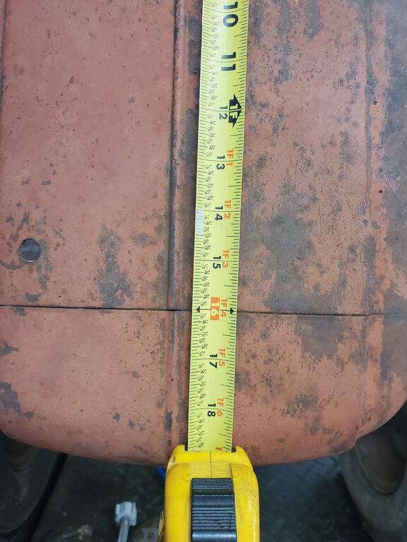

ri702bill 13,399 #8 Posted June 6, 2023 It is either a 1963 or 64, not a 62. I'm leaning towards it being an 854, not a 753. There are some differences - the 753 used a K161S engine with the short air cleaner. - the 854 used the K181S engine with the taller air cleaner. The hood on a 854 is one inch longer when measured from the cutout near the gas cap to the joint at the grille - to let the larger air cleaner fit. Which air cleaner do you have?? BOTH have a rather tight fit with their respective hoods - a 753 hood does not work with a tall air cleaner...... There is a NON-original knob for a switch? next to the height stop adjuster - what is it?? Share this post Link to post Share on other sites
Bodean 35 #9 Posted June 6, 2023 1 hour ago, ri702bill said: It is either a 1963 or 64, not a 62. I'm leaning towards it being an 854, not a 753. There are some differences - the 753 used a K161S engine with the short air cleaner. - the 854 used the K181S engine with the taller air cleaner. The hood on a 854 is one inch longer when measured from the cutout near the gas cap to the joint at the grille - to let the larger air cleaner fit. Which air cleaner do you have?? BOTH have a rather tight fit with their respective hoods - a 753 hood does not work with a tall air cleaner...... There is a NON-original knob for a switch? next to the height stop adjuster - what is it?? I believe that was for a single head light there is a hole in the hood 11 hours ago, Sparky said: Post up the serial number on the decal I circled in blue… I won’t be able to decipher it but someone here will. 1 Share this post Link to post Share on other sites

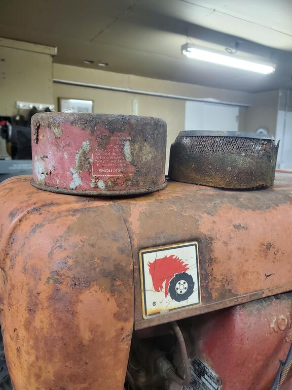

Bodean 35 #11 Posted June 6, 2023 I posted pic of air cleaner and serial number hope this helps figure out what i have . 1 Share this post Link to post Share on other sites
WHX?? 58,388 #12 Posted June 6, 2023 (edited) 854 gets my nod now. Serial number puts it right alongside other 854s and the tall air cleaner Bill mentioned. A good candidate for a mechanical resto and a nice patina. Edited June 6, 2023 by WHX?? 1 Share this post Link to post Share on other sites

ri702bill 13,399 #14 Posted June 6, 2023 (edited) The leading number "4" is the model year - 1964. The tall air cleaner is the correct 8 HP one. Hood lengths - I measured a 7HP hood and a crappy 854 hood I have - the shorter 7 Hp measures 15-1/8", and the 854 hood measures 16-1/8" from the tank cutout to the joint for the grille. The 854 is, to my knowledge a ONE YEAR hood. You have an excellent worker of a tractor - IF the 3 speed is a problem - DO consider upgrading to a later 6 or 8 speed - relatively straight forward to do - the 6 speed is a bit easier. Both @Pullstart and @Handy Don have done the 6 speed swap, I did the 8 speed from a 1979 C81. Having the low range is a big asset... You can always go back to the 3 speed later if you want. Edited June 6, 2023 by ri702bill 1 Share this post Link to post Share on other sites
ri702bill 13,399 #15 Posted June 6, 2023 1 hour ago, Bodean said: I posted pic of air cleaner and serial number hope this helps figure out what i have . Just MIGHT be time for a new air filter and foam??? 1 4 Share this post Link to post Share on other sites

Bodean 35 #18 Posted June 6, 2023 1 hour ago, ri702bill said: The leading number "4" is the model year - 1964. The tall air cleaner is the correct 8 HP one. Hood lengths - I measured a 7HP hood and a crappy 854 hood I have - the shorter 7 Hp measures 15-1/8", and the 854 hood measures 16-1/8" from the tank cutout to the joint for the grille. The 854 is, to my knowledge a ONE YEAR hood. You have an excellent worker of a tractor - IF the 3 speed is a problem - DO consider upgrading to a later 6 or 8 speed - relatively straight forward to do - the 6 speed is a bit easier. Both @Pullstart and @Handy Don have done the 6 speed swap, I did the 8 speed from a 1979 C81. Having the low range is a big asset... You can always go back to the 3 speed later if you want. It measures 16 and a fuz i believe i truly have a 854 1964 thanks for all your help ill look into the trans swap out 2 1 Share this post Link to post Share on other sites

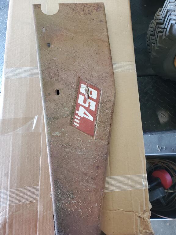

Bodean 35 #19 Posted June 6, 2023 Believe it is the 854 by the hood measure at 16.1 just so happen to find this at the local bone yard this morning 1 2 1 Share this post Link to post Share on other sites

ri702bill 13,399 #21 Posted June 6, 2023 Yup - an 854 hood!! 1 Share this post Link to post Share on other sites
WHX?? 58,388 #22 Posted June 6, 2023 2 hours ago, Bodean said: Believe it is the 854 by the hood measure at 16.1 just so happen to find this at the local bone yard this morning Wow what a stroke of luck ...with matching patina! Go get a lotto ticket! 2 Share this post Link to post Share on other sites
