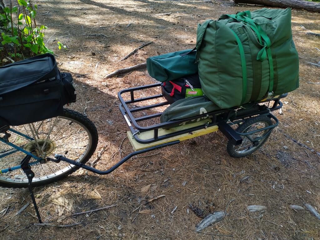

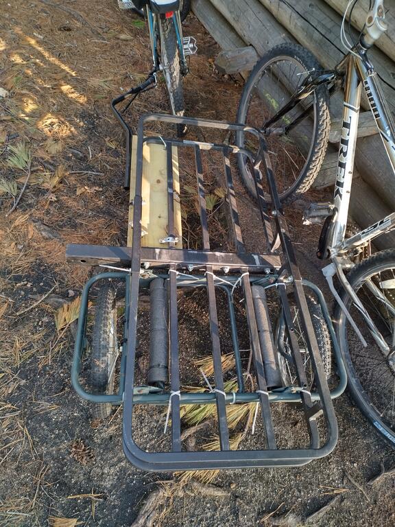

ebinmaine 78,382 #1 Posted May 29, 2023 For several years now Trina and I along with her mom and our best friend have gone to a southern NH State Park that has a beautiful remote camping site. The site is about 6/10 of a mile from the parking area. We intend to keep going there as an annual event and we're looking for a way to make the transition from car full to site full a little easier. We've used a pull cart. We've created a pull cart from a canoe and a two wheeled hauler given to us by @JCM Both worked pretty well. This year we used the @JCM wheelset cart and combined it with a rooftop/trailer hitch we had on hand. Trina bought the front hitch part of a bike trailer and off we went with nuts bolts and screws in hand..... I towed several hundred pounds of camping gear over roots rocks etc for a total of 6+ miles. Overall. Excellent. We discovered after all the work was done that the forward hitch pull bar needs to be substantially stronger. 12 3 Share this post Link to post Share on other sites

Horse Newbie 7,402 #3 Posted May 30, 2023 Just wondering… how does it do when you make a right turn ?… Am I seeing a pinch point ? 2 Share this post Link to post Share on other sites
ebinmaine 78,382 #4 Posted May 30, 2023 7 hours ago, Horse Newbie said: Just wondering… how does it do when you make a right turn ?… Am I seeing a pinch point ? In theory you'd be able to pinch but because bikes lean over WAY before they turn that angle it works fine. I actually tried to bind it before we loaded so I'd know what not to do. I couldn't turn slow and sharp enough to get it. 1 Share this post Link to post Share on other sites

Lee1977 7,632 #8 Posted May 30, 2023 While you are adding a heaver hitch, add a receiver type hitch to the car-carrier.for the tongue. Then add some brackets to the bottom of the car-carrier to attach the wheel unit with 4 small hitch pins and spring clips. These came from Tractor supply. 1 Share this post Link to post Share on other sites
