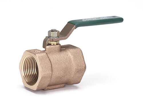

wh500special 2,454 #1 Posted May 11, 2023 I have a military customer whose preference is for compact BUTTERFLY valves like linked and pictured below for control and shutoff of potable water in a water storage system we are prototyping. Normally we use ball valves everywhere, but there are some special requirements that make butterfly valves preferable in this instance. My problem is I can't find butterfly valves that have the same approximate footprint of ball valves, are similar in cost, AND can be used for potable water. We use these occasionally and they are generally OK: https://www.milwaukeevalve.com/product/bb2-100/ They are available though the usual suspects of distribution but are not certified as lead-free for potable water use. I'd really prefer stainless steel but can live with lead-free bronze. I'm curious if anyone has any manufacturers or sources for such kit. My web search likely wasn't exhaustive, but my google skills are pretty good. I prefer North American made, but can import if necessary. These have gotta be threaded 1.5" NPT, They can't have socket or flanges. I only need 16 of them. I'd love for them to be ~$100 apiece. Any suggestions for a manufacturer would be appreciated. We buy a ton of pipe fittings and valves, but none of our suppliers offer these things or have ideas of where to source. Phone calls to our (large) plumbing distribution and fire suppression equipment networks here in St Louis have not borne fruit. There is probably some specialized industry that uses these things but I don't know what it would be but I am betting somebody on RS has an idea. Thanks, Steve 1 Share this post Link to post Share on other sites

wh500special 2,454 #4 Posted May 12, 2023 Thanks. Hadn’t seen suppluhouse but it looks like they don’t have what I need. The valves from McMaster are actually the valves I linked from Milwaukee valve. I’ve purchased a few of them as samples. They have bronze bodies and the package insert indicates they aren’t for drinking water. But thanks! Steve 1 1 Share this post Link to post Share on other sites
