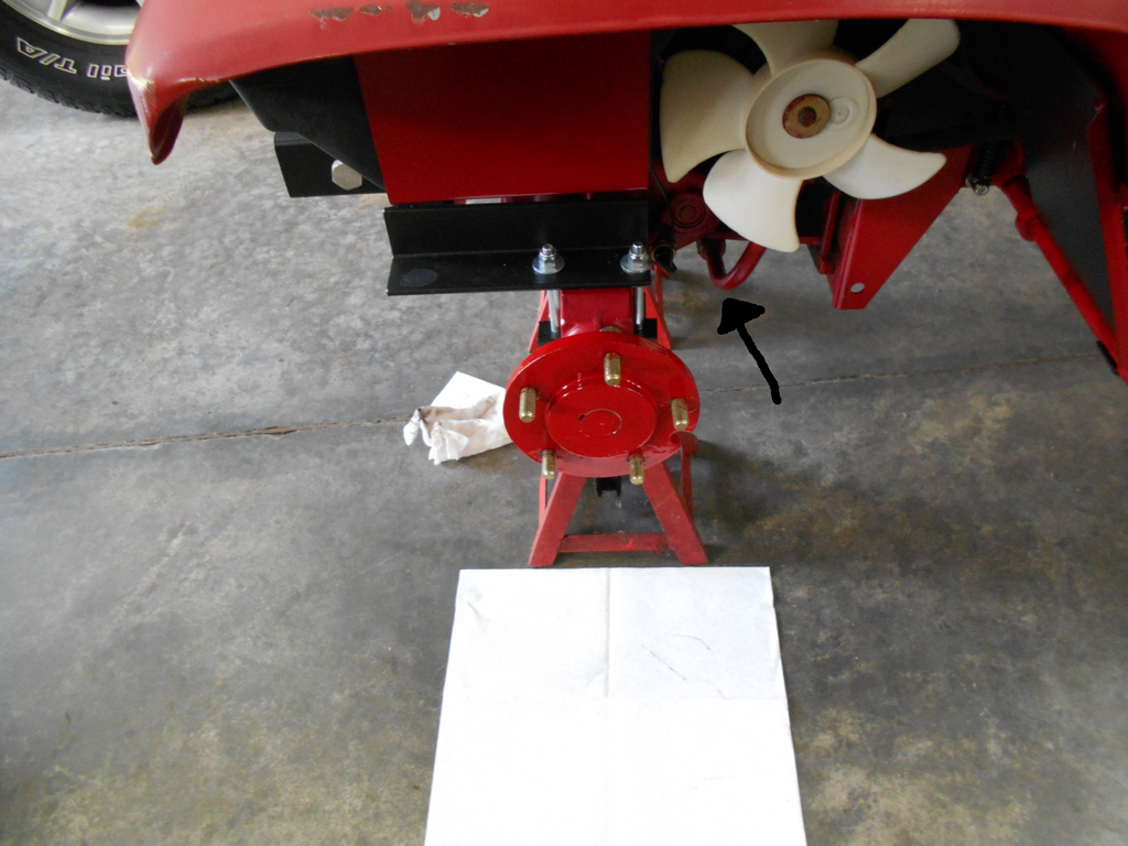

Gary S Minnesota 61 #1 Posted May 6, 2023 Yesterday I changed gear lube on the trans axles on my 312-8 and 314-8. Used 1/4” Allen socket with my 1/4” Milwaukee impact driver. Both drain plugs popped loose very nicely. Today I decided to tackle the Eaton 11 on the 520 H. Impact driver would not break the drain plug loose. After a number of attempts I borrowed my son’s larger impact driver thinking the plug might need a bit more persuasion. Big mistake!!! Now I’m dealing with a stripped Allen bolt/plug. What do you suggest? Drilling it out? Should i be fearful of leaving metal filings in the case or would the draining of the 4 quarts right through that area take any particles with it. Is it possible to use a suction tube to extract the 10-30W oil that is presently in there?? Thanks for any thoughts you may offer! Gary in Minnesota. Share this post Link to post Share on other sites

cleat 8,101 #5 Posted May 6, 2023 (edited) You can basically do the exact same thing by loosening the large oil line from the bottom Right side of the rear end that feeds up to the pump. One of mine has a stripped out drain plug and that is what I do with it. Edited May 6, 2023 by cleat 4 2 Share this post Link to post Share on other sites

Gary S Minnesota 61 #18 Posted July 15, 2023 Finally got her done and running smoothly! As mentioned in my earlier post, I ended up drilling out the old drain plug and then tapping new threads to accept a slightly larger drain plug. I followed the thread tapping with a small magnet on a telescopic rod which I repeatedly inserted into the new tapped hole until I no longer detected any metal particles or shavings. That was followed by a thorough flush with diesel fuel before finally installing a new Napa 1410 filter and 1030 oil. I like Supporter’s mention of a tight fitting Allen wrench and a good Vice Grip. I think the Allen wrench socket I initially used on the end of my impact drill was not as tight of fit as it could have been. This slightly loose fit , coupled with the hammering of the impact wrench, likely caused the Allen bolt to strip. Thanks to all of you for your comments and suggestions. I (soon to be 77 yrs young) find myself learning new tricks everyday!! And that’s great! 4 2 Share this post Link to post Share on other sites
