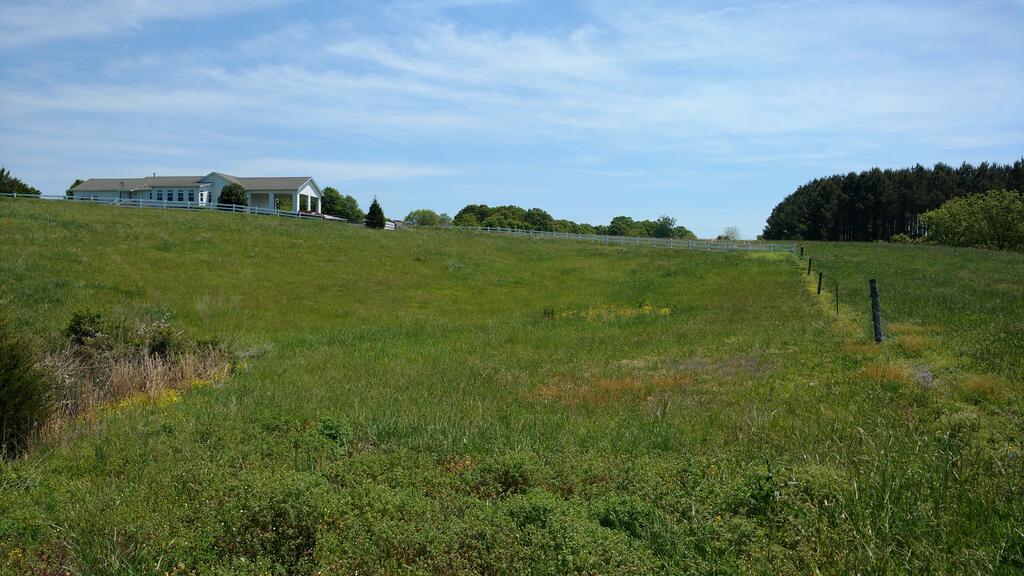

kpinnc 18,884 #1 Posted April 30, 2023 Starting with a non- Wheel Horse part, but I don't want to cut up a WH deck. It will mount on a WH when I'm finished though. About a month ago, I lost my dad. The very same day my mom went into ICU at Duke, and 24 hours later we almost lost her. She's fine now and back home, but for about 3 weeks I have done nothing but run all over the state- more than 100 miles in opposite directions from home. Needless to say I fell way behind on my groundskeeping, normally having to mow at a minimum every five days here and sometimes twice a week. We have mutant grass, and much more rain than usual this spring. So I fell behind particularly on the back pasture. The grass is thigh deep, and nothing I have will cut it. The grass just lays down and it takes about 3 passes to cut it. That's if I creep along so slow that you can't cut the pasture in a while day. And of course I don't have a bush hog... Yet. I'm gonna build a carrier up front similar to the factory deck carrier, and hang this Ford deck on it- with some modifications. I bought flat, no lift blades, and I'm gonna remove the front from the deck entirely. I'll add a raised section that will allow the high grass to hit the blades before bending over, and that should make cutting easier. It won't make a pretty cut, but I can knock it down and let it dry out before shredding it up with a regular mower. My pasture out back is a bear even when I've kept up with it. At least this way I can rake up clippings and feed my critters too, since it's fescue anyway. Eventually I'll get the electric fence up, and let them do the work. But for now I'll have something to keep the field mice and snakes away. 7 6 Share this post Link to post Share on other sites

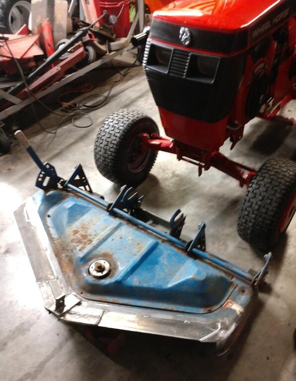

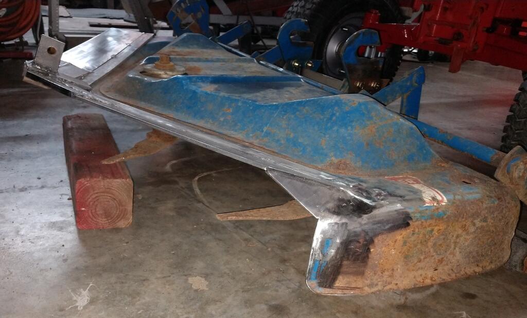

kpinnc 18,884 #13 Posted May 7, 2023 Got the front of the deck done. It's 3/16 across the front, so it'll serve as a decent bumper for light brush. With it completely open, none of the brush and high grass will get bent down before the blades make contact. This thing will be dangerous as can be. It'll only get used in the pasture, well away from home and family. Gonna build the carrier tomorrow. 8 Share this post Link to post Share on other sites

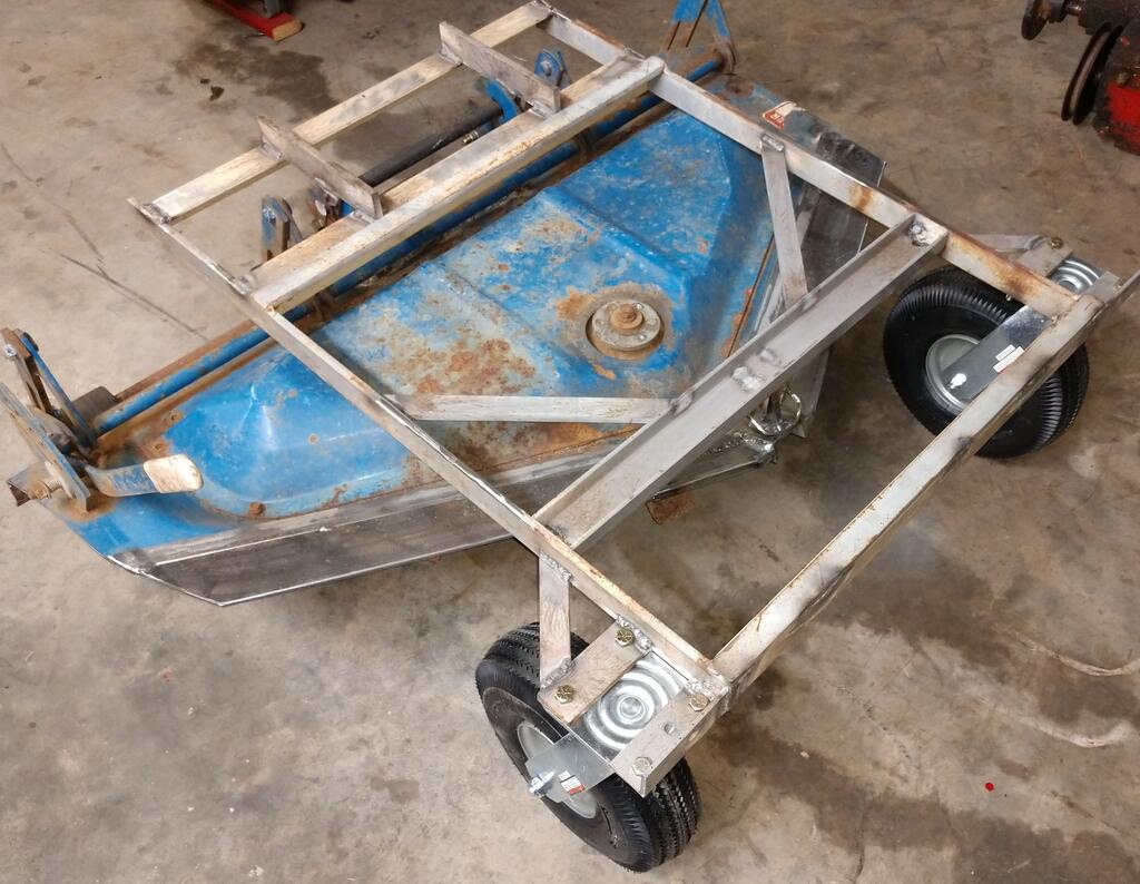

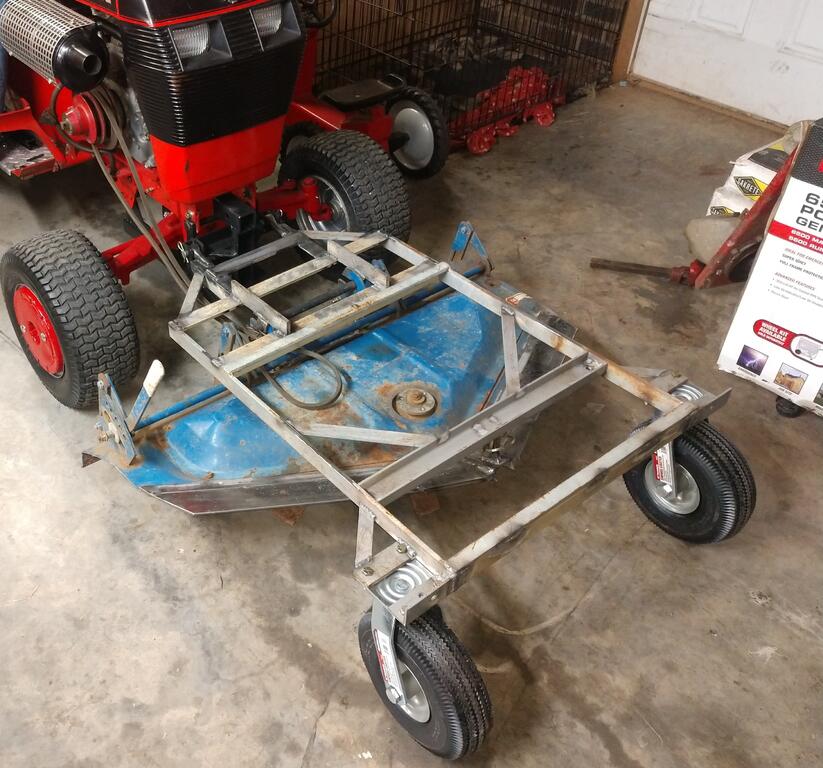

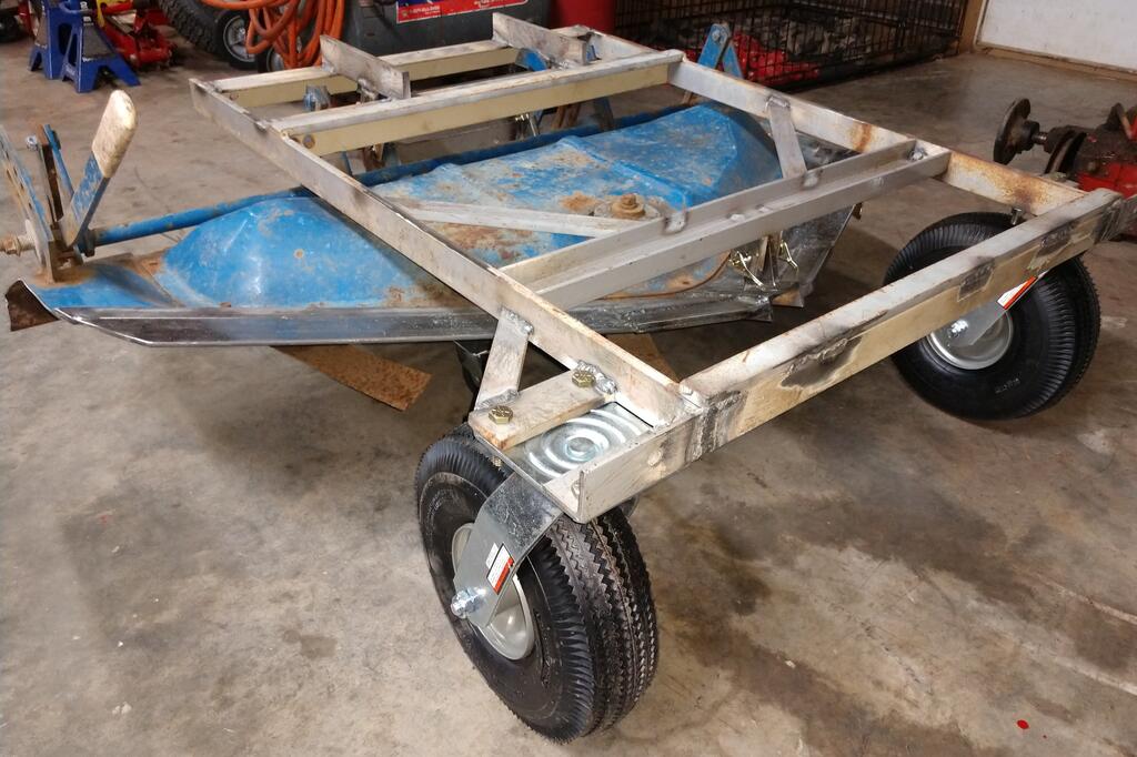

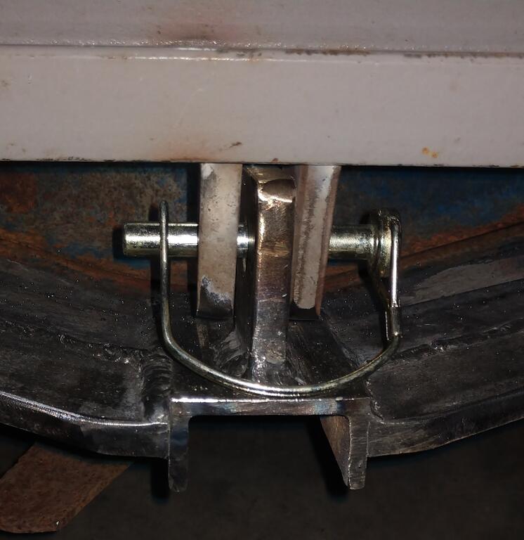

kpinnc 18,884 #16 Posted May 8, 2023 Got the carrier fabbed up, albeit kinda rough... Lots of edges to smooth up, a few welds look like goose poop. But the basic frame is done. The deck hangs at the rear on the hooks that were on it, and a single 1/2 hitch pin supports the front and holds the 3/4 bar in place in the hooks. The blades ride about 5 inches off the ground. Now I gotta fab up the hitch. Then I'll work on routing the belt. There's plenty of room to run it. 2 5 Share this post Link to post Share on other sites

OutdoorEnvy 1,817 #18 Posted May 8, 2023 Looks like it's coming a long pretty well! I can't wait to hear how it performs. I'm curious as to how well it will clear out the cut grass since the deck is a side discharge design and those have a air flow direction to help it. With the front open I'm wondering it'll still throw it well enough to not clog up and be pushed around too bad. But being 5 inches up I would think grass would be able to fall down enough. If it does seem to clog or not throw grass well you could cut off the other side plate if needed. Any chance you have Youtube and can post a vid on it running when done? If this works out well I imagine similar builds will be in order around here Lot's of brush to mow and not want to risk sacrificing a good WH deck. 1 Share this post Link to post Share on other sites
kpinnc 18,884 #19 Posted May 8, 2023 1 hour ago, OutdoorEnvy said: Any chance you have Youtube and can post a vid on it running when done? If this works out well I imagine similar builds will be in order around here Lot's of brush to mow and not want to risk sacrificing a good WH deck. I've never posted a video, but I do have an account. Guess I'll have to try it eventually... 1 Share this post Link to post Share on other sites

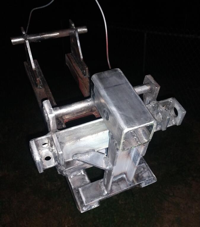

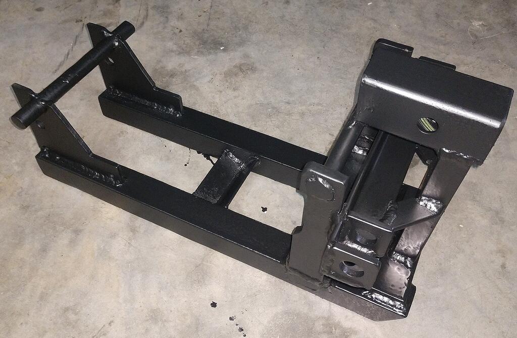

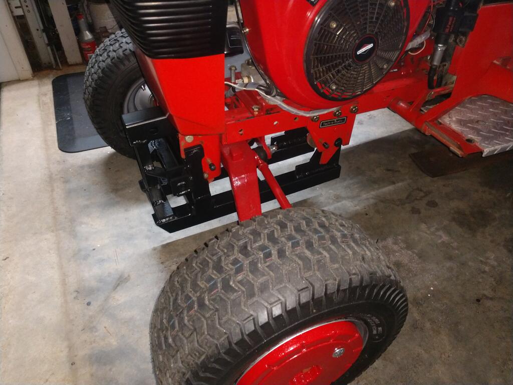

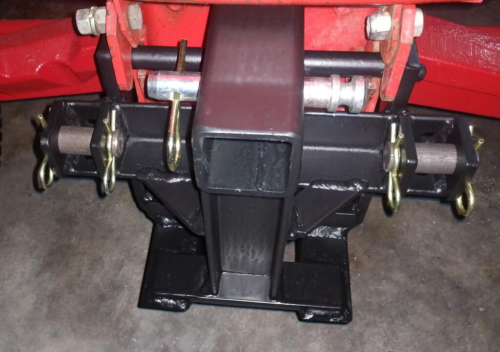

kpinnc 18,884 #22 Posted May 23, 2023 Been kinda busy lately, but I finished the "hitch" side of this build tonight. Decided to make this hitch perform two different jobs while I was at it. It will work as a front receiver for moving my trailer when not bush hoggin. I built this to use both the belly and front Tach-a-matic. That'll keep it from rocking upward if the front mower tries to jump, and it'll just be a while lot stronger this way as well. Probably have to get some better pins, but these will work for now. 2 6 Share this post Link to post Share on other sites
ebinmaine 80,275 #23 Posted May 23, 2023 Nice looking fab work there! 1 Share this post Link to post Share on other sites
kpinnc 18,884 #25 Posted May 27, 2023 Little more completed tonight. Hitched up, now I have to get the pulleys sorted out. 4 Share this post Link to post Share on other sites
