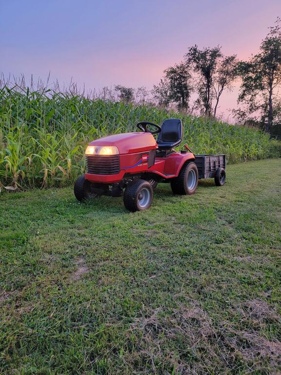

jmarek3796 2 #8 Posted April 30, 2023 19 minutes ago, Pullstart said: 1 Share this post Link to post Share on other sites
