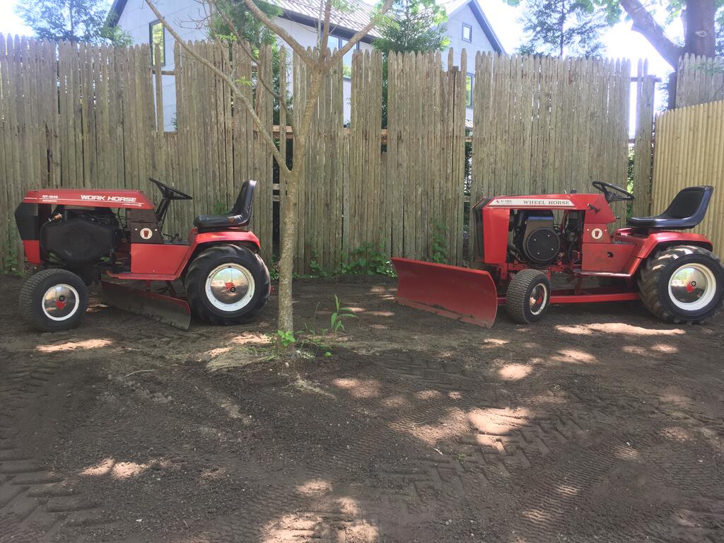

oliver2-44 11,694 #42 Posted August 5, 2023 I have a 50” WH push style blade that I have cut and leveled a lot of dirt with using my C160 auto. I do wish it had some side to side tilt, Bu when needed I have compensated by running very low air pressure on one side and a little on the high side on the other side. 2 Share this post Link to post Share on other sites
ebinmaine 80,274 #43 Posted August 5, 2023 6 hours ago, oliver2-44 said: 50” WH push style blade that I have cut and leveled a lot of dirt with using my C160 AUTO From what I understand HYDRO LIFT is a key. It gives the much needed control that a manual lift is lacking. 6 hours ago, oliver2-44 said: I do wish it had some side to side tilt Agreed. Trina uses her Mid Mount Grader Blade on a tractor with no side steps so she can step in one end. 8 hours ago, JPWH said: Sometimes its easier to fabricate than modify. Just my .02 @Handy Don I think a very careful consideration of dollar value vs time and energy value is in order for this situation. CAN you modify the blade? Well yes. Of course. But to what effort must one go in creating a Wheelhorse implement from a different brand that may be more easily built from the ground up..... What brackets must be removed? What parts can be moved or reused? How much would it cost to get a piece of the stock used to build just the center section? 1 Share this post Link to post Share on other sites

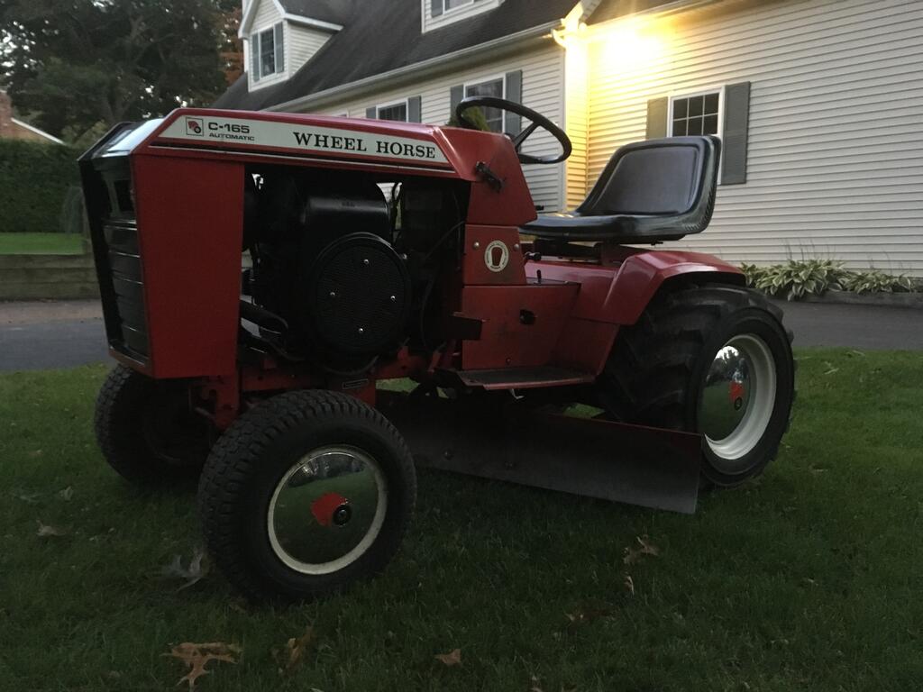

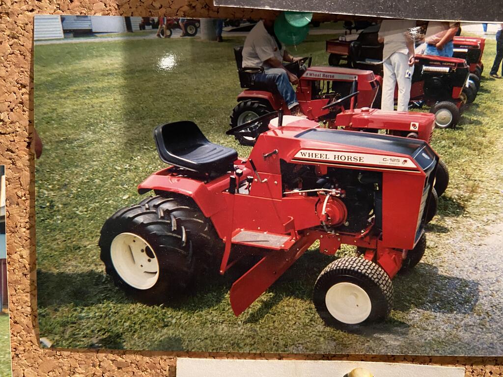

c-series don 12,362 #45 Posted August 5, 2023 When I bought my 50” mid mount blade it was really because I’m a Wheel Horse collector and I didn’t have a grader blade. I was quite impressed with how well it worked when I put it to work on my dirt road though. Also works remarkably well for fine tuning topsoil when putting in a lawn. I have said it before in other grader blade discussions that I wish it had a tilt feature. Yes you can put your foot on one side to help it dig but to me that’s a PITA . For many years I ran a motor grader for a living, many different models and manufacturers. Most of them pull type blades and one push. As far as finish grading with them I can’t really say if one has an advantage over the other? However one reason real graders use pull type is because of the advantage to offset the blade for ditching and sloping banks. Guys on YouTube get pretty crazy with what they can make graders do! Either way, any one of the blades are functional pieces of equipment and also make great display pieces!! Here’s Lucy at work with me a few years ago. RIP Mark Klingler’s C-125 grader. The White/Oliver grader that I donated to the Long Island Antique Power Association And a few other pictures! 1 4 1 Share this post Link to post Share on other sites
