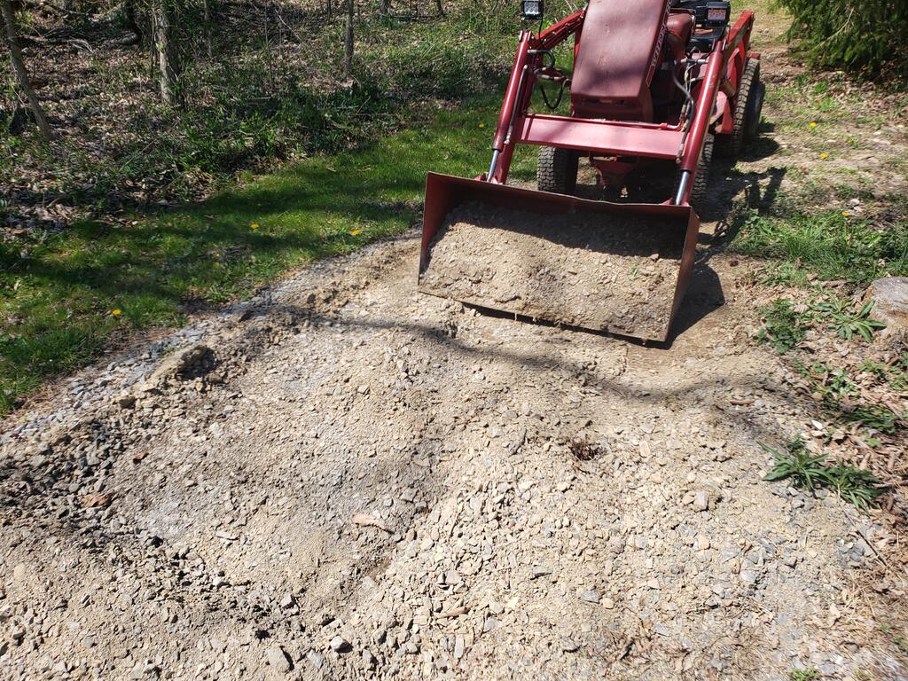

HyperPete 934 #1 Posted April 12, 2023 (edited) My '73 16 HP with an Ark500 FEL just stopped working, (the electric clutch, that is), on it's 1st day of use for me. I'm letting it cool in case there is a thermal overload. What else could be the issue? I was scraping modified 3a to use elsewhere when it went out. It's in neutral, key in proper position, switch on, brake on. Belt is not moving, but pullies turn freely. Thanks in advance! Pete Edited April 12, 2023 by Pete D photo 1 Share this post Link to post Share on other sites

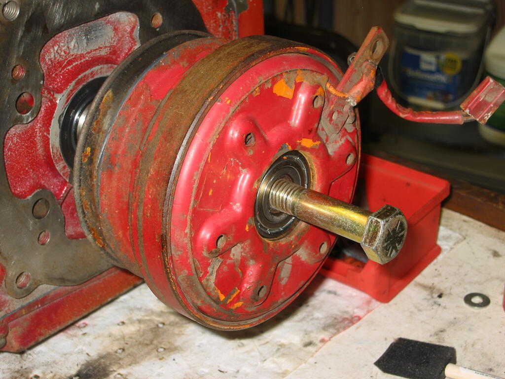

WHX?? 56,631 #2 Posted April 12, 2023 Guessing it has a plug on it connecting it to tractor. Check for 12 volts at the plug when trying to operate it. Check for any fuses & wiring supplying power to it. If that all checks out read through the windings of the clutch for continuity/resistance and report back. I don't believe they have a thermal device. 3 Share this post Link to post Share on other sites
HyperPete 934 #3 Posted April 12, 2023 Yeah, it did not work after cooling. I will check when I get home. Share this post Link to post Share on other sites
pfrederi 20,611 #4 Posted April 12, 2023 Does yu r electric PTO Look like this one (no big bolt). Just put 12v into one connector plug grou0nd the other you should her a distinct snap. and a slight movent in the clutch plates. No snap check fro continuity between the two terminal pugs. Probably a bad coil. or if you are lucky one of the wires broke free from the field coil itself and there is a chance you can reconnect it. 2 1 Share this post Link to post Share on other sites

pfrederi 20,611 #9 Posted April 12, 2023 Use your multimeter check the field coil for open or short to ground.... Share this post Link to post Share on other sites
pfrederi 20,611 #10 Posted April 12, 2023 Just tested a good one. 3.7 ohms between the coil wires. INF between each one and a ground. 1 1 Share this post Link to post Share on other sites
HyperPete 934 #11 Posted April 12, 2023 3 minutes ago, pfrederi said: Use your multimeter check the field coil for open or short to ground.... Field coil is the coil at the back of the electric clutch, I'm assuming. Yes? Share this post Link to post Share on other sites
pfrederi 20,611 #12 Posted April 12, 2023 Yes just unplug the connector and probe the plug on the coil side Share this post Link to post Share on other sites
HyperPete 934 #13 Posted April 12, 2023 Ok, I've got 3.6 between the 2 legs and open from each leg to ground. I had the dash out yesterday while I replaced the choke. Although I see nothing rubbing, I may pull the dash again to double check. It did work for about an hour before it died, however. Share this post Link to post Share on other sites

HyperPete 934 #20 Posted April 13, 2023 Yes, it was. I tried a fuse with the clutch disconnected and the key on. When I flipped the switch, the fuse blew. I cut out the damaged section, soldered, and heat shrunk the wire. I also removed the AGC (glass fuse) holder and soldered in a mini ATC fuse holder since they are what my truck and bikes use. I always have some on hand. Concerning the filth in the photo showing the switch, I intend to go through the whole tractor and clean it. I may decide to paint certain parts to prevent rust and to improve it's looks a bit, too. 3 Share this post Link to post Share on other sites
