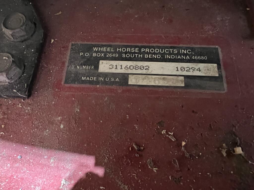

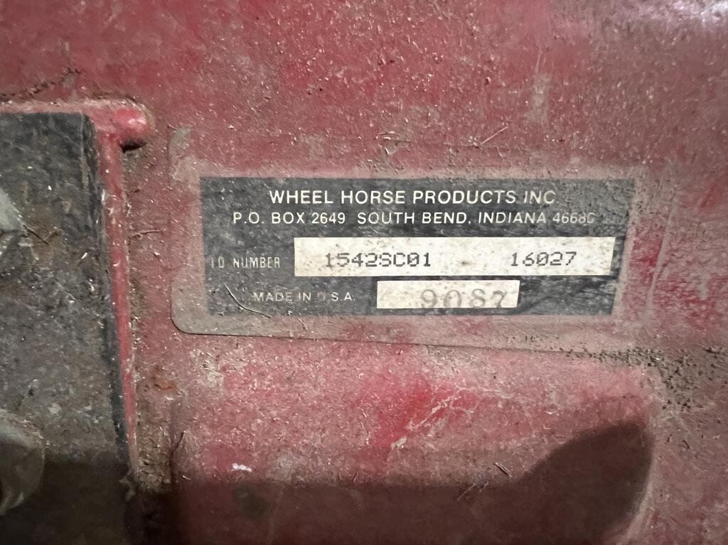

Do you have a way to verify what year this is with the ID number and serial number? Also, the ID number of the deck. I’ll upload pictures of the stickers.

Also, can anyone tell me, based on my pictures, what year the 416-8 is from?

1990

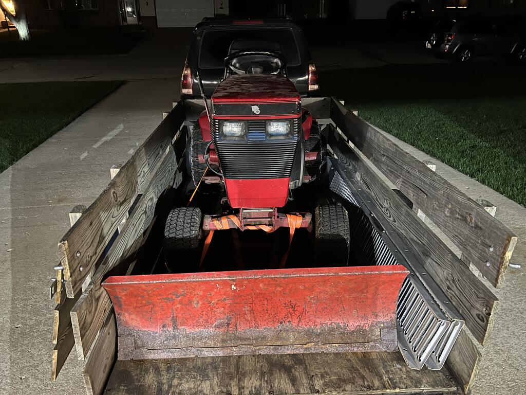

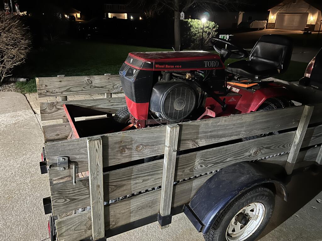

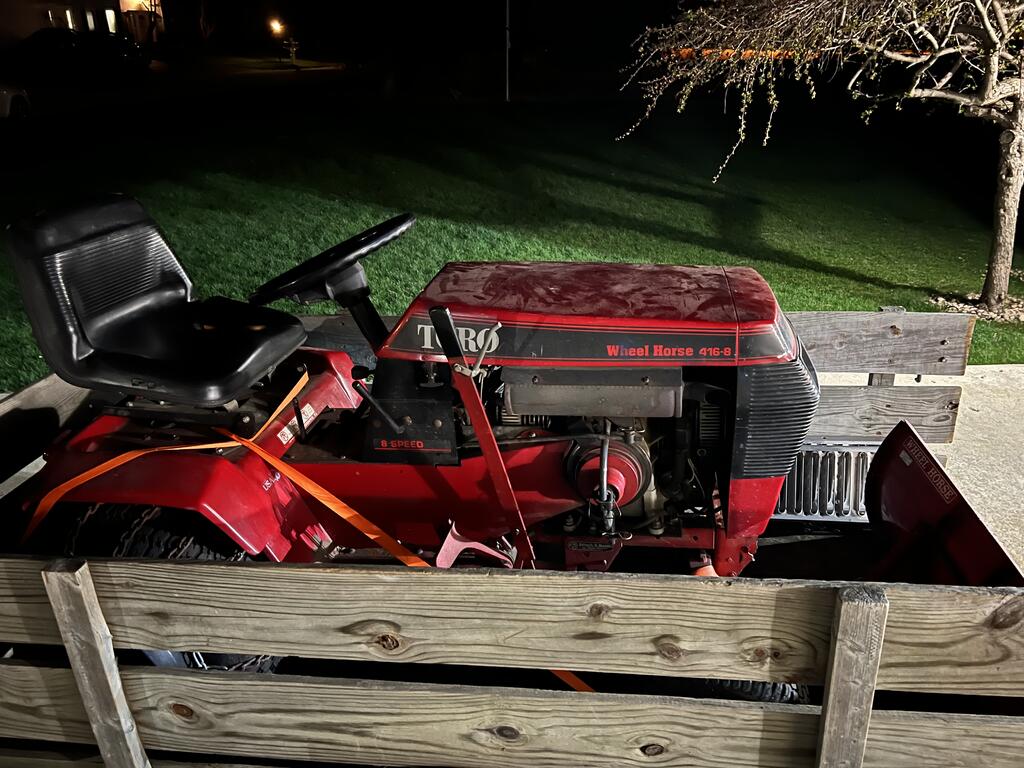

I bought the 416-8. Paid $470. The guy that had the 312-8 hurt his back so I couldn’t look at it. Thinking about buying it too…. Maybe.
Thanks for all your help. Now the fun begins: cleaning her up, buying two new inner tubes and getting the fuel system cleaned up, greasing the zirks, etc.
