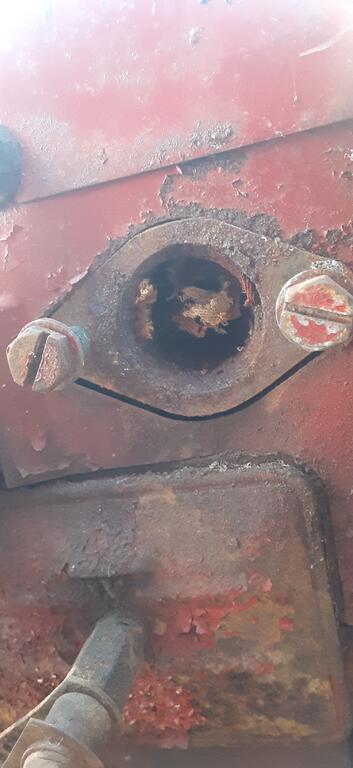

ebinmaine 81,285 #27 Posted April 11, 2023 6 minutes ago, Oldskool said: At some point I may have to get inside that transmission. What is the best way to free up the cross pin? Drill a small hole on the case seam and use penetrant? Small hole is not a bad idea. Heat. Patience. Repeat. 1 1 Share this post Link to post Share on other sites

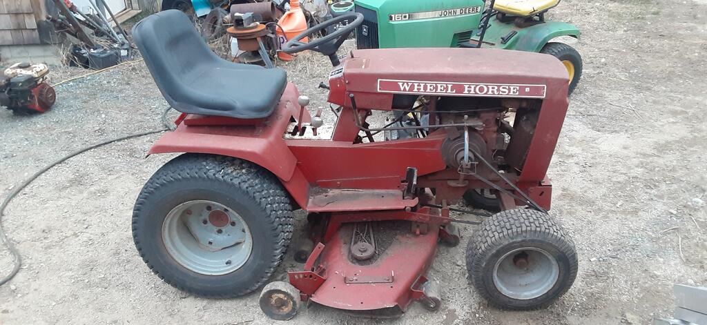

Blasterdad 3,168 #28 Posted April 11, 2023 2 minutes ago, Oldskool said: At some point I may have to get inside that transmission. What is the best way to free up the cross pin? Drill a small hole on the case seam and use penetrant? I wouldn't drill a hole in the seam, maybe on the left side in the middle as a last resort, try penatrant & working it first. Nice Brinly hitch.! Just noticed the front tires are on backwards too, something for the to do list. 3 Share this post Link to post Share on other sites
953 nut 70,663 #29 Posted April 11, 2023 54 minutes ago, Oldskool said: At some point I may have to get inside that transmission. What is the best way to free up the cross pin? Drill a small hole on the case seam and use penetrant? I would suggest several 1/8" holes with a 1/4" top portion drilled half way down to act as a reservoir for penetrating oil of your choice. 2 2 1 Share this post Link to post Share on other sites

johnnymag3 2,646 #31 Posted April 11, 2023 And you will want to correct the incorrect belt routing on the mule drive.... I love my C 160......They are beasts. John 1 1 Share this post Link to post Share on other sites

ebinmaine 81,285 #35 Posted April 11, 2023 7 hours ago, Blasterdad said: front tires are on backwards Good eye there. 2 1 Share this post Link to post Share on other sites

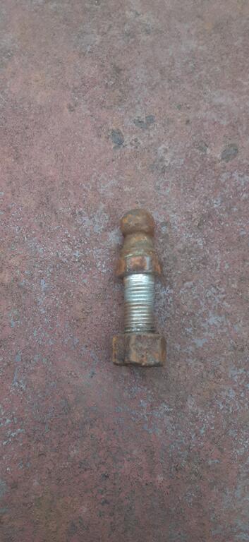

Oldskool 6,679 #37 Posted April 11, 2023 Someone left these nifty little trailer balls bolted in the front end. Must of had small trailers? 5 Share this post Link to post Share on other sites

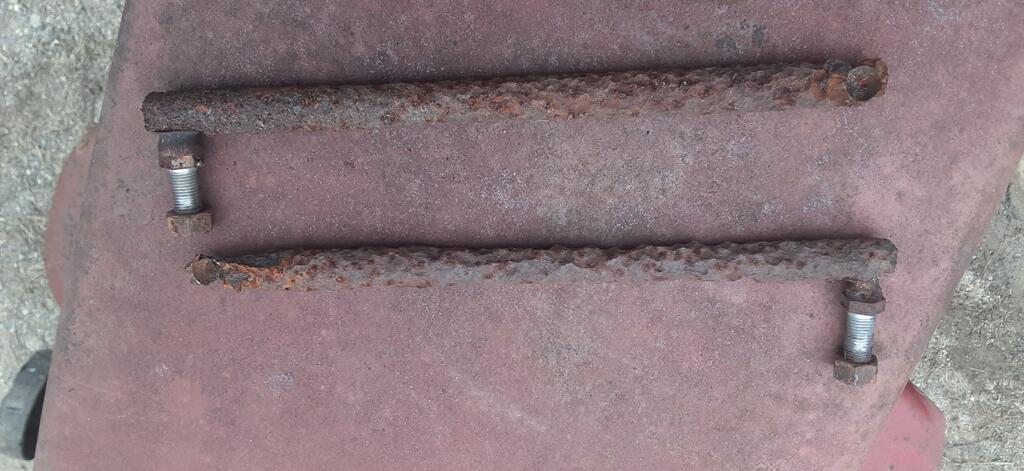

Oldskool 6,679 #38 Posted April 11, 2023 Well I think these tierods have tied their last rods. 3 2 Share this post Link to post Share on other sites

953 nut 70,663 #41 Posted April 11, 2023 2 hours ago, Oldskool said: Is the hitch pin mild or hardened steel? It is a mild steel pin. If you have a large drill press and a long enough set of drill bits you could drill the pin out. I have made it a practice to cut the pin off flush with the transmission and remove the hitch/lift parts prior to attempting to drive the pin out. I then drill a shallow 1/2" hole to hold the punch in place so you don't have to center it with each hammer blow. Lowell @wheelhorseman sells new hitch pins at a reasonable price so it isn't worth trying to save one unless it cones out easily. 1 1 1 Share this post Link to post Share on other sites

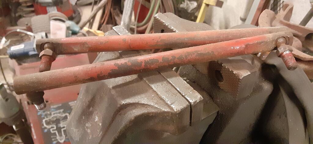

Oldskool 6,679 #47 Posted April 12, 2023 Thanks to @ebinmaine Eric I have some used tierods. Gonna tighten them up and install. At least I'll be able to steer it around. 2 Share this post Link to post Share on other sites

Pullstart 71,564 #49 Posted April 13, 2023 If it wasn’t mentioned about that pin, try grabbing it with a pipe wrench and some heat. Spinning it will break it free much easier than trying to drive it! 2 2 Share this post Link to post Share on other sites
