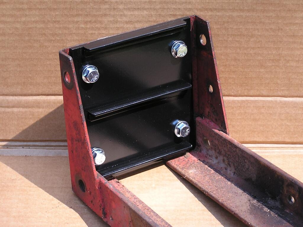

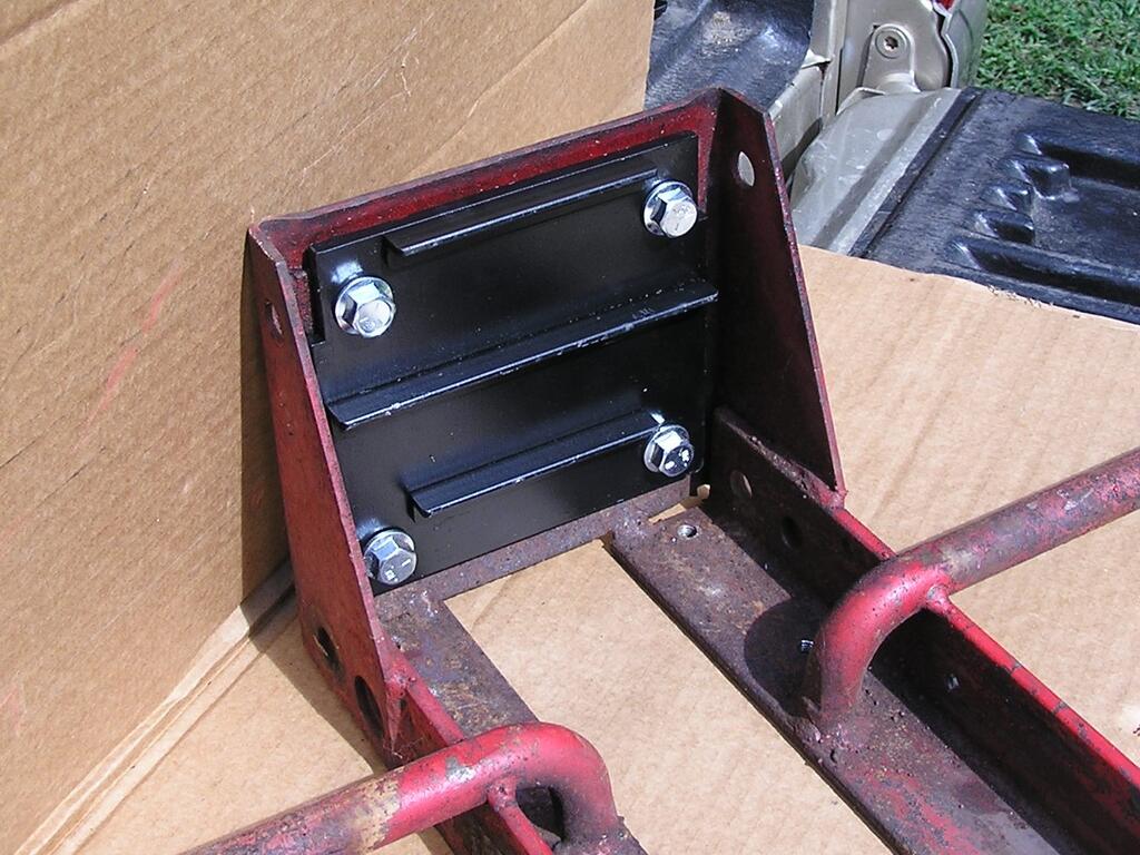

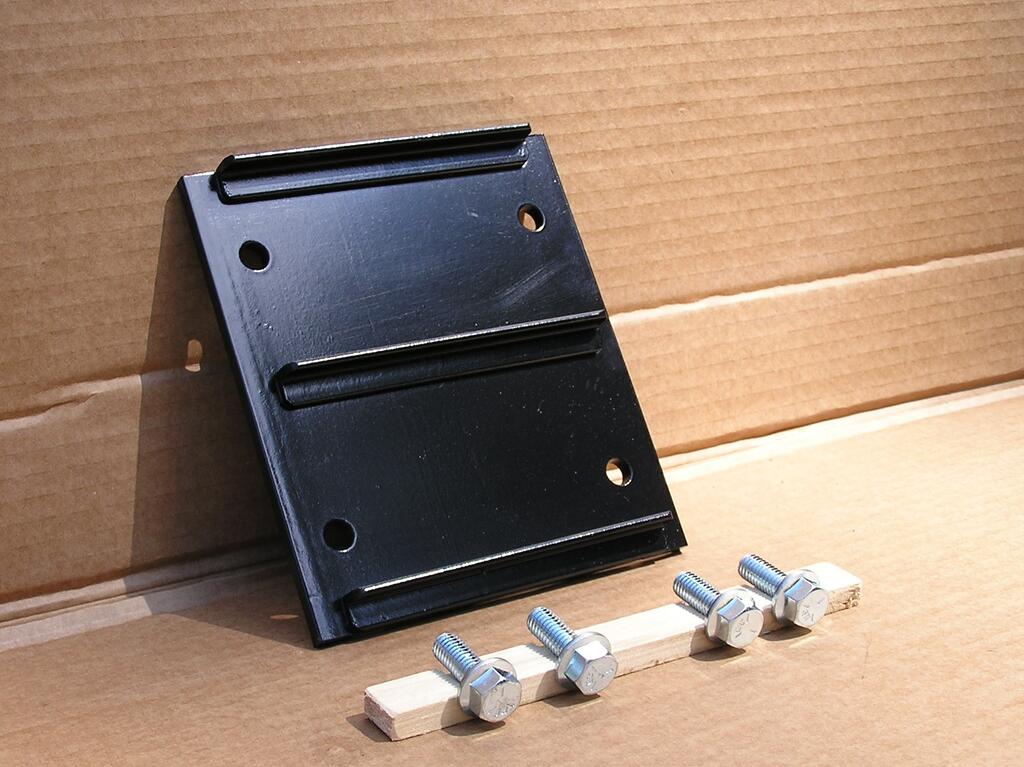

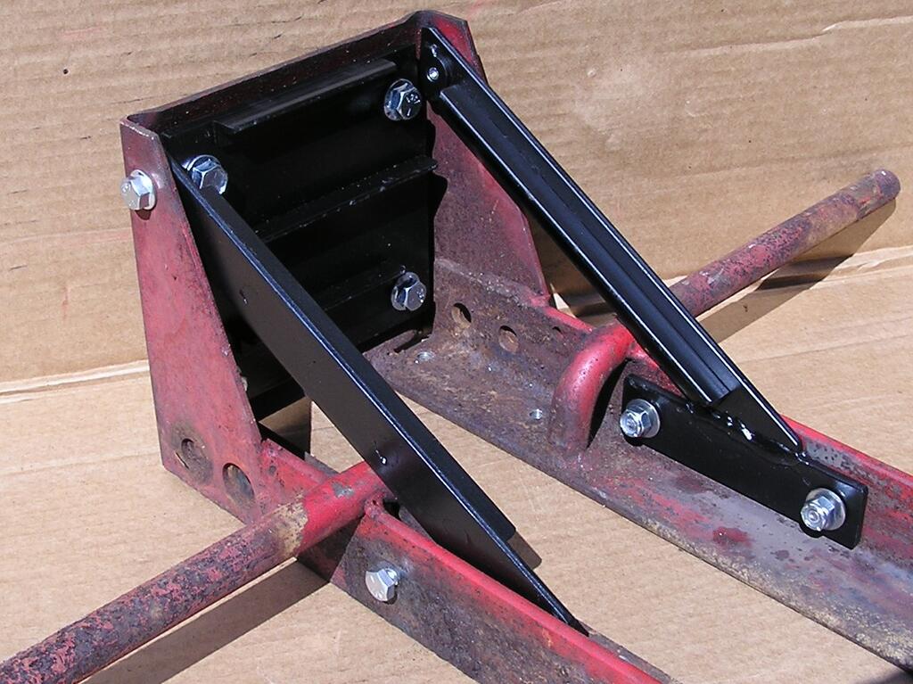

ri702bill 11,754 #3 Posted April 11, 2023 (edited) Funny you should ask, Mike..... BT,DT. One for short frames, another for long frames... Been making these FOR YEARS now... Feel free to PM me if interested..... Edited April 11, 2023 by ri702bill 1 4 1 1 Share this post Link to post Share on other sites
ebinmaine 78,185 #4 Posted April 11, 2023 34 minutes ago, ri702bill said: One for short frames, another for long frames... VERY nice work there Bill. Why the difference from short frame to long frame? 1 Share this post Link to post Share on other sites
ri702bill 11,754 #5 Posted April 11, 2023 (edited) The C series long frame has a stiffening raised ridge that runs horizontal and does not allow the plate to sit flat. Some folks use loose washers, but that is a PITA juggling act to install. I weld 2 solid flat straps that span the ridge - makes for a solid fit. And the 2 clearance cuts shown (for the optional diagonal bolt in triangular braces). Edited April 11, 2023 by ri702bill 4 1 Share this post Link to post Share on other sites
peter lena 9,846 #6 Posted April 11, 2023 @ ri702bill , looks like the bomb ! old school heft / strength , those angular braces are want should have been there , nice job , pete 1 Share this post Link to post Share on other sites
ri702bill 11,754 #7 Posted April 11, 2023 49 minutes ago, peter lena said: @ ri702bill , looks like the bomb ! old school heft / strength , those angular braces are want should have been there @peter lena Thanks. Best part is they bolt in, are removable, and can be used alone without the stiffening plate. No need really to remove them, they clear the plow, cutting deck and blower just fine. They stop the rocking flexing of the F plate. Wasn't it you that says "Fix it once, fix it right, and move on to the next issue? .... 1 1 Share this post Link to post Share on other sites
