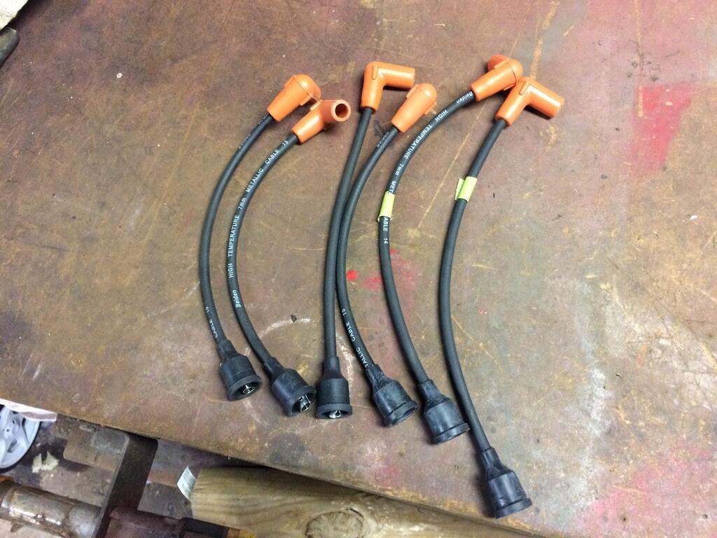

squonk 47,733 #4 Posted April 10, 2023 You can see what the wire end looks like 2nd wire from the left. 3 Share this post Link to post Share on other sites

squonk 47,733 #13 Posted June 2, 2023 (edited) 51 minutes ago, WHX?? said: He buys begs borrows & steals the pieces from NAPA and has the handy dandy crimper @RandyLittrell. I got one from him at the BS and they are nice but me thinks Ole Sqounky bent me... @Achto and I since buy plug wire sets at Fleet Farm. Supposed to be for a Continental Dan?? Enough wire and ends to make a few. I hit you over the head with a shovel. The " universal tractor wire sets come with the boots and terminals on one end. You cut to length and put the ends on the other. Old # was Belden 700172. Sold a bunch of them. The problem with the kit is the plug terminals and boots are straight not a 90 deg elbow. That's why I buy everything separate so they have the right end. I'll have to check out Tractor supply. Looks like they sell a kit with the right boots.. Edited June 2, 2023 by squonk 1 1 Share this post Link to post Share on other sites

Achto 32,251 #15 Posted June 2, 2023 8 minutes ago, WHX?? said: will get a pic. 21 minutes ago, squonk said: I'll have to check out Tractor supply. These are the ones that we buy, they come with a 90 degree boot on the plug end. They sell 4cyl kit and a 6cyl kit. https://www.fleetfarm.com/detail/calco-6-cylinder-wire-set/0000000026269?Ntt=tractor parts TSC has a similar kit, they are a little more proud of theirs. https://www.tractorsupply.com/tsc/product/tisco-spark-plug-wire-set-sws260 2 Share this post Link to post Share on other sites

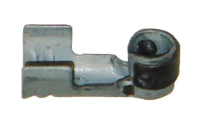

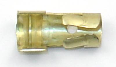

squonk 47,733 #18 Posted June 2, 2023 17 minutes ago, Achto said: Not sure if they are rubber, neoprene or silicone. I do know that the wires are neoprene with a copper core. This site has a bit more info on the Calco wire sets. https://www.theisens.com/products/universal-spark-plug-wire-set/ Do the wires say High temperature? Can't make out what it says on the wire . Also don't like the style of the coil terminals. I use these. Crimp on: Plug wire terminal: Plug boot. High heat silicone: Share this post Link to post Share on other sites
