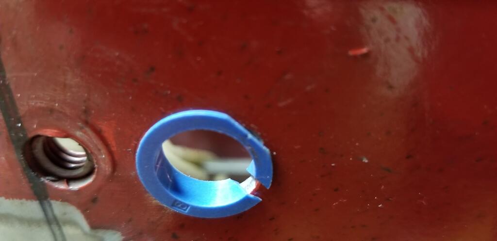

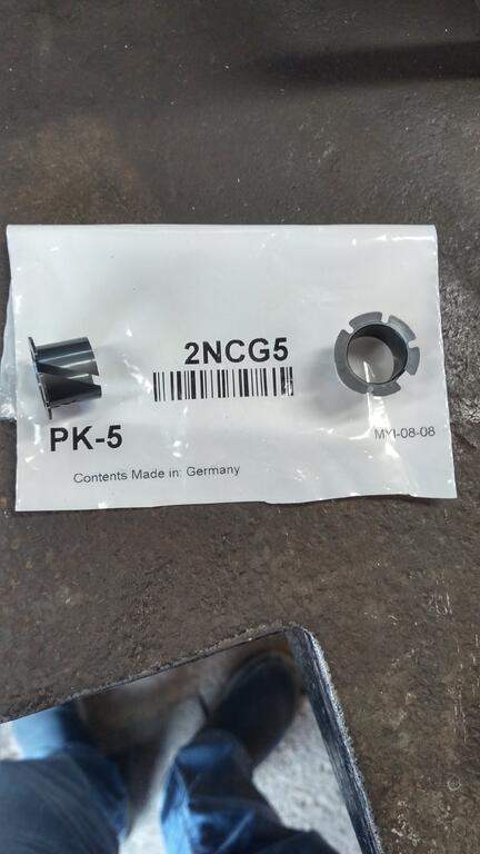

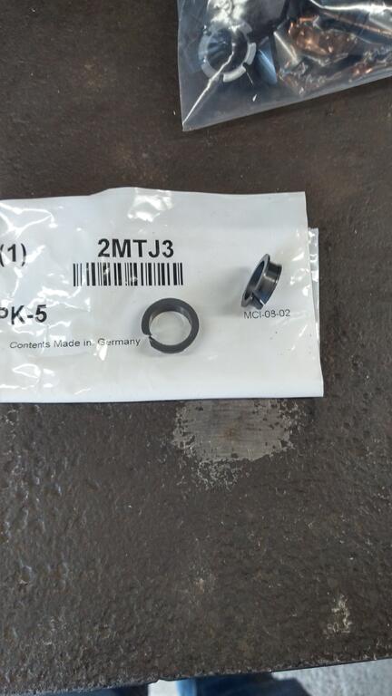

Bill D 3,214 #1 Posted April 2, 2023 Got these from Grainger. Good quality. 4 Share this post Link to post Share on other sites
Sparky-(Admin) 26,899 #2 Posted April 2, 2023 For use where? The PTO lever where it goes thru the dash tower maybe? 1 Share this post Link to post Share on other sites
grinchsr 675 #3 Posted April 2, 2023 Maybe on the motion control linkage for the column mounted ones also. Share this post Link to post Share on other sites
WHX?? 58,388 #4 Posted April 2, 2023 (edited) Flip up fender pan hinges. Steering linkages on late model verticals. 3,4, 500 hydro tunnel linkages Edited April 2, 2023 by WHX?? Share this post Link to post Share on other sites
peter lena 10,127 #5 Posted April 2, 2023 @Bill D good stuff , like a dielectric grease for a lubricant in there , made for that , pete Share this post Link to post Share on other sites
moe1965 774 #6 Posted April 2, 2023 (edited) Steering wheel collar up by the fuel tank Edited April 2, 2023 by moe1965 Spelling Share this post Link to post Share on other sites
Bill D 3,214 #7 Posted April 2, 2023 (edited) On 4/2/2023 at 8:35 AM, grinchsr said: Maybe on the motion control linkage for the column mounted ones also. They're 1/2" ID bushings. The 2NCG5's fit the PTO lever. They also fit my Toro Powermax snowblower. The 2MTJ3's fit the hydro linkages on the Eaton equipped tractors. I'm sure they fit other things as well. Sorry for the confusion. When I posted the pictures I assumed most people knew what these fit. Edited April 3, 2023 by Bill D Grammer 1 Share this post Link to post Share on other sites

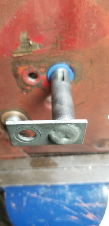

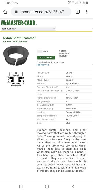

gt14rider 1,291 #10 Posted April 4, 2023 (edited) Used some from Mcmaster carr , 1/2"i.d. x 9/16" o.d. This is on motion control shaft. Edited April 4, 2023 by gt14rider 1 Share this post Link to post Share on other sites
peter lena 10,127 #11 Posted April 5, 2023 @gt14rider , never had any issues with those on my horses, found that detailing in and lubricating levers , as well as adding heim joints where ever I want to , makes for an effortless movement area , never wore out any since the upgrade . all 3 of my horses have the same improvement mod . just what I wanted , greasy pete Share this post Link to post Share on other sites
