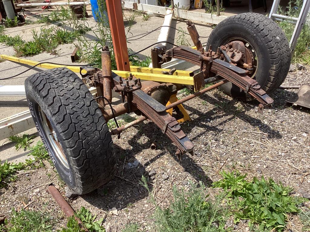

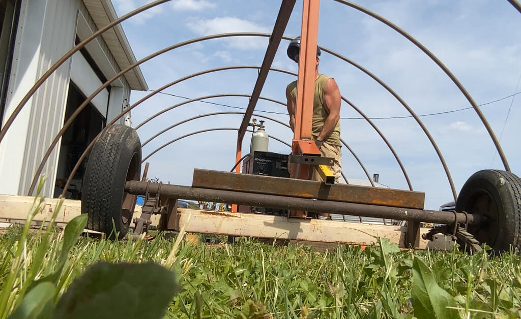

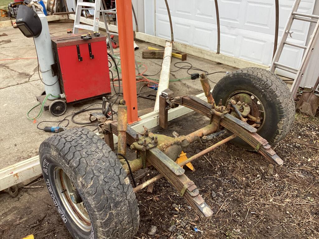

Pullstart 71,470 #31 Posted April 4, 2023 The axle is mounted. Bracing is underway. 1 Share this post Link to post Share on other sites

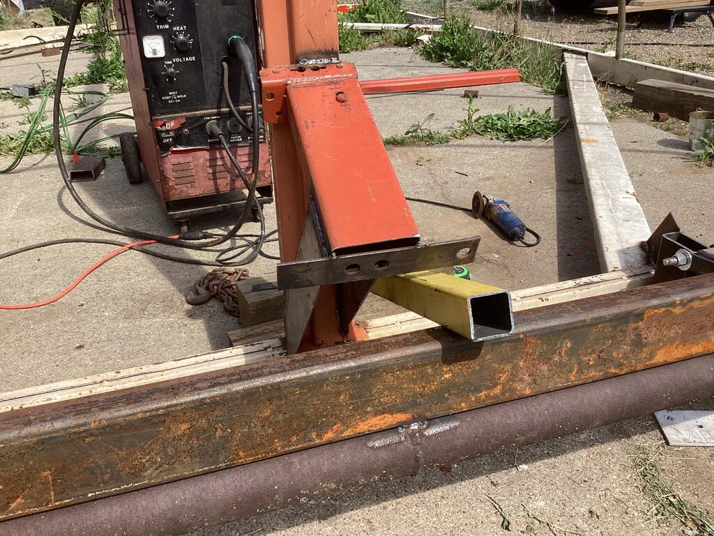

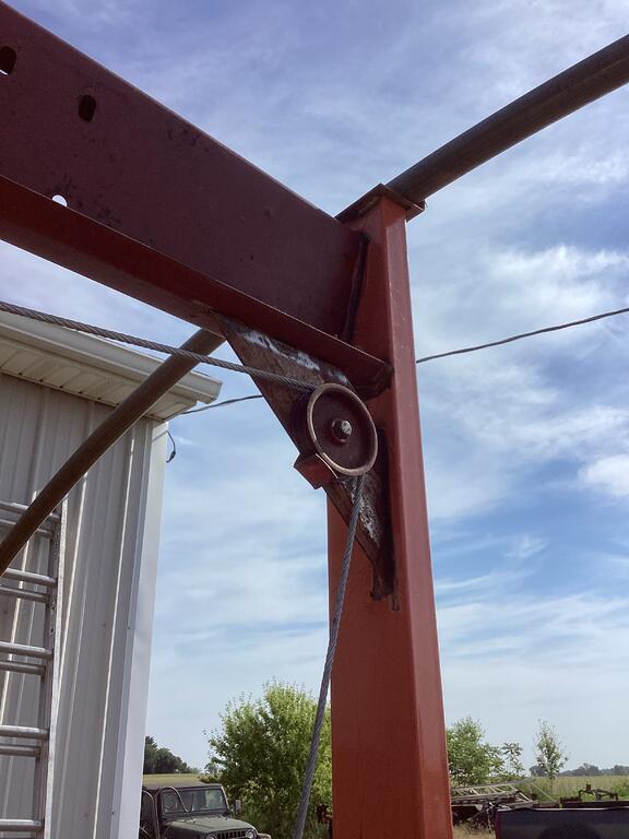

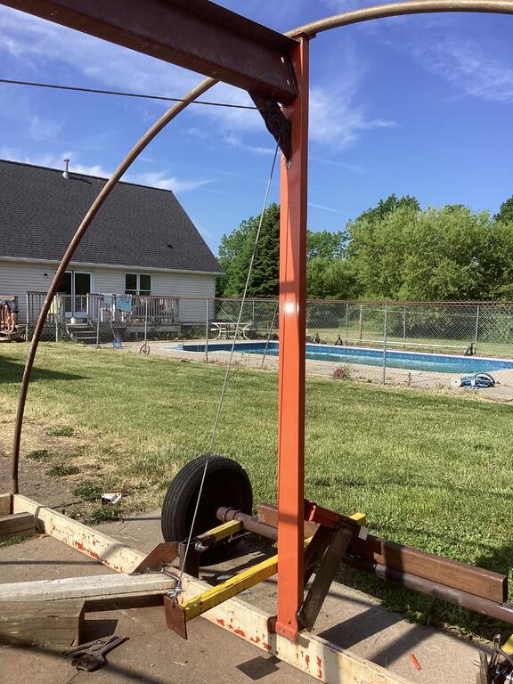

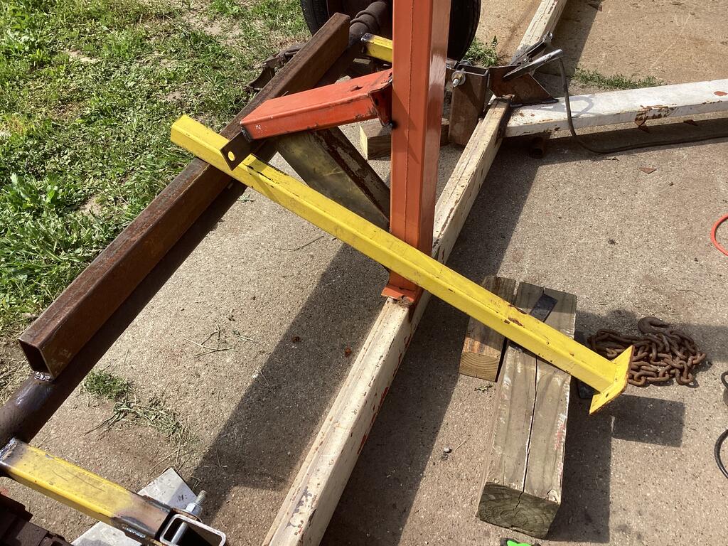

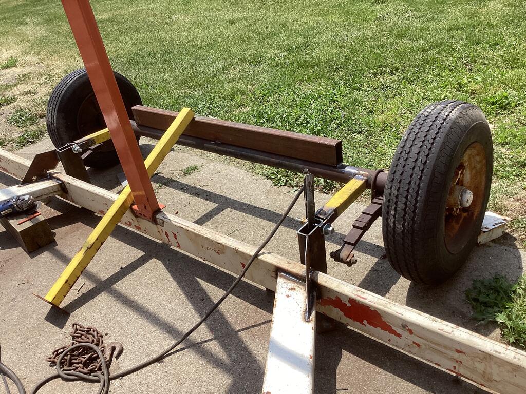

Pullstart 71,470 #39 Posted June 2, 2023 The simple lever lift works like a champ! My massive gear reduction winch will be laughing all the way to the bank lifting this rig! Now I need to duplicate it on the other end, with other dimensions. 1 1 Share this post Link to post Share on other sites

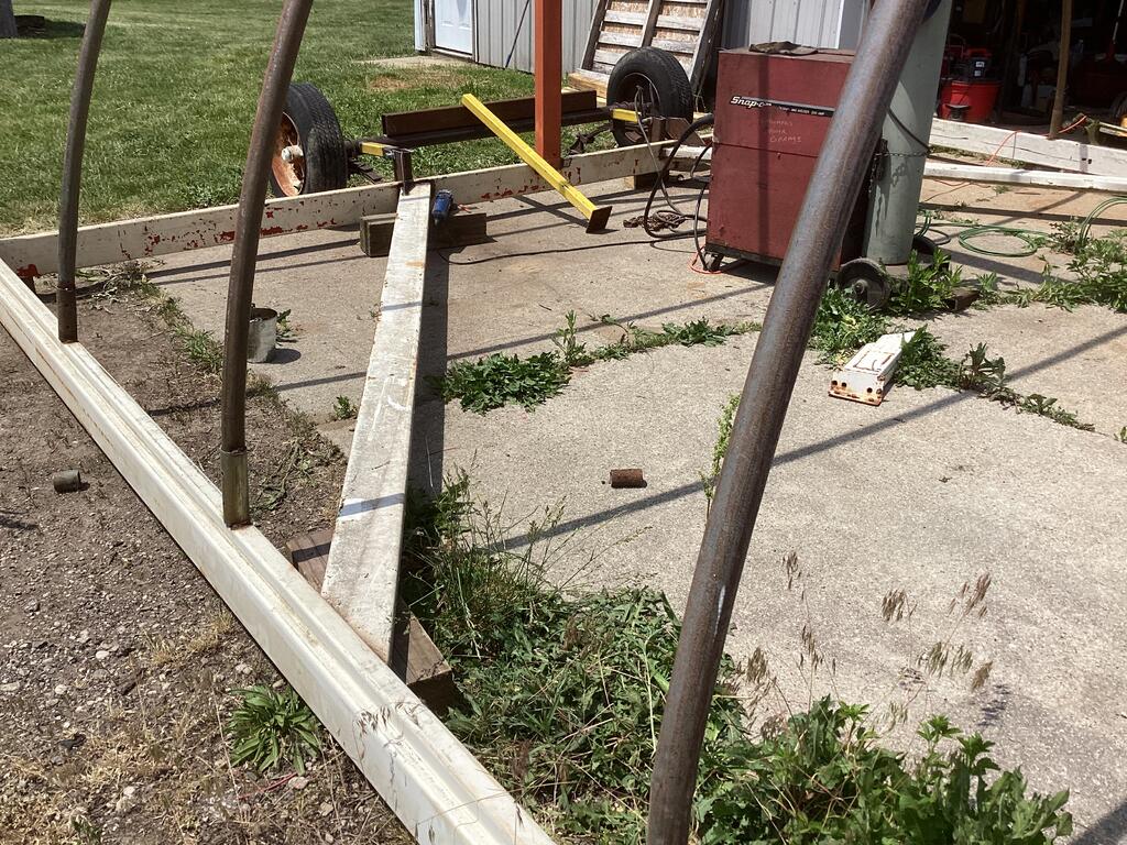

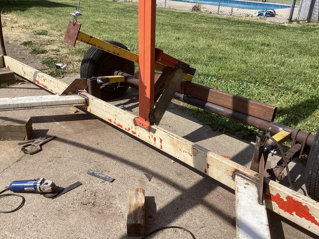

Pullstart 71,470 #40 Posted June 2, 2023 Both ends are able to lever over a 4x4. Winning! I’m hot and tired. Break time… Share this post Link to post Share on other sites

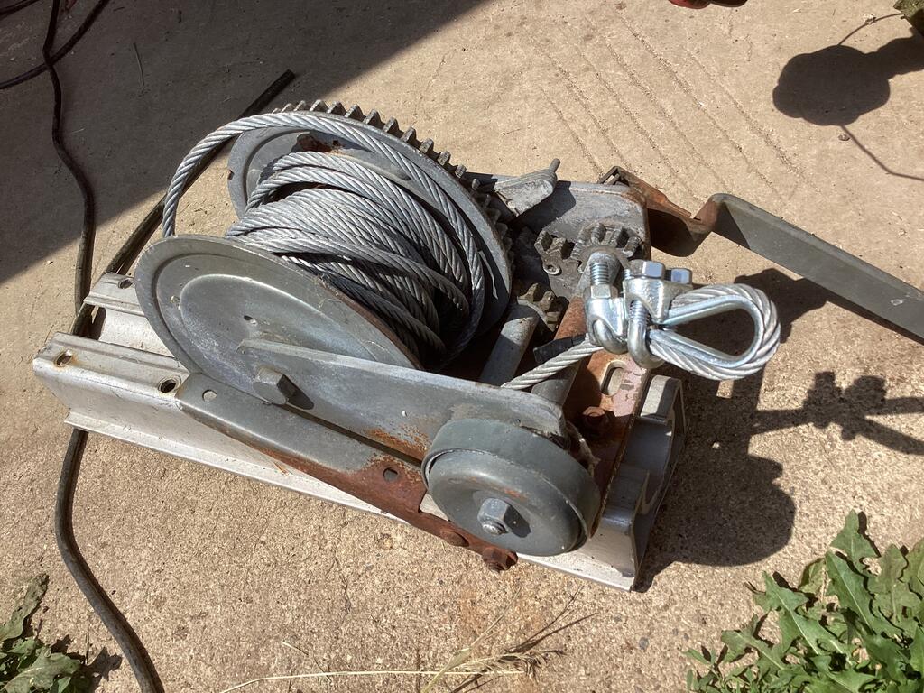

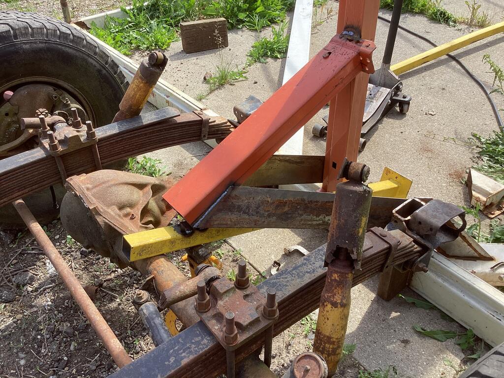

Pullstart 71,470 #41 Posted June 3, 2023 The graduation meat is off the smoker, so it’s time to start grinding and welding again. I am happy that my lift lever idea is functional on both sides. The fact that I can fairly easily lift both ends independently tells me that even adding 300 lbs of food and water potentially will still allow the winch to do it’s thing. I need to weld up a few tabs to contain the trailer axle lever, as it prefers to spit itself out after a couple reps, then find some pulleys to build the winch system. Share this post Link to post Share on other sites

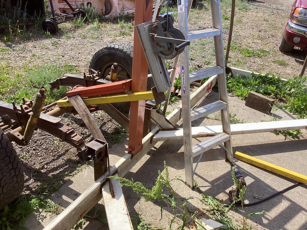

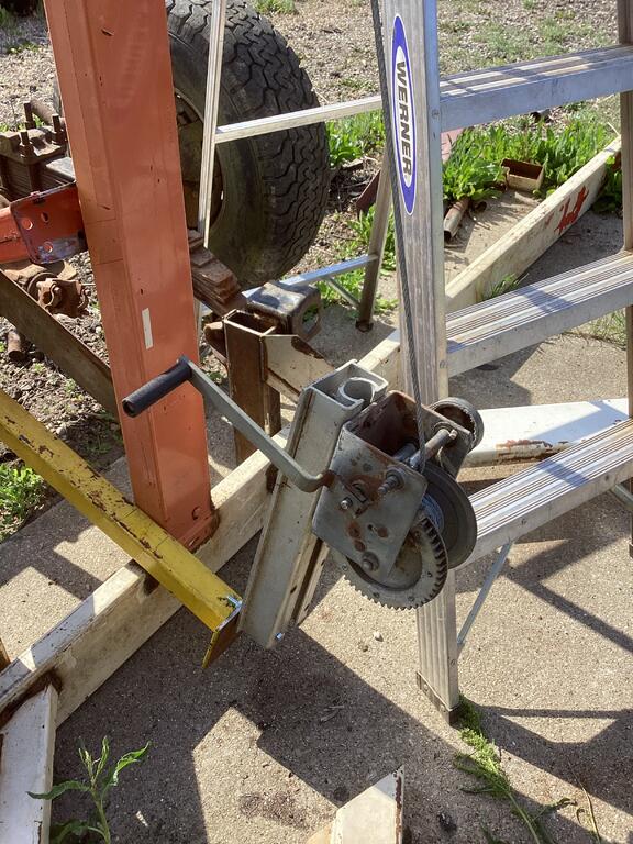

Pullstart 71,470 #42 Posted June 3, 2023 Concept: PROVEN! It lifts great! The winch has a standard reduction and a secondary reduction shaft. The secondary is not necessary. 1 1 Share this post Link to post Share on other sites

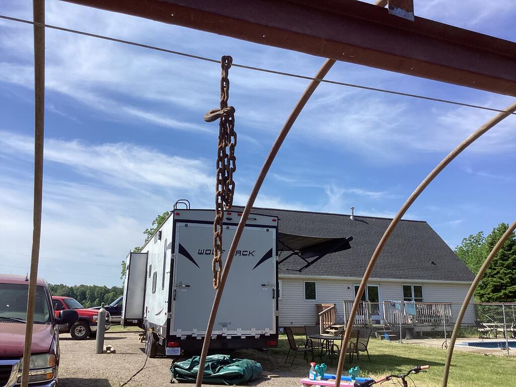

Pullstart 71,470 #44 Posted June 3, 2023 Up position… I need to mount the winch better and prevent the front lever from removing itself. The chain on the center of the cable is a pretty good tensioner to prevent the unraveling of the winch. Share this post Link to post Share on other sites

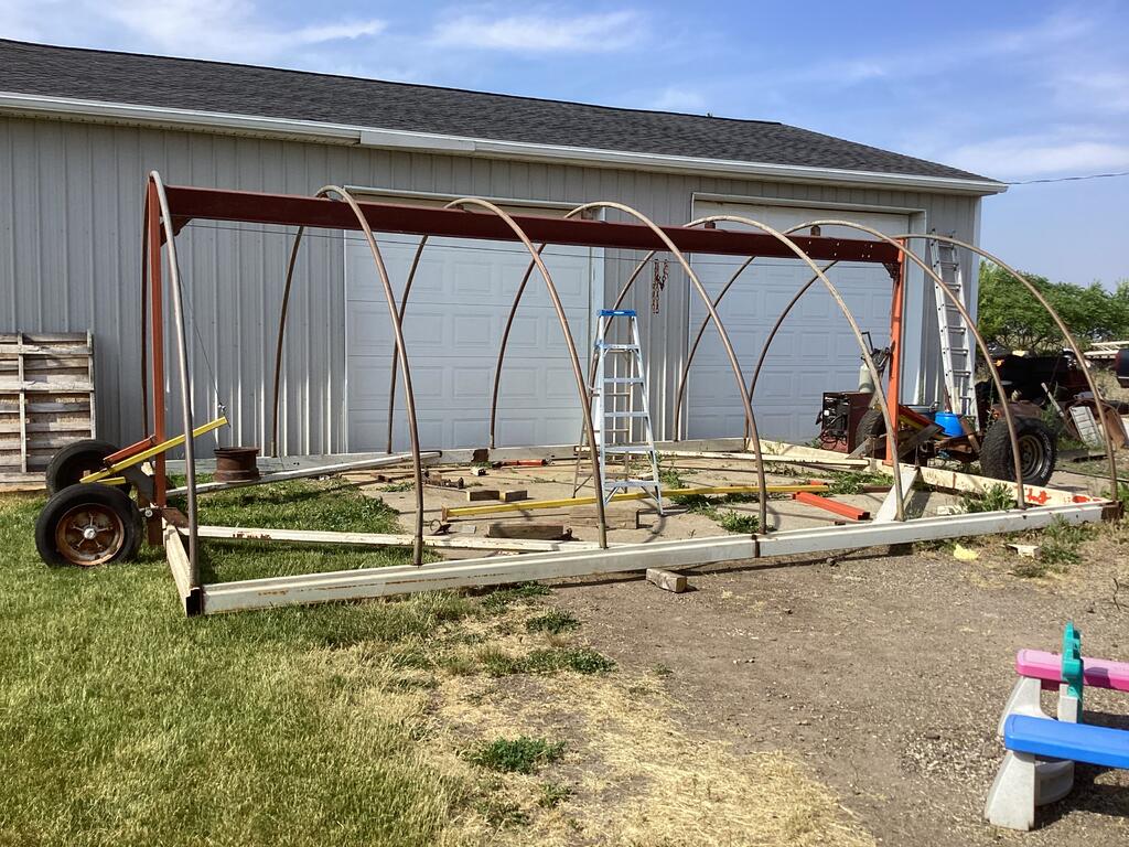

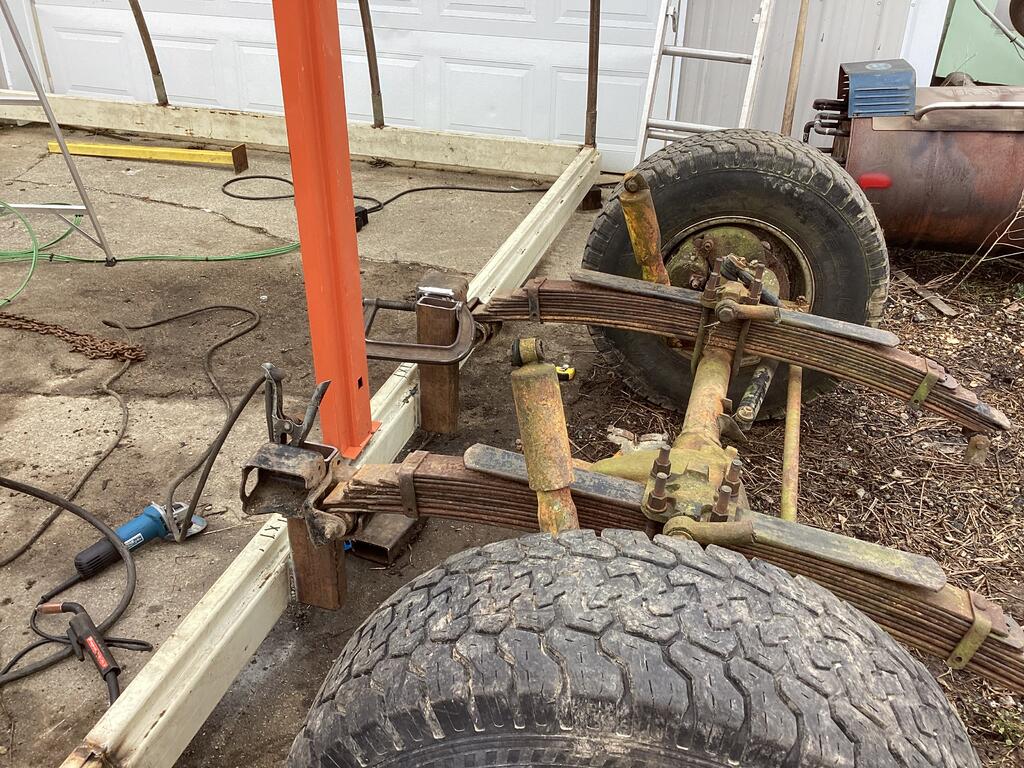

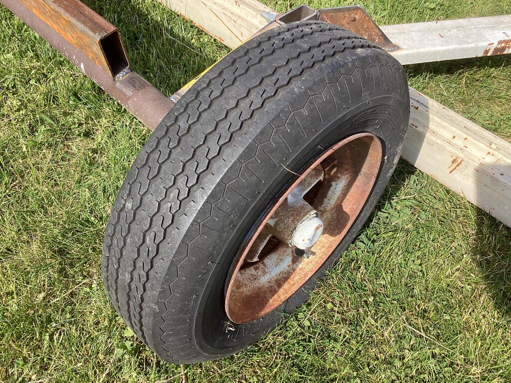

Pullstart 71,470 #45 Posted June 3, 2023 Even with a flat tire (right off the bead) I can push it well. Not easy, but well. The frame stays quite square with the 45 degree lateral braces. Now, I need to figure out my drive system. I am contemplating tossing a whole frame and 3 speed up on the front axle and running with it. I’m sure I’d excite @SylvanLakeWH by utilizing a Horse! 2 1 Share this post Link to post Share on other sites

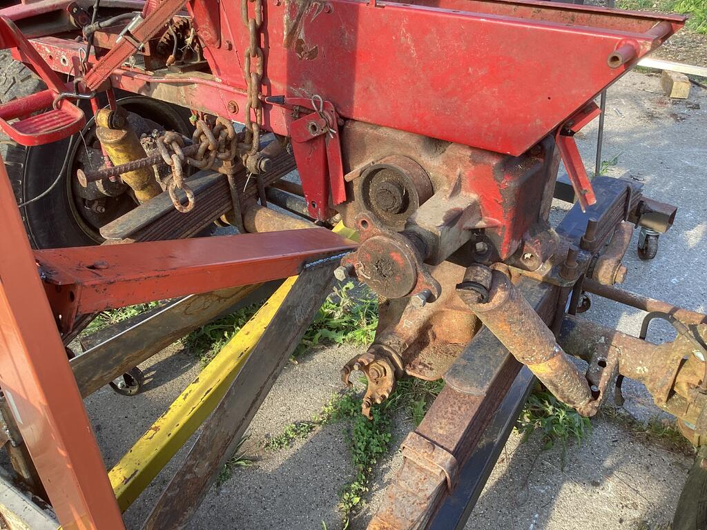

Pullstart 71,470 #46 Posted June 3, 2023 I was thinking drive it off the brake drum. No diff locking or unused spin side preventing required. I’m not sure what I’ll do, but this is my original 502 transmission and a 1055 frame from the boneyard. Simple clutch I’m used to, plus this would give me forward and reverse. My thoughts are to use the implement lift arm to steer it? 2 1 Share this post Link to post Share on other sites

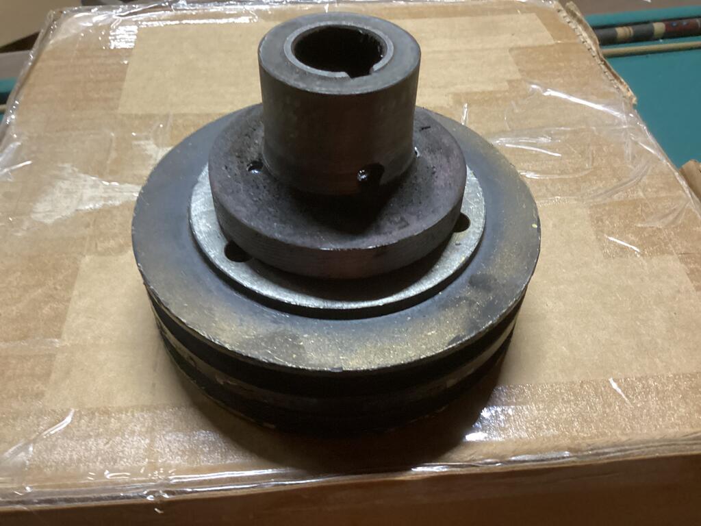

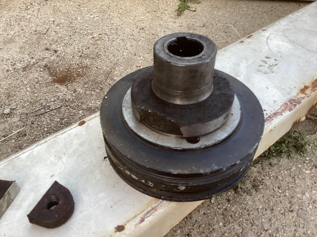

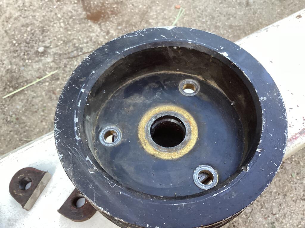

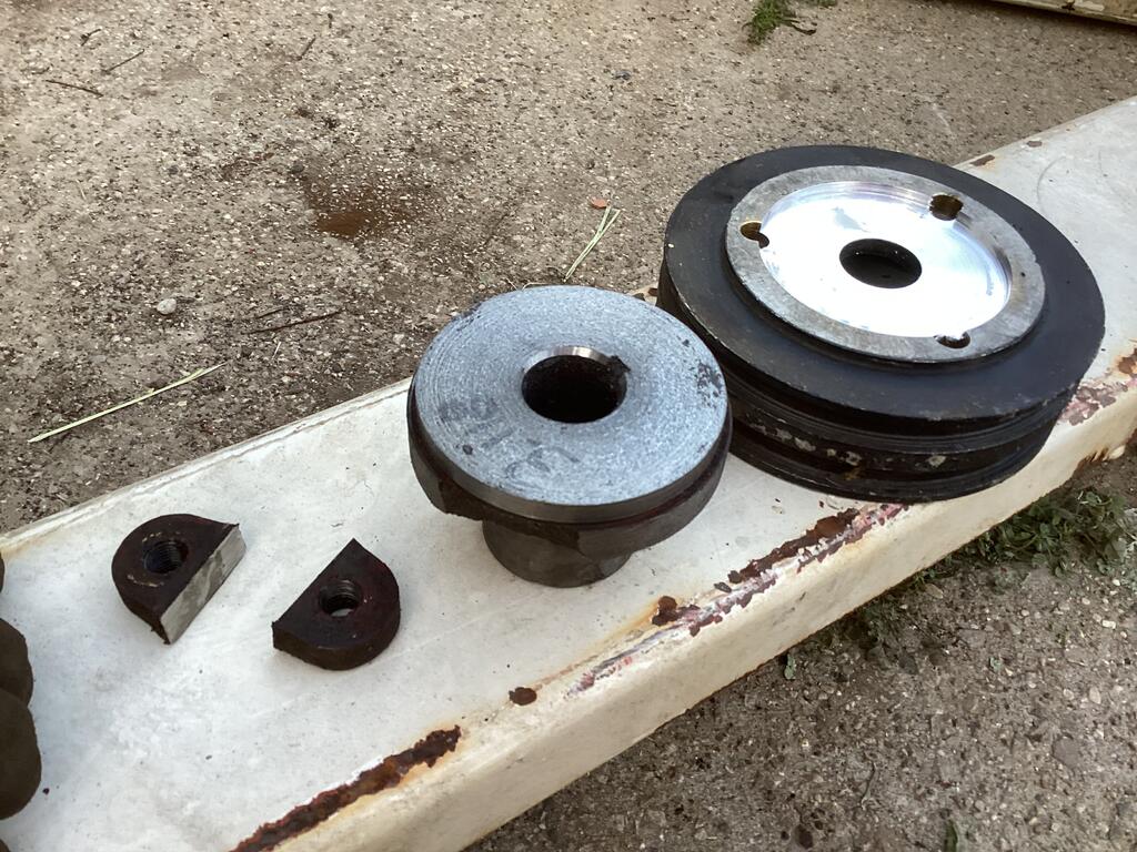

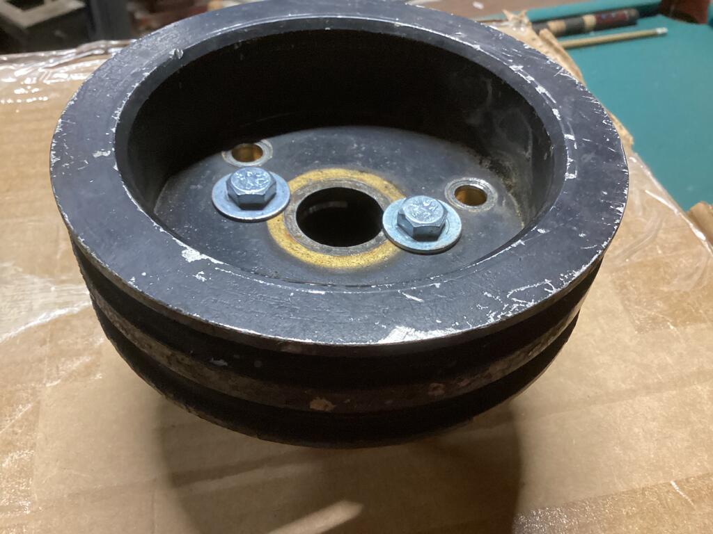

Pullstart 71,470 #47 Posted June 4, 2023 I found a hub with a broken ear. I took this accessory drive pulley off an SBC harmonic balancer and turned them to fit within .001” tolerance. I’ll drill and tap new hood down bolts. I’ve got another SBC pulley I can use to drive the truck axle pinion. Share this post Link to post Share on other sites
Pullstart 71,470 #48 Posted June 4, 2023 I’m glad I found the broken hub. It worked out like a champ! Share this post Link to post Share on other sites
davem1111 2,417 #50 Posted June 4, 2023 Hey, if you keep lifting that thing manually, it will help you stay in shape! But seriously, this is a very cool project ("cool" not having anything to do with the weather lately, for sure....). I'm curious though - what is the function of the WH frame/trans on this? When I first saw the back end of it on there, I thought you were using a frame with both the trans AND engine to power the movement. Are you going to be putting an engine on it? 1 1 Share this post Link to post Share on other sites
