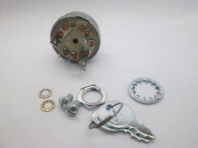

Mike'sHorseBarn 3,682 #1 Posted March 19, 2023 So the ignition switch on my electro 12 bit the big one. I see oem replacements are $100 so I think it's time to add a solenoid and use a cheaper switch. Has anyone done this before and put the solenoid somewhere it didn't look ridiculous? Pics of your conversions would be appreciated! I put a picture below of the oem switch, crazy what the price is! Share this post Link to post Share on other sites

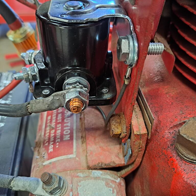

Blasterdad 3,168 #2 Posted March 19, 2023 Not a conversion but this is where they mount from the factory... Share this post Link to post Share on other sites
953 nut 69,462 #3 Posted March 19, 2023 I bought a Charger that had been converted to a new style switch and solenoid and it was mounter to one of the flywheel cover 1/4-20 bolts and a sheet metal screw as @Blasterdad has shown. It worked great and the cables were very short. 2 Share this post Link to post Share on other sites

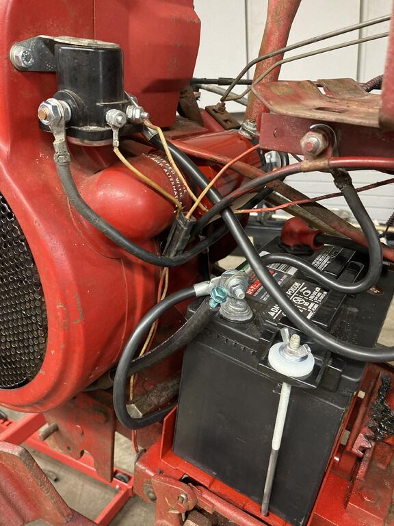

ri702bill 13,083 #5 Posted March 19, 2023 While going thru my 854 8 speed build, I added a solenoid to the starting circuit. I fabbed up a plate to mount it to the far end of the starter / generator. The solenoid is a low amperage primary device to control a secondary large amperage circuit - doing so takes the high amp load off the keyswitch...... Bill 1 Share this post Link to post Share on other sites

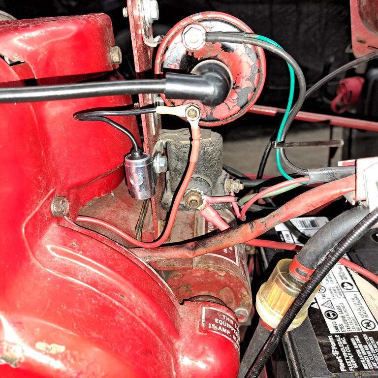

squonk 48,141 #8 Posted March 19, 2023 New solenoid and a nasty cable! 2 Share this post Link to post Share on other sites
