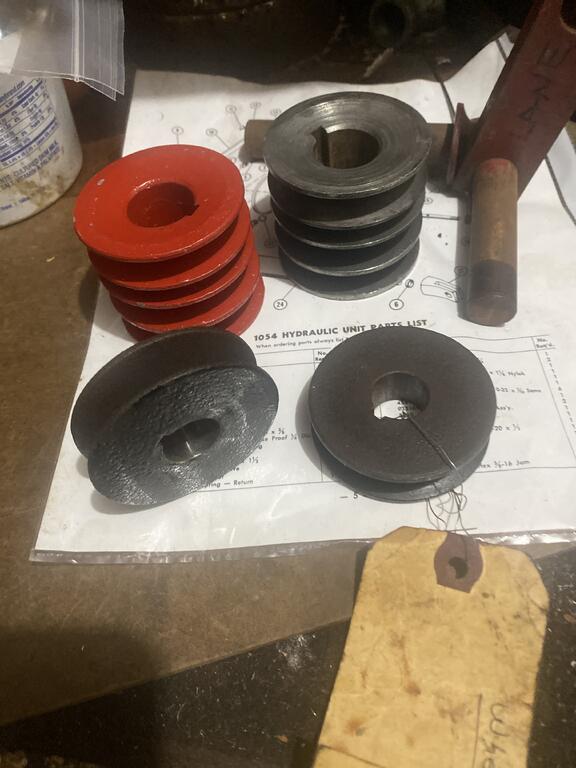

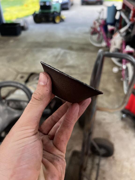

Lane Ranger 12,031 #26 Posted March 17, 2023 (edited) 7 hours ago, oliver2-44 said: @WH1618speed I'm going to jump in your thread as I need some Suburban engine drive pulleys (originally WH 1608 2-1/2" OD x 3/4" ID ) which I think possible were the same ones for the RJ that you need. So maybe this will help both of us. I'm wondering if these cast steel pulleys from Surplus Center could be used. Question to ya'll RJ/Suburban guys @WHX?? @Racinbob @Lane Ranger @wallfishand others Did the WH1608 pulley have a side hub with the set screw in it, or was their no side hub and the set screw was in the bottom of the belt groove? https://www.surpluscenter.com/Power-Transmission/Pulleys/Finished-Bore-Pulleys/2-45-OD-3-4-Bore-1-Groove-Pulley-1-BK24-C.axd If there was no side hub am I thinking correctly that the hub on this surplus Center pulley could be machined off and a set screw added to the bottom of the pulley groove? Note: The Wh pulley is listed as 2.5" OD and this one is listed as 2.45 OD so it would make the tractor a tiny tiny bit slower. I have used those Surplus Center pulleys but only as a single pulley for a tractor motor. The only issue with that pulley as is is that the shaft of the motor needs to accommodate with 1) RJ belt guard and 2) if you want to mow a second one outside shaft on guard for mower belt. Many of the Kohler replacement K91 motors have a former shaft on them that RJ peers are using for restorations. Edited March 17, 2023 by Lane Ranger Share this post Link to post Share on other sites
oliver2-44 11,632 #27 Posted March 17, 2023 4 hours ago, Lane Ranger said: I have used those Surplus Center pulleys but only as a single pulley for a tractor motor. The only issue with that pulley as is is that the shaft of the motor needs to accommodate with 1) RJ belt guard and 2) if you want to mow a second one outside shaft on guard for mower belt. Many of the Kohler replacement K91 motors have a former shaft on them that RJ peers are using for restorations. @Lane RangerWill a pulley like the red one work and fit through the guard to have one on the outside of the guard to use with an mower or sickle? Or do you need 2 of the single pulleys like in the bottom of your picture Share this post Link to post Share on other sites
WH1618speed 543 #28 Posted March 17, 2023 (edited) Well, i tried to start the motor yesterday, I grounded the switch wire and replaced and gapped the points to 0.020” still no spark. Is it a magneto issue? I also noticed the compression isn’t that great. I think the motor will end up needing a rebuild. Edited March 17, 2023 by WH1618speed Share this post Link to post Share on other sites
wallfish 20,231 #29 Posted March 17, 2023 (edited) 2 hours ago, WH1618speed said: Well, i tried to start the motor yesterday, I grounded the switch wire and replaced and gapped the points to 0.0020” still no spark. Is it a magneto issue? I also noticed the compression isn’t that great. I think the motor will end up needing a rebuild. Do NOT ground the switch wire! That's how it is killed for shutting it off. The switch grounds that wire. If it's grounded it's killing the spark Disconnect it from anything, just leave it loose for starting it. Assume you meant to write .020 for the points. A good starting point for that but K91 engines tend to need some adjustment off of that for optimum performance. 6 hours ago, oliver2-44 said: Will a pulley like the red one work and fit through the guard to have one on the outside of the guard to use with an mower or sickle? Or do you need 2 of the single pulleys like in the bottom of your picture You need 2 pulleys to put the belt guard on and the outside one to run a deck The issue with using two HUB style pulleys is you run out of shaft. If you can't find original style pulleys, for a life hack you can cut the hubs off of commonly found pulleys with a hub and thread a set screw down in the groove. If you can get two hub pulleys on there then you can use those Edited March 17, 2023 by wallfish 1 1 Share this post Link to post Share on other sites

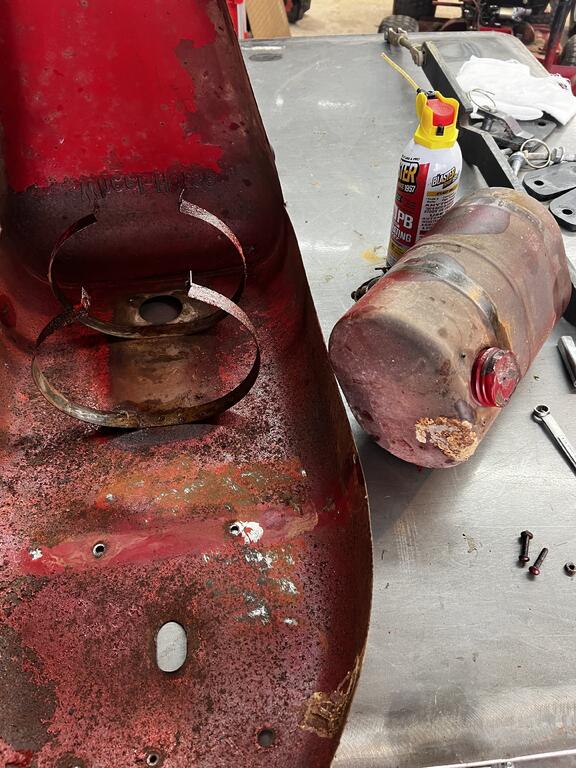

WH1618speed 543 #34 Posted March 22, 2023 Thank goodness for perfect tank straps and a not rusted out fuel tank🙌 1 Share this post Link to post Share on other sites

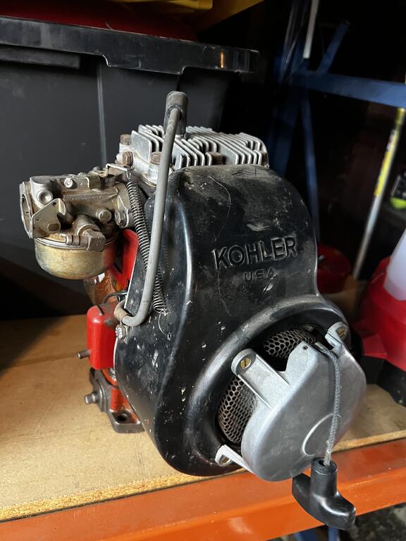

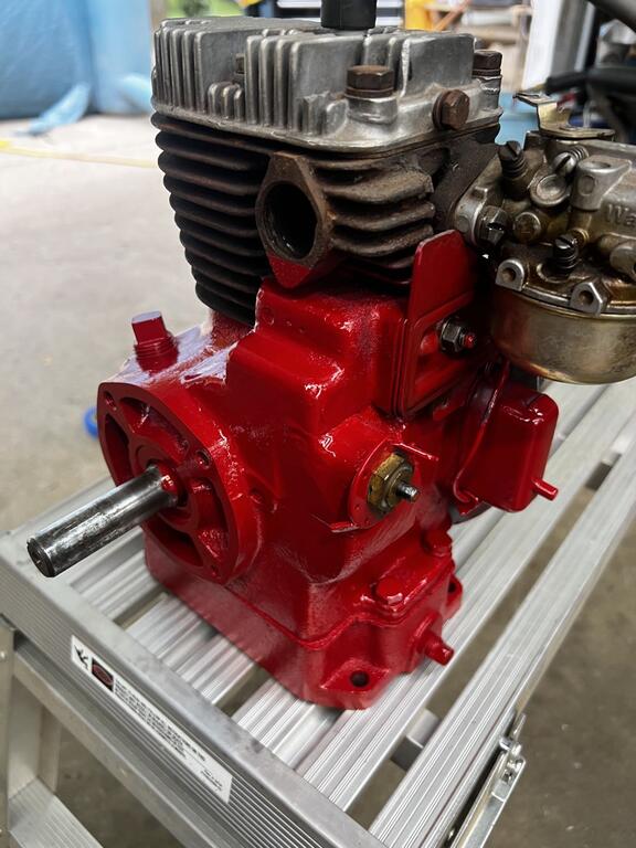

WH1618speed 543 #35 Posted May 7, 2023 Haven’t updated in a while but I tore down the motor. The piston had small dents in the top, intake valve is rusted, and there seems to be an issue with the ignition system. So I went and picked up another K91 for her that will work great. I also picked up some front tires and rims that aren’t rusted through. I should be able to start the process of sanding and paint prepping this week! 2 1 Share this post Link to post Share on other sites

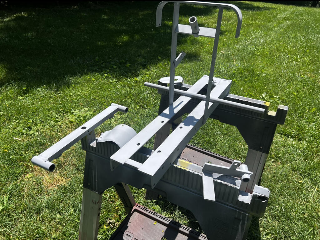

WH1618speed 543 #36 Posted May 9, 2023 (edited) Update: got it down the the frame. If it can come off it’s coming off. I should be able to start paint prep this weekend. I’ve ordered a ton of new parts and it should be coming together soon. Edited May 9, 2023 by WH1618speed 1 Share this post Link to post Share on other sites

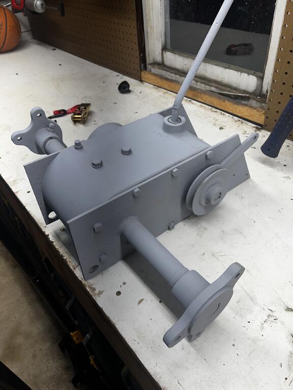

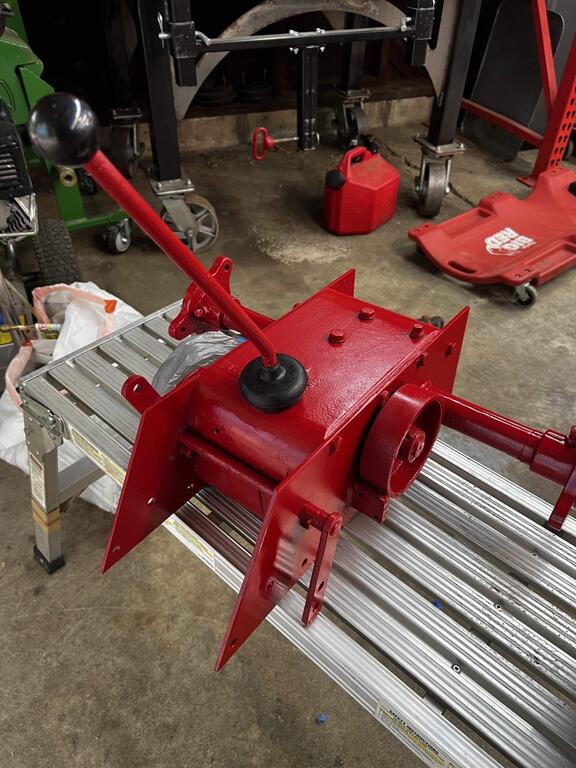

WH1618speed 543 #37 Posted May 10, 2023 Primed the transaxle! 1 Share this post Link to post Share on other sites

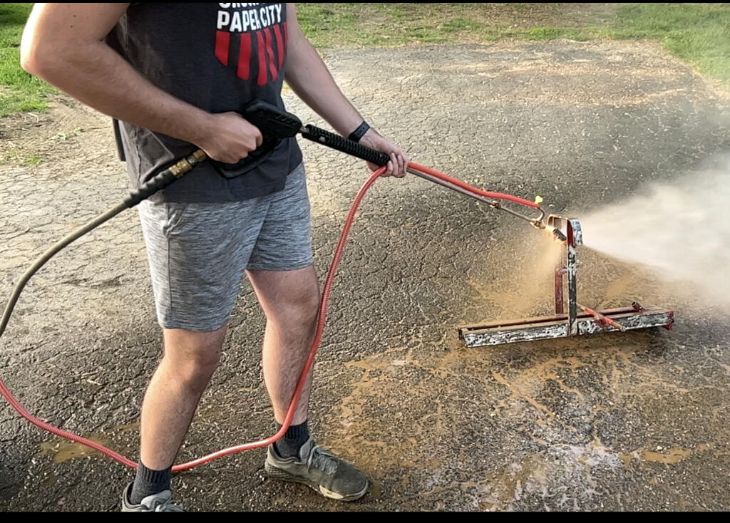

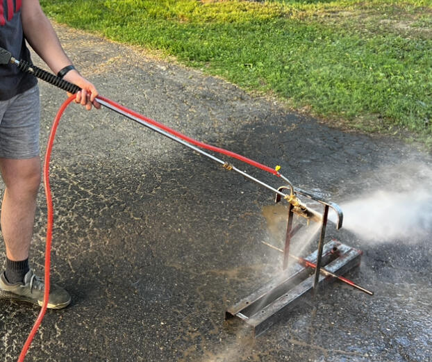

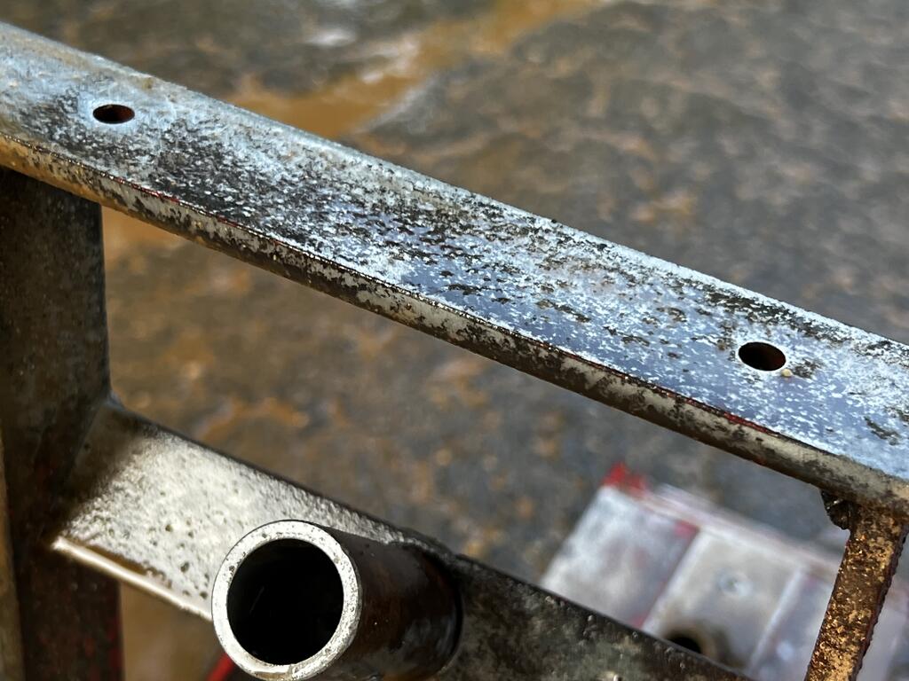

WH1618speed 543 #41 Posted May 24, 2023 Well we got a sand blaster attachment for our pressure washer. Works pretty good. Beats a wire wheel and die grinder. 1 Share this post Link to post Share on other sites
Handy Don 16,974 #43 Posted May 24, 2023 Interesting blaster. Vendor? Kind and rate of usage for medium? Share this post Link to post Share on other sites
WH1618speed 543 #45 Posted May 25, 2023 23 hours ago, Handy Don said: Interesting blaster. Vendor? Kind and rate of usage for medium? I got it from Amazon. $33. Thought it would be cool to try out. We started with concrete sand but it kept getting clogged. Going to try pool sand and play sand to see if that helps. 1 Share this post Link to post Share on other sites

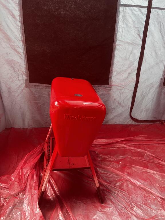

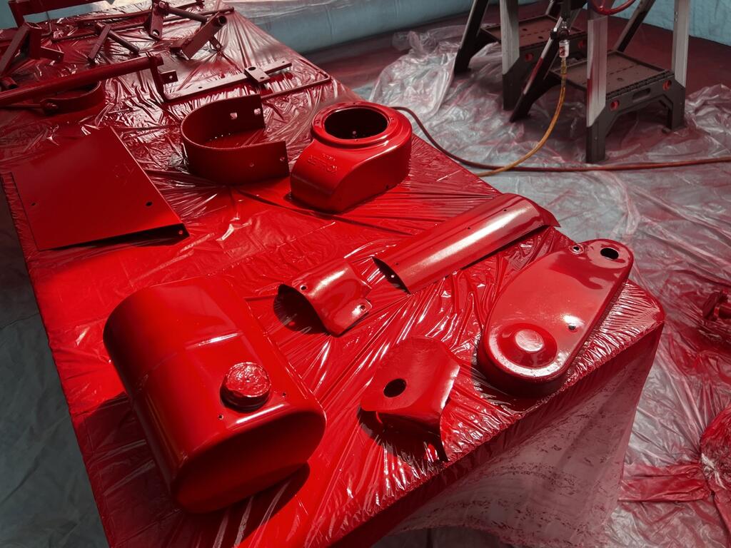

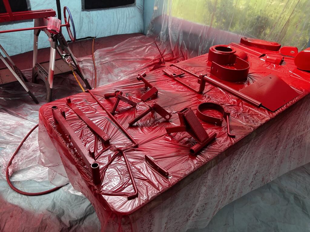

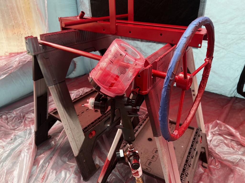

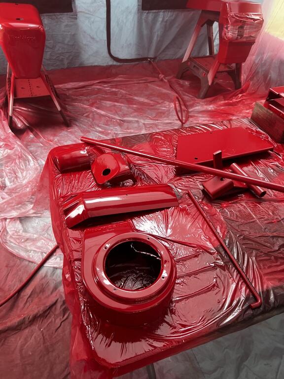

WH1618speed 543 #46 Posted June 4, 2023 UPDATE: I used pool sand in the sandblaster. Much better results. Now priming everything and hopefully I’ll get to paint tomorrow! 1 Share this post Link to post Share on other sites

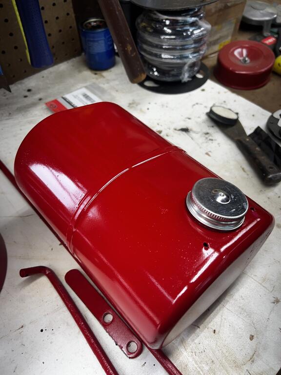

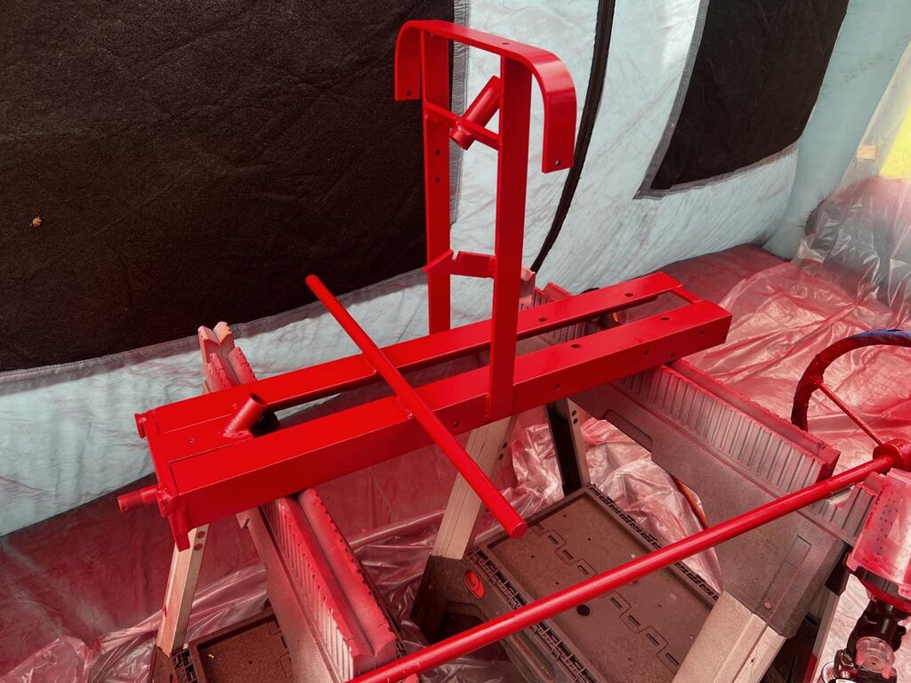

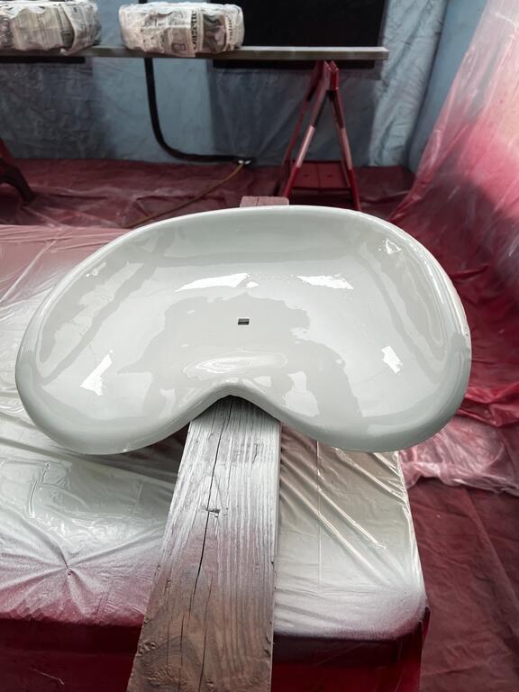

WH1618speed 543 #47 Posted June 20, 2023 Well, she is finished! Hasn't been sunny out so no outside pics yet, but this is what I've got! 1 Share this post Link to post Share on other sites
