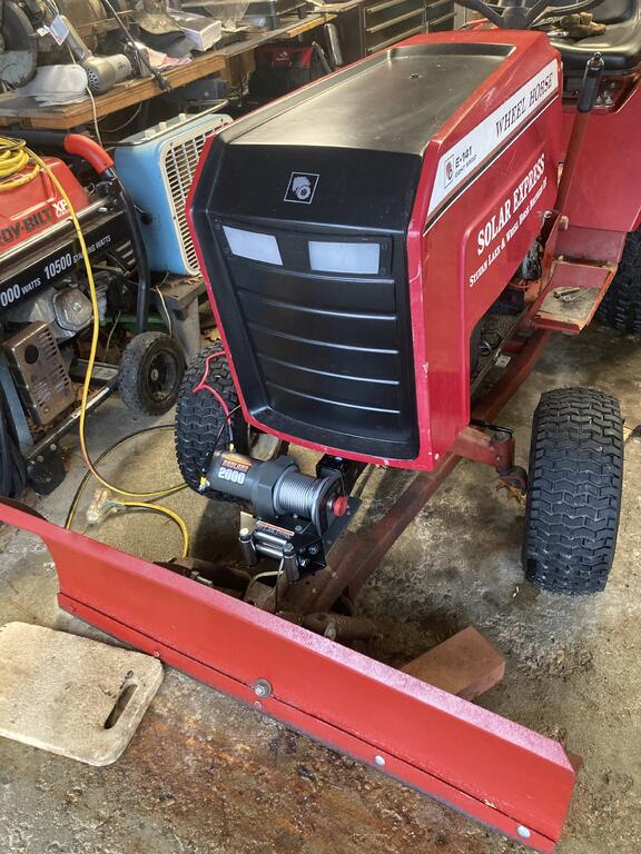

SylvanLakeWH 32,693 #1 Posted March 10, 2023 (edited) The Popeye Arm is getting old and stiff doing snow with the manual lift... So... Proof of concept using a HF winch... Still working on the details but it works... The winch plate attaches to the 2" hitch. Edited March 10, 2023 by SylvanLakeWH 4 7 Share this post Link to post Share on other sites

elcamino/wheelhorse 9,363 #3 Posted March 11, 2023 How does this effect downward pressure? I always figured that a cable system to lift the blade would allow the blade to ride up. 2 Share this post Link to post Share on other sites
SylvanLakeWH 32,693 #4 Posted March 11, 2023 1 minute ago, elcamino/wheelhorse said: How does this effect downward pressure? I always figured that a cable system to lift the blade would allow the blade to ride up. I don't use / have down pressure. I don't use a solid link and I have not had any issues on the 3 concrete drives I plow... I haven't used it yet to plow but it should have no impact. I'm still working out wires, switch placement etc. 16 minutes ago, Pullstart said: The snow plow for the Senior has a series of pulleys to lift from the front, via energy at the rear. If you have cable enough and I ASSUME you do, you can mount the winch anywhere if that becomes in the way.. It seems to have adequate lift. I wanted it on the 2" receiver plate so I can move it around easily... I just put an eyebolt in the bottom of the plow and hook onto that... works pretty well... 2 Share this post Link to post Share on other sites

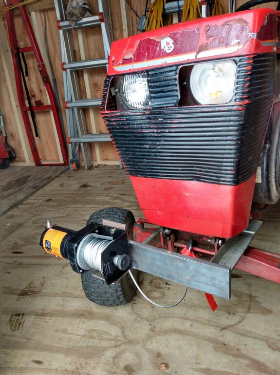

CCW 1,519 #6 Posted March 11, 2023 Blade lifting is one of the things I had in mind when mounting my winch. 3 Share this post Link to post Share on other sites

ebinmaine 80,904 #17 Posted March 11, 2023 Excellent work here Jim. On that linear actuator, as long as the actuator has NO direct contact with the plow it would work great. The lift section would need to be a chain/cable NOT a solid link. The actuators, for the most part, aren't made to take the sudden strains of a working plow. 1 3 Share this post Link to post Share on other sites
Ed Kennell 47,586 #18 Posted March 11, 2023 Hey Jim, Feel I should share a problem I found years ago when I mounted a wheel horse plow on my Yammy 4 wheeler. I used a RC HF winch to lift the plow and was not able to control the winch overrun and broke a few eyebolts before I installed a heave spring in the lift cable. You can also see a lever that pulls the blade locking pin when the plow is raised allowing the blade angle to be changed. 2 2 1 Share this post Link to post Share on other sites
wallfish 20,656 #19 Posted March 11, 2023 (edited) 11 hours ago, SylvanLakeWH said: if so, how? Without a doubt you should use a spring like Ed posted for the link to the plow frame when using a winch Edited March 11, 2023 by wallfish 4 1 Share this post Link to post Share on other sites
