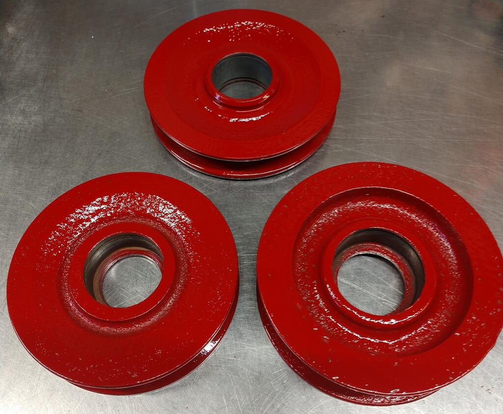

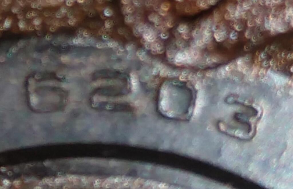

kpinnc 19,110 #1 Posted March 6, 2023 You can't make this up: I pulled old bearings from an idler pulley to change out, and copied the number down so as to get more... Well, 6203 bearings don't have a .75 ID now. Now they are .625. Who decided to change this? I even looked up several cross reference guides and sure enough, they are 5/8 bore now. But I took this bearing off a mule drive. I took the pic below immediately so I'd have the correct numbers. This spring's "prep work" is becoming a PAIN! 1 1 Share this post Link to post Share on other sites
squonk 48,429 #2 Posted March 6, 2023 There are a lot of 6203 bearings of different sizes id . Always been. Some 1/2" ID some 5/8" ID. Some 3/4. 6203-2RS-8 1/2 Bearing 0.500 inch 6203-2RS-10 5/8 Bearing 0.625 6203-2RS-12 3/4" 5 Share this post Link to post Share on other sites
953 nut 70,666 #3 Posted March 6, 2023 So.......... it stands to reason that a 6203-12-2RS would have a 3/4" ID Sure enough it does! Thanks for the information @squonk https://shop.forcesinc.ca/products/6203-12-2rs-ball-bearings-inch-3-4-x40mmx12mm-seal-2rs?variant=42319706751195¤cy=CAD&utm_medium=product_sync&utm_source=google&utm_content=sag_organic&utm_campaign=sag_organic&gclid=CjwKCAiAu5agBhBzEiwAdiR5tFyNvk2vN1uRj8wtg8ks0o2fcJpBOqXeiBKC_W4yBwlgMn4CV-Tv5BoCZycQAvD_BwE Share this post Link to post Share on other sites
squonk 48,429 #4 Posted March 6, 2023 Just now, 953 nut said: So.......... it stands to reason that a 6203-12-2RS would have a 3/4" ID Sure enough it does! Thanks for the information @squonk https://shop.forcesinc.ca/products/6203-12-2rs-ball-bearings-inch-3-4-x40mmx12mm-seal-2rs?variant=42319706751195¤cy=CAD&utm_medium=product_sync&utm_source=google&utm_content=sag_organic&utm_campaign=sag_organic&gclid=CjwKCAiAu5agBhBzEiwAdiR5tFyNvk2vN1uRj8wtg8ks0o2fcJpBOqXeiBKC_W4yBwlgMn4CV-Tv5BoCZycQAvD_BwE I copied the info on sizes. My site for the 3/4 was a small font for some reason. Share this post Link to post Share on other sites
squonk 48,429 #5 Posted March 6, 2023 There are also bearing that look like 6203's but have a slight difference in OD and thickness. Best to measure everything before ordering. 2 Share this post Link to post Share on other sites

squonk 48,429 #9 Posted March 7, 2023 A std. 6203 is actually 17mm id x 40mm od. 12mm thick. ( 1/2" shaft ). Some bearing manufacturers don't put all the numbers on them so you have to check them. Share this post Link to post Share on other sites

squonk 48,429 #11 Posted March 7, 2023 Are those mule drive pullies ? Some of them take a totally different bearing 1630-2RLD-C3 3/4" bore x 1 5/8" OD x 1/2" thick for the mule drive V pulley and a 6203-12 for the flat idler The 6204 is a 20MM ( .78" ) ID x 47MM ( 1.85" ) OD x 14MM ( .55" ) thick 1 Share this post Link to post Share on other sites
kpinnc 19,110 #12 Posted March 8, 2023 Well I prolly got the wrong ones again. Used to be a shop in town that sold all kinds of manufacturing supplies- and specialized in bearings. I got used to cheating- meaning I just took the old bearing, or at least the races, and they'd figure out what it was. Almost always they had stock of what I needed. And of course, during Covid they shut down. The business still runs, but the retail store never reopened. 1 Share this post Link to post Share on other sites
