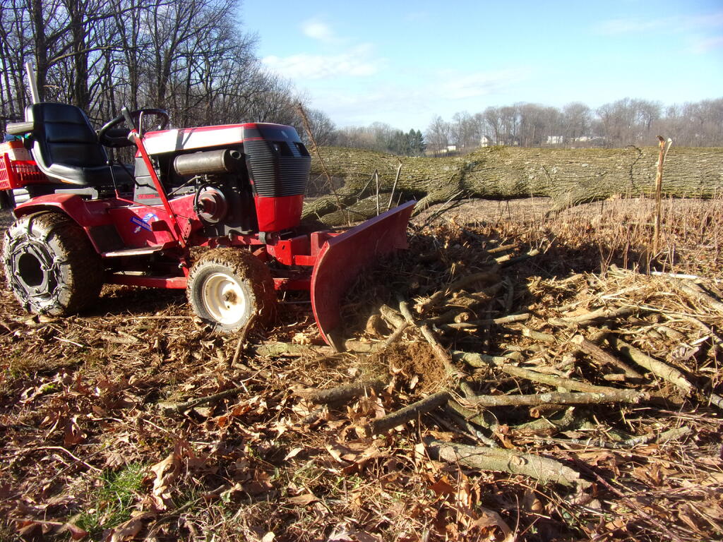

Ed Kennell 43,936 #39 Posted March 2, 2023 (edited) 26 minutes ago, Blasterdad said: I've seen where someone used longer spring rods & put 2 springs on each side, I searched for a pic but can't find it. I've seen that also, but felt that defeats the safety function of the blade trip design. My blade trips quite often as I use my blade for a lot of dozer work including trail work where I am catching on roots. I am thankful the blade does trip fairly easily so I can do the work without fear of damaging the equipment. Edited March 2, 2023 by Ed Kennell 1 2 Share this post Link to post Share on other sites
Handy Don 15,384 #40 Posted March 2, 2023 2 hours ago, Ed Kennell said: I've seen that also, but felt that defeats the safety function of the blade trip design. My blade trips quite often as I use my blade for a lot of dozer work including trail work where I am catching on roots. I am thankful the blade does trip fairly easily so I can do the work without fear of damaging the equipment. Exactly. I have no problem backing up and then going forward again! @ebinmaine mentioned replacing with aftermarket that have a perpendicular loop of the coil as the attachment. I did some research and decided no for now. Too costly, no way to compare the force/displacement with the WH items, and would need to re-think the mounting to handle point loading at the ends (vs. the sleeves of the WH system). 2 hours ago, Blasterdad said: I wasn't suggesting that perticular clamp before, just one with a wider / stronger grip than a hose clamp, this style is even thicker. Just my Idea... A spring’s diameter gets smaller when it’s stretched. (Remember those finger handcuffs we had when we were kids?) In my mind, if the current components are not mating tightly enough when the spring gets stretched then a clamp would have to both shrink the starting diameter of the spring AND not loosen when the spring gets stretched. Not a trivial (or cheap to solve) mechanical accomplishment. Clamping an exhaust pipe where the clamp can prevent thermal expansion (or allow only some as it itself expands) is a different ballgame. Share this post Link to post Share on other sites

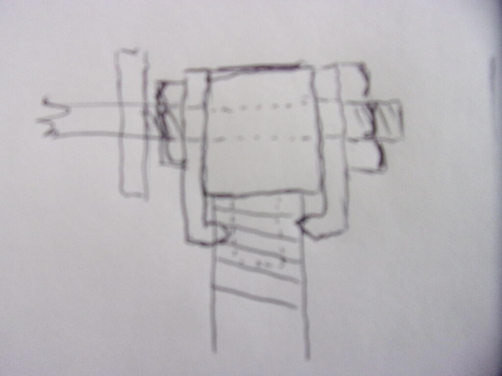

Ed Kennell 43,936 #41 Posted March 2, 2023 Just thinking how I might fasten a spring if one of mine becomes loose. Share this post Link to post Share on other sites
Handy Don 15,384 #42 Posted March 2, 2023 2 minutes ago, Ed Kennell said: Just thinking how I might fasten a spring if one of mine becomes loose. That is intriguing, Ed. Completely separate spring retention clamps. Some challenges to permit plow tipping freedom (though both ends on the same shaft could be locked to the shaft and rotate together). Need it at all four ends. Some additional thoughts? Share this post Link to post Share on other sites
ebinmaine 76,148 #43 Posted March 2, 2023 35 minutes ago, Handy Don said: need to re-think the mounting to handle point loading at the ends The one I remember had the ½" rods used so the springs went around the rods. No mounting changes were necessary. The springs though.... I don't have the foggiest idea how they were chosen. Share this post Link to post Share on other sites
