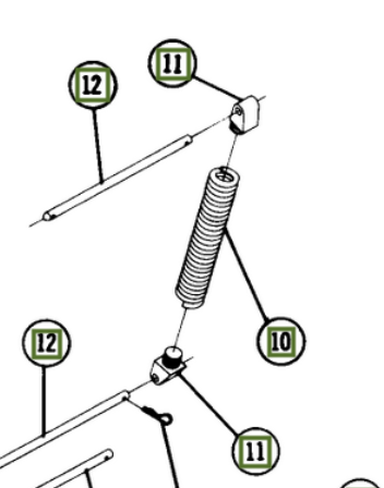

Handy Don 16,568 #3 Posted February 28, 2023 2 minutes ago, SylvanLakeWH said: Pic? JB weld on a spring may be asking for it in the future...? Cold, dark, heavy gloves, frustrated, dinner waiting... Nope, pictures were not on my mind . Part 11 (end) separated from part 10 (spring) on the lower end of the spring. Part 11 is cast iron and is threaded to “screw into” the spring. Those threads are still there but seemed a bit worn. Of course, I don’t know any history of this plow's use so I can’t speculate if this has or has not happened before. 1 Share this post Link to post Share on other sites

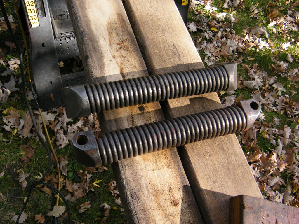

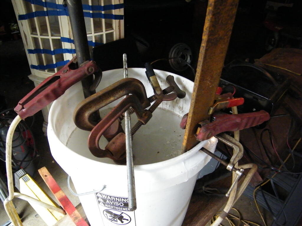

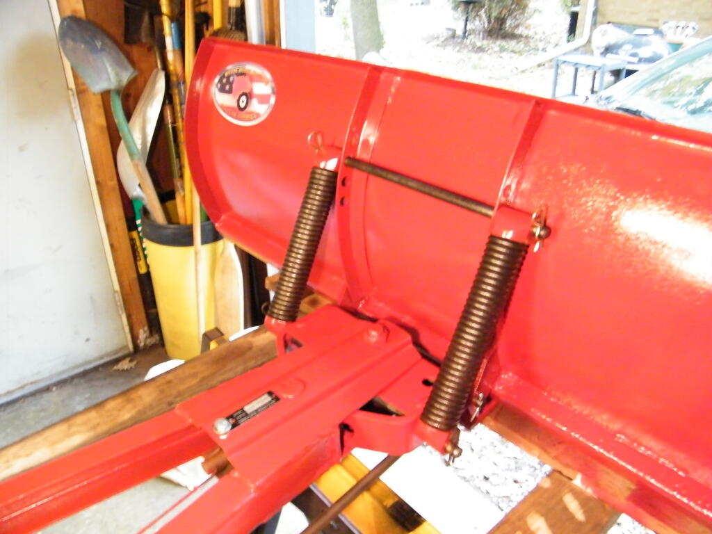

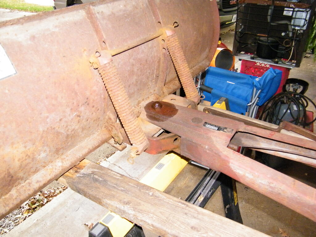

stevasaurus 23,689 #10 Posted February 28, 2023 Check this out. I refurbished my B-100 Snow Blade some years ago. This may help you. This is what the springs looked like. The springs going through electrolysis. This is how they came out and I then soaked them in a oil bath for a few days. A metal bread pan was perfect for both springs. The oil was a mixture of Brake Fluid, Auto-matic Trans Fluid (Red), and some Acetone. The finished product. I feel like the process re-newed the springs. 5 1 Share this post Link to post Share on other sites
