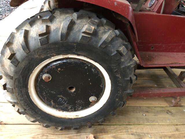

ebinmaine 81,204 #51 Posted March 2, 2023 10 minutes ago, Sailman said: "Digger" my C-120 came with those tires on the back and they work great with my front push blade. Pushed a whole lot of dirt and gravel with that tractor! Going to add the same tread to the fronts since steering traction when pushing was the only weak area. Can you post a pic of the tires that are on the back of your c-120? I couldn't find these in a large enough size... Share this post Link to post Share on other sites

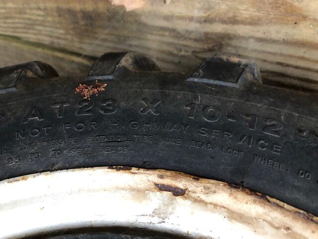

Sailman 1,307 #57 Posted March 3, 2023 (edited) Eric, Attached are the pictures of the tires. I think they may actually be ATV tires. No telling how old they are or if they are still available. They are great diggers!! Edited March 3, 2023 by Sailman 1 1 Share this post Link to post Share on other sites
Sailman 1,307 #58 Posted March 3, 2023 (edited) Just looked on e-bay and they have these in 23 inch, 24 inch and 25 inch. Enter the following in e-bay search; carlisle AT 489 atv tires AT23 x 10-12 ......but they ain't cheap! Edited March 3, 2023 by Sailman 1 Share this post Link to post Share on other sites
ebinmaine 81,204 #59 Posted March 3, 2023 26 minutes ago, Sailman said: carlisle AT 489 atv tires AT23 x 10-12 Share this post Link to post Share on other sites
