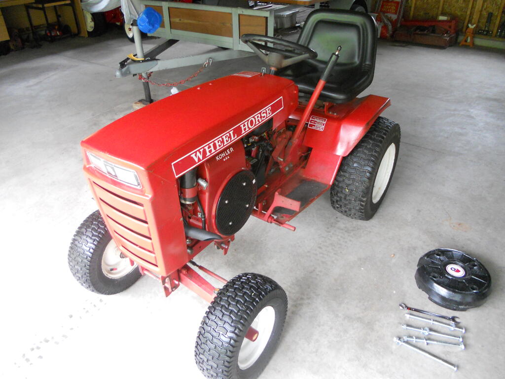

Racinbob 12,747 #8 Posted February 26, 2023 (edited) Yup, I'm guilty. I bought a 1976 B-80 brand new and shortly thereafter converted it. I removed the B-80 tower decals with the intentions of getting B-160 decals but still haven't done it. That is correct. The B's and C's shared the same belt guards in 76 and 77. The bolt that goes into the engine block on the big blocks is 7/16" while the small block bolt is 3/8". @Clarence T. Nolley Jr go ahead and get that belt guard if the tractors are either of those years. The earlier B's were shorter and the later B's were lawn tractors. Also keep in mind that the hydros used a different belt guard that the 8-speeds but can be converted. Edited February 26, 2023 by Racinbob 2 1 Share this post Link to post Share on other sites
