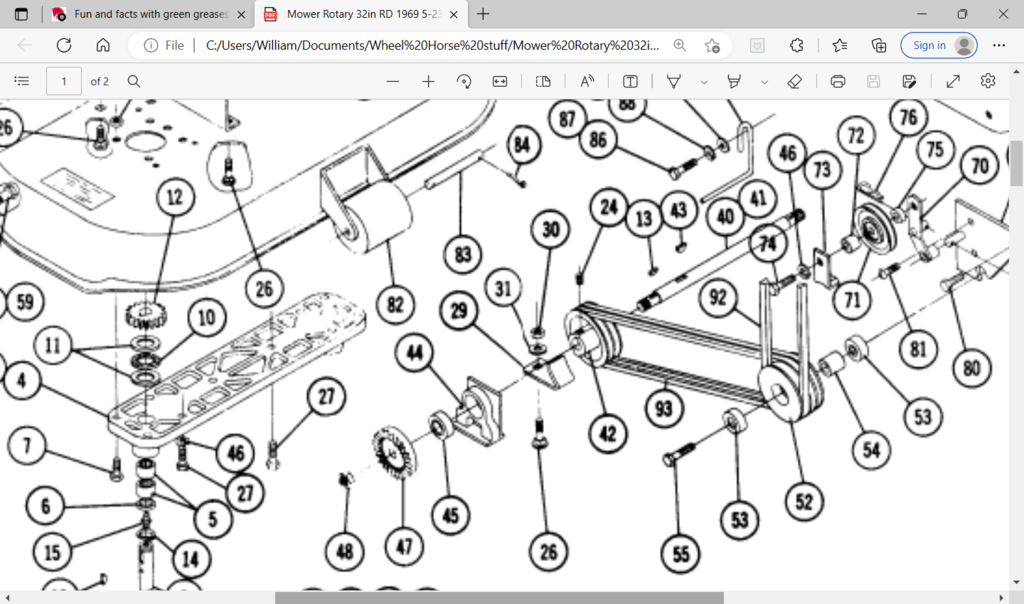

ri702bill 12,170 #1 Posted January 30, 2023 (edited) All: A while back, I posted regarding finding a suitable replacement for the almost unobtainable Lucas Green X-Tra HD grease that some (most??) here regard to be the best suited product to keep our WH toys alive.... First off a tip of the WH cap to three members - @peter lena, @Handy Don, and our resident YT guy @Pullstart....... I recently bought 2 late 1960's gear drive cutting decks - a rather nice 32" and a roached 36". I intend to go thru the 32" with a cleaning, new needle bearings and seals. Here is the opportunity to do a side-by-side comparison of the two grease products run under the same conditions and evaluated. Per Pete Lena's advise. I cleaned out the 2 cross shaft bearings, one repacked with Lucas Green, the other with JD Green. I will be trading some deck parts with Don shortly to make the deck complete. I will assemble each side with it's respective grease - bearings, gears, spindles. I intend to gather "before" pictures and free running torque readings, then in MAY or so, mount this unit on a Round Hood , cut the grass, and take temperature readings and repeat the free running torque. There will only be data presented, NO YT video, Unless Kevin wishes to reinact this exercise and make his own, best done with cardboard cutouts and hand sock puppets !!! All in fun there guys, just figured why not use one of my own toys for this study. More later, a lot later.... Edited January 31, 2023 by ri702bill 3 2 1 1 Share this post Link to post Share on other sites

ri702bill 12,170 #4 Posted January 31, 2023 (edited) I have an inch pound torque wrench - there is a hexnut at either of the #40 cross shaft.Disconnect the #93 double lower belts, remove the blade and drive cup from one spindle and push the shaft and key up thru the spur gear. Remove the spur gear, spin the cross shaft with the torque wrench - it has the movable taletale that stays at the highest reading. Reassemble, repeat for the other side. Not easy, just peasy....... and a tad greasy. Edited January 31, 2023 by ri702bill 2 Share this post Link to post Share on other sites
