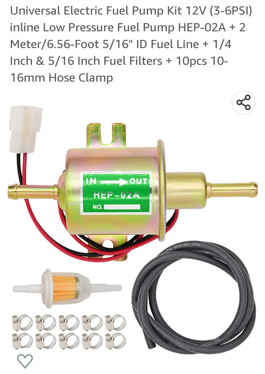

rmaynard 17,642 #1 Posted January 28, 2023 I'm thinking of putting an electric fuel pump on my 416-H. Has anyone had any experience with one of these? Share this post Link to post Share on other sites
953 nut 70,325 #2 Posted January 28, 2023 If you get a good one it will last a long time as one of mine has, the others gave up in less than a year and you are never near the barn when that happens. I have had good results with these over the past five years. 1 1 Share this post Link to post Share on other sites
rmaynard 17,642 #3 Posted January 28, 2023 Thanks Dick. The only reason that I suggested the one in my post is that my brother has used these on his Cub Cadets with success. All opinions welcomed. 1 Share this post Link to post Share on other sites
WHX?? 58,347 #4 Posted January 28, 2023 Used the same one on a customer's Cub ZT. Worked great and he didn't come back to complain so 2 Share this post Link to post Share on other sites
squonk 48,324 #5 Posted January 28, 2023 Carbole and Facet same pump with a different tag. It's what I use. I have seen the all metal round ones fail a lot. Share this post Link to post Share on other sites
pacer 3,181 #6 Posted January 28, 2023 I started out using that 'type' with good luck, but on about the3rd/4th one it failed too quick, tried another with quick failure so I switched to the type shown or this type---- had no more early failures... Share this post Link to post Share on other sites

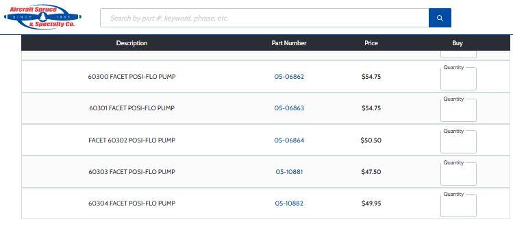

kpinnc 19,060 #11 Posted January 29, 2023 12 hours ago, 953 nut said: I have had good results with these over the past five years. Got a link by chance? I have a Facet, but $70 each is a bit steep. 1 Share this post Link to post Share on other sites
RED-Z06 2,720 #12 Posted January 29, 2023 Ive removed quite a few electric pumps off customer mowers to return to or add-on a pulse type pump, common problems are lifespan...if you arent spending $60+ on a pump it may not last long. Going over bumps can cause momentary flooding/sputtering..because of the constant pressure and higher flow behind the seat...if the float drops it can rapidly overfill the bowl for a few moments. Most onans have a 20a charging system but some mowers only have 3a to 5a charging systems..the 2 to 2.5amp draw can be taxing on some mowers. Ive never had any problems with pulse pumps myself, ive added many to swapped engines and they have always performed well for me...you dont even really think about them because they just work. The original 1993 pump on my 416-H failed in 2020...started dripping out the vent indicating the dry side of the pump was wet. $25 pump and 2 minutes..back in business. If i run it dry by mistake its generally fires up in 8 seconds of cranking...nothing excessive. Oddly though..ive had 5 FD kawasakis that had a factory electric pump and never had any problems out of those..im not sure if they are just designed to work with the pump they have...but they work well. Share this post Link to post Share on other sites
953 nut 70,325 #13 Posted January 29, 2023 9 hours ago, kpinnc said: Got a link by chance? I have a Facet, but $70 each is a bit steep. https://www.ebay.com/itm/254470209464 Share this post Link to post Share on other sites
pfrederi 21,303 #14 Posted January 29, 2023 10 hours ago, kpinnc said: Got a link by chance? I have a Facet, but $70 each is a bit steep. Look other places for Facet. Last one I bought still made in USA. Do not think Carbole are made here 1 Share this post Link to post Share on other sites
