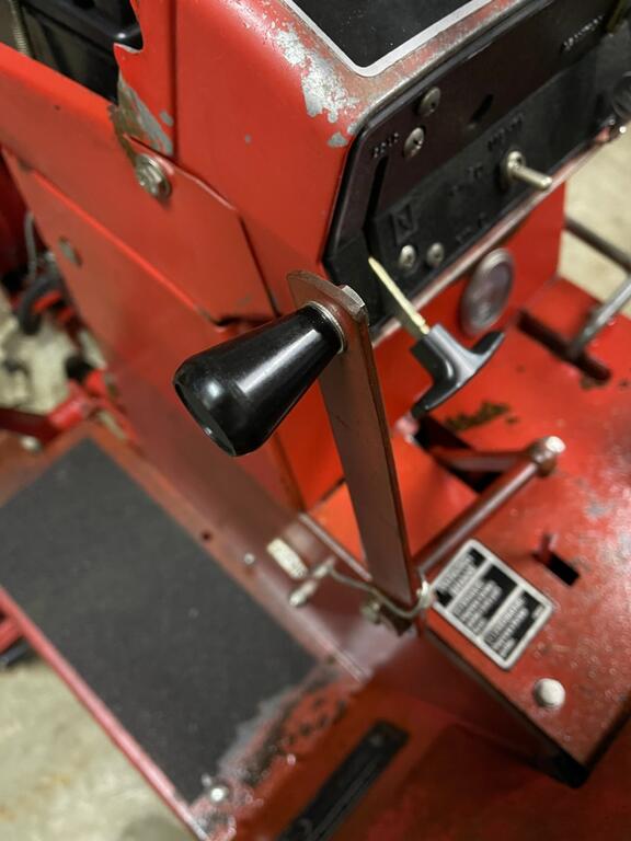

New Lift Handle!
Lookin' shahp!!

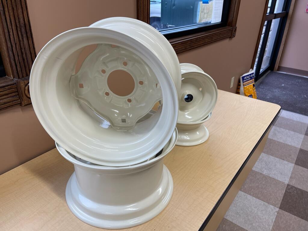

TractorEd
Picked up rims today!
PPG RAL 1013 Oyster White
  • Excellent 6
Blasterdad
Those turned out BEAUTIFUL !!!
What size / kind of tires ya gonna put on them?  :popcorn:

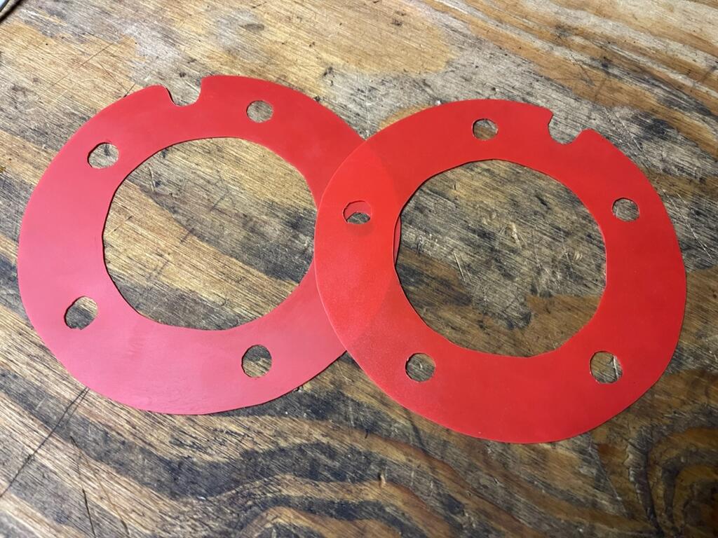

I learned with the C-100 that when you put fresh powder coated rims on wheel hubs they tend to stick together really good.
This time around I made these “protectors” to hopefully avoid that again.
I cut them from a plastic divider for binders (folders).  I hope they work!
Edited by TractorEd

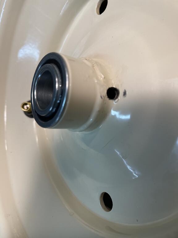

One of the front rims is leaking air out the hole where the grease fitting threads into.
Anyone have a fix for that?  Pipe dope?
May be in the market for a front rim or pair of rims.

I'd try teflon tape first, maybe a spot weld or JB weld on the inside of the rim ? Can you see a hole inside the rim?

Tires were just mounted today, I don’t want to break the bead, not yet anyway.
TractorEd
If this pipe dope doesn’t work I’ll try Teflon tape.
Tubes
kpinnc
Inner tube.
TractorEd
45 minutes ago, ebinmaine said:
Tubes
43 minutes ago, kpinnc said:
Inner tube.
Yeah tubes for sure if it’s still leaking tomorrow.  I’ll get back on it this weekend and see if it drives.
Thanks!
Thanks!
Ed, I've gotten to the point where ALL the tires I swap/deflate/install get a tube.
No more trying with 3 men and a boy to get the bead to seat and situations like yours are eliminated.

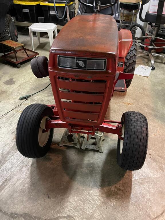

TractorEd
I’m happy to announce that, she’s a runner!
And a mover!
And the hydraulic lift works!

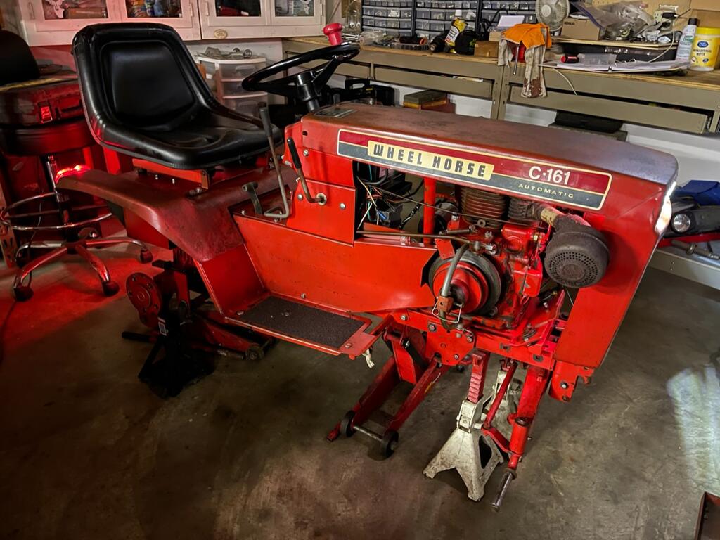

TractorEd
I still have work to do, but my other work has been consuming all my time!

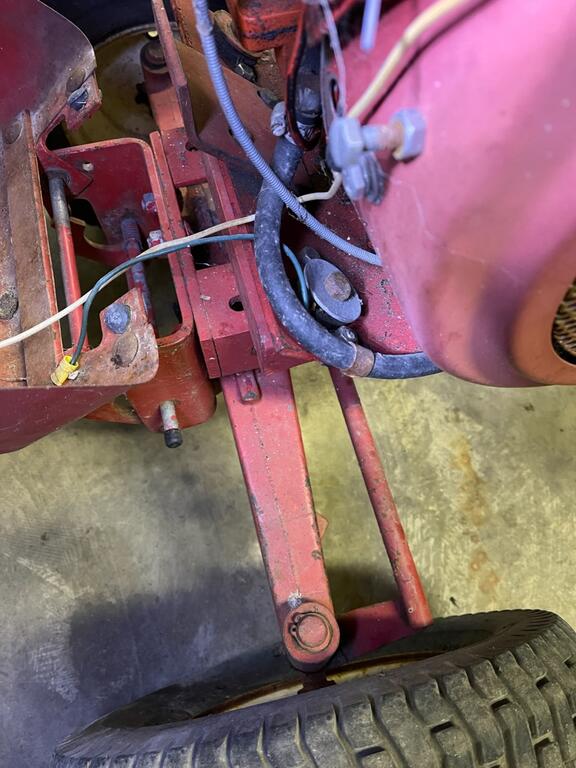

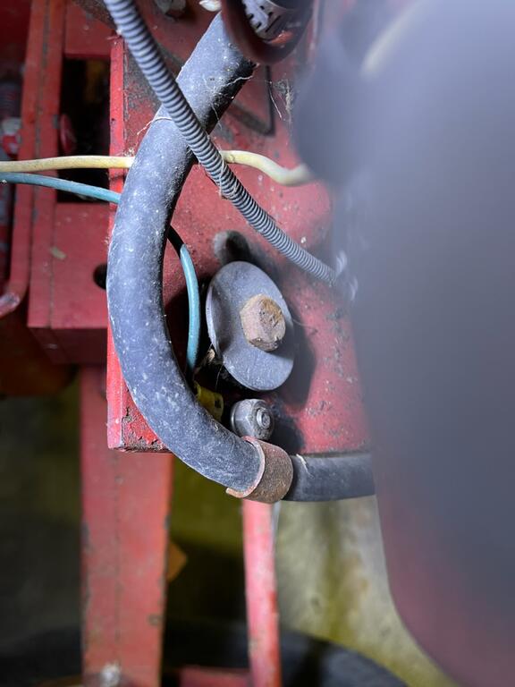

Anyway, here’s a rando pic.  Does this routing look proper for a C-161 ( fuel line and ground for headlight/hood)?
c-series don
I’ve never seen the fuel line clamped to the shaker plate before. Usually clamped to the blower housing using the housing bolts. The ground wire was added as an additional. Personally I like the idea because the lights were grounded through the hood, which was grounded through the hood hinge pin and the hood latch. Just my observations over the years. Not that I worked at the factory or anything, although sometimes I wish I did!
TractorEd
Thanks for the info!  The fuel line is clamped the same way on the other side of the shaker plate too.  I thought it was an interesting choice; maybe partially due to one of the blower housing bolt holes being strippped out (which I blue loctited that bolt in place for now).

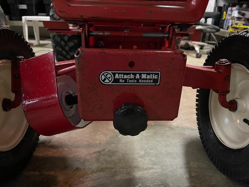

TractorEd
I installed the front tubes and now she’s able to trot.
Then I greased all the fittings while she was still in the air.
And thanks to @A-Z Tractor she has a mule drive, too.
