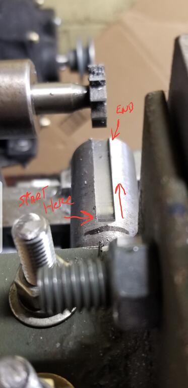

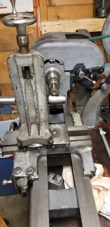

gt14rider 1,278 #1 Posted January 26, 2023 Need some help, ICRS, Cutting a keyway in a axle. 1/4" x 1" woodruff key cutter, What are the axles made of and what should the spindle speed be. Cut a slot at 112 rpm. It seem slow. It's been 40 years since I worked a lathe. I need a (how to run a lathe/mill for dummies. Any help would be appreciated 1 Share this post Link to post Share on other sites

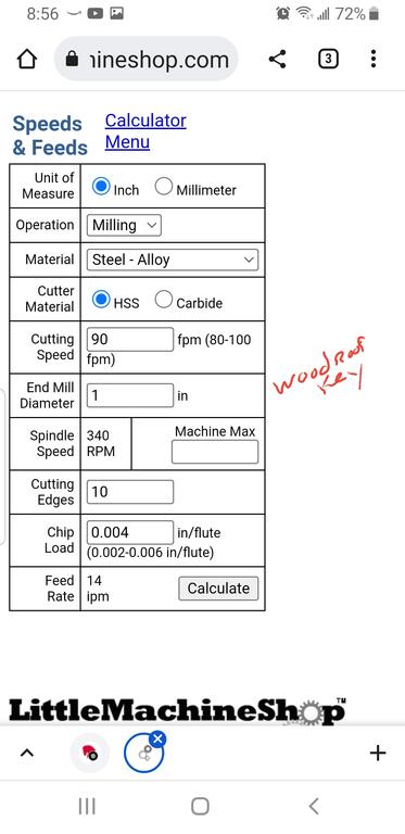

lynnmor 9,042 #2 Posted January 26, 2023 I tried to find you a good chart online, what a confusing bunch of nonsense. Here is one that might help you, just plug in what you know and click calculate. I would use the alloy steel option. Be aware that the bearing area is hardened on a Wheel Horse axle and if that hardened area extends to where you are cutting, the cutter will be destroyed. Test the hardness with a file where you intend to cut. Be careful with that setup, climb milling may grab and suddenly pull the axle into the cutter causing breakage. It would be best to plunge into the axle and feed towards the axle end. 5 1 Share this post Link to post Share on other sites
ri702bill 13,084 #3 Posted January 26, 2023 2 hours ago, lynnmor said: one that might help you, just plug in what you know and click calculate. The LMS calculator resource is easy to use and extremely helpful. Are you attempting to cut to the finish depth in one pass?? Don't forget to use a good cutting fluid.... Bill 1 Share this post Link to post Share on other sites
gt14rider 1,278 #4 Posted January 26, 2023 @lynnmor so I should plunge 2" in and work out to end to avoid climb milling. I was cutting 25 to 30 thousands and feeding by hand, using cutting oil. Does this calendar look right. Thanks for your patience, Share this post Link to post Share on other sites
lynnmor 9,042 #5 Posted January 26, 2023 Your feed direction is correct. Can you lock the cross slide as you plunge? It seems like you are experienced enough to understand that the cutter can grab and move the cross slide or the work piece if there is any uncontrolled movement, and that can get ugly. The 340 RPM seems just a bit high in my opinion, but only because we can't know exactly what material the axle is made of. 1 Share this post Link to post Share on other sites

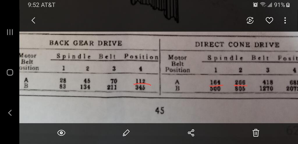

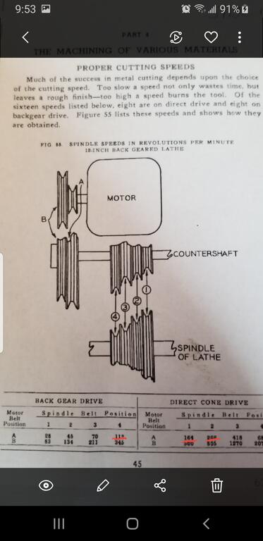

gt14rider 1,278 #6 Posted January 26, 2023 (edited) Here are my speed options, I did cut a keyway at 112, seemed slow, what's your choice. 340 seems high agreed. I know enough to hert myself or break things. Thanks Edited January 26, 2023 by gt14rider Share this post Link to post Share on other sites

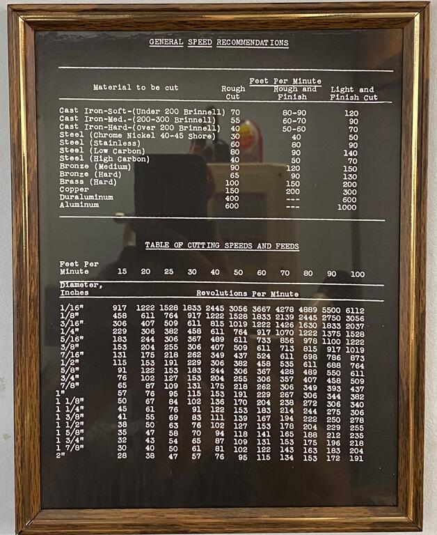

lynnmor 9,042 #7 Posted January 26, 2023 (edited) Can't you use the B position for some reason? I would use the 211 if possible. If not, I would use the 164. Here is a chart that served me well for half a century: Edited January 26, 2023 by lynnmor 1 Share this post Link to post Share on other sites
gt14rider 1,278 #8 Posted January 26, 2023 Will give it a shot, B pulley was broken when I got the lathe but will get a replacement. 211 i will give it a try. Thanks I'm sure that I'll have more questions. Share this post Link to post Share on other sites

Rick3478 469 #11 Posted January 28, 2023 On 1/26/2023 at 3:42 AM, lynnmor said: Be careful with that setup, climb milling may grab and suddenly pull the axle into the cutter causing breakage. It would be best to plunge into the axle and feed towards the axle end. Agree, also you are using a lathe for something that would normally be done with a mill, so be very careful as the lathe cross feed is not nearly as rigid or strong as a mill's main table. 1 Share this post Link to post Share on other sites

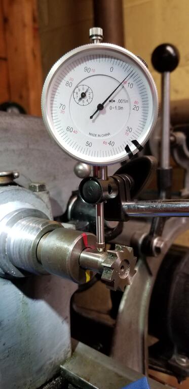

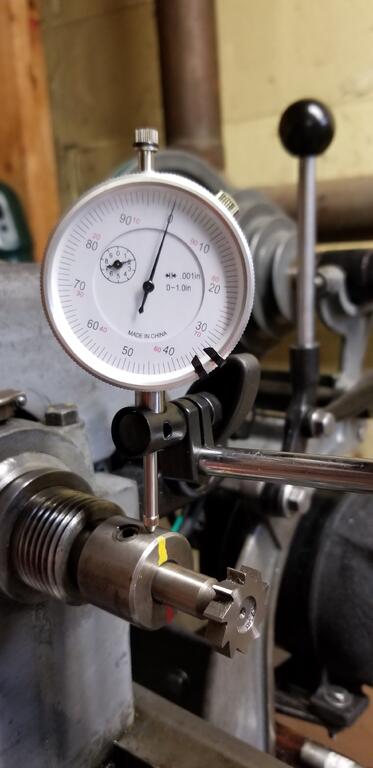

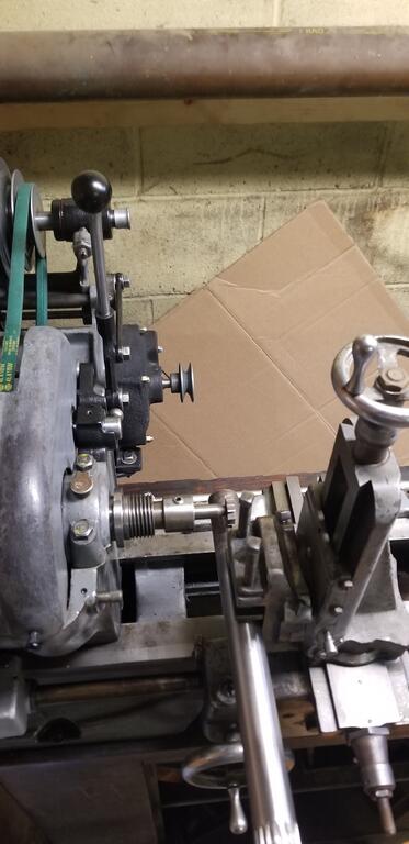

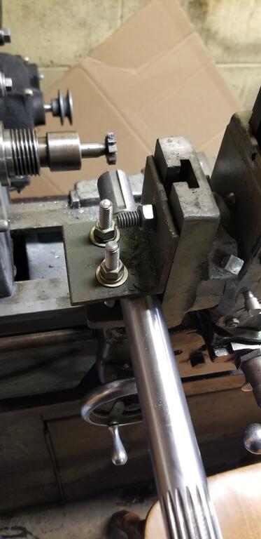

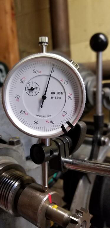

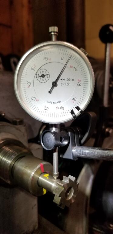

gt14rider 1,278 #12 Posted January 29, 2023 Cleaned arber and spindle 1st, 2nd pic 0 run out arber. 3nd and 4th pic before and after cleaning So after cleaning .004 run out. How would one get a cutter sharpened? 1 Share this post Link to post Share on other sites
ri702bill 13,084 #13 Posted January 29, 2023 We have several sharpening services in the RI-MA area; there used to be a lot more. You need to find one that has the correct fixturing to regrind cutters like endmills (most of the services now just deal with culinary knives and sawblades) The downside - turnaround time is about a week and the cost can be 1/3 that of a new cutter. The upside - a properly reground endmill will cut like new and will be .010 to .020 undersize in diameter. Perfect to hog out keyways in a milling machine and then do the finish size cut with a different sharp new cutter.... 1 1 Share this post Link to post Share on other sites
lynnmor 9,042 #14 Posted January 29, 2023 Since the arbor has a set screw it will push the shank to the opposite side, any play in the hole will cause run out. Loosen the screw and see how much the shank moves the indicator as you move it up and down, it does appear that the setscrew is pushing the shank to one side. Also, try indicating inside the hole if you have an indicator that can do that. Your run out may be a combination of things and not just a cutter problem. Some run out of the cutter really isn't much of an issue anyway, just feed slower since fewer flutes are doing the work. 1 Share this post Link to post Share on other sites
