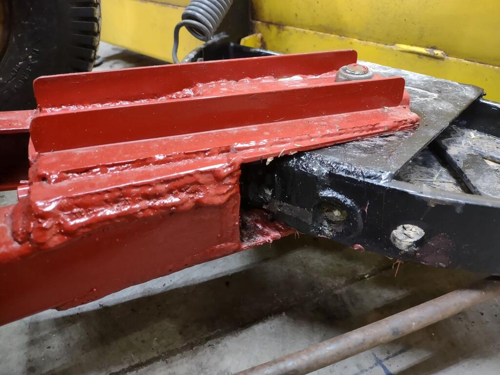

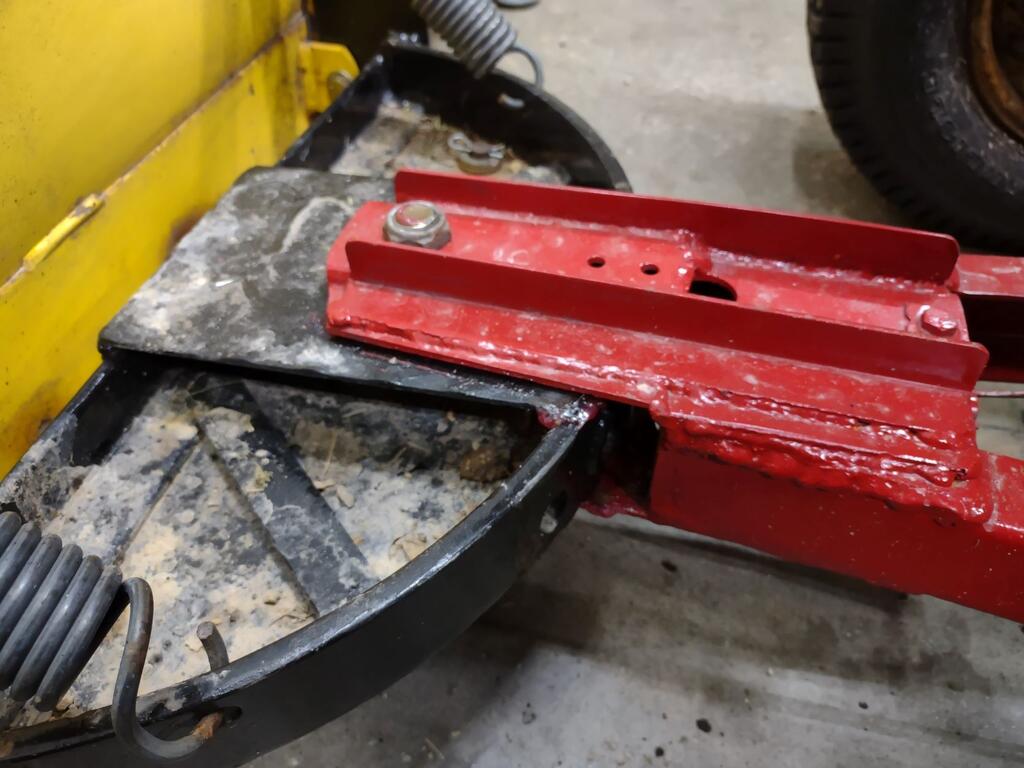

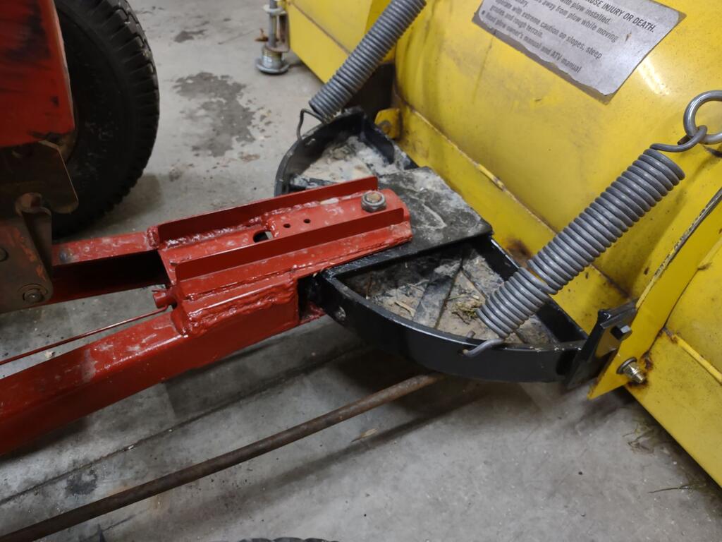

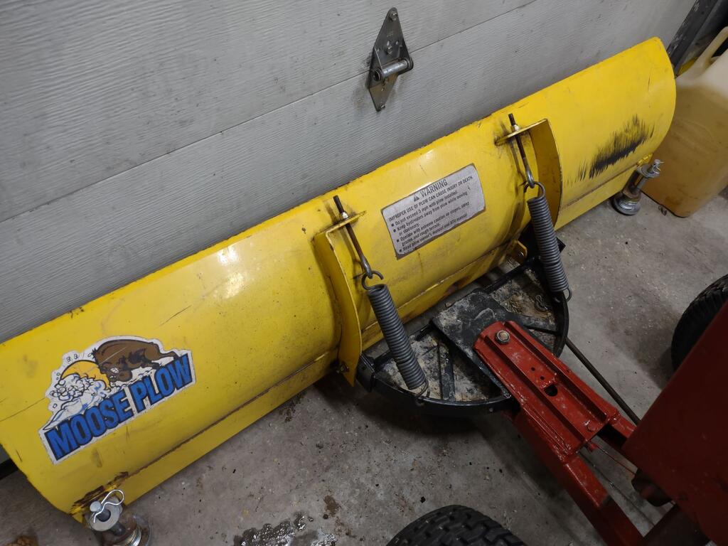

Achto 32,843 #1 Posted January 26, 2023 (edited) What do you get when you cross a Horse with a Moose??? A pretty good snow plow set up that's what. A friend of mine wanted a wider plow for his C195. To accomplish this on a budget he did a very good job of fitting a Moose ATV plow on to a plow frame. I was very impressed & thought that some of you might like to see the results. He had to add a little metal to the mount for the frame and the swing mount for the plow. The radius of the Moose plow mount did not match well with the frame so he had to add some metal to get the lock pin to work when angled. The plow swings as it should without leaving the comfort of the seat. A very nice addition to his "unstoppable" tractor. Edited January 26, 2023 by Achto 9 14 1 Share this post Link to post Share on other sites
OutdoorEnvy 1,817 #2 Posted January 26, 2023 That looks like it will do the job! Nice work! So is it a 60 or 72” plow blade? Thinking the C195 would handle a 72” possibly? 2 Share this post Link to post Share on other sites
Achto 32,843 #4 Posted January 26, 2023 (edited) 29 minutes ago, OutdoorEnvy said: Thinking the C195 would handle a 72” possibly? I Think he said that it is a 72", he says the tractor has no problem pushing big piles around. Edited January 26, 2023 by Achto 3 Share this post Link to post Share on other sites
ebinmaine 80,933 #5 Posted January 26, 2023 6 minutes ago, Achto said: It is a 72", he says the tractor has no problem pushing big piles around. Excellent!!! The 72" will be no issue. My 60"+ blade ala @wallfish has been a great addition to our snow moving arsenal. 2 Share this post Link to post Share on other sites
peter lena 10,090 #6 Posted January 26, 2023 @Achto you can spring load those blade end sliders , for easier working , how does that steering quadrant , slide pin work ? red grease and hand lever tightening / detailing makes it work easier with that spring that pulls it , like a rifle bolt . pete 1 Share this post Link to post Share on other sites
peter lena 10,090 #7 Posted January 26, 2023 @Achto forgot about the lubrication spray down on the blade face , slicker than snot , makes that angle plowing a real blast . pete 3 Share this post Link to post Share on other sites

peter lena 10,090 #12 Posted January 26, 2023 @Achto that would also be a good upgrade to male/ female heim end joints on a threaded rod for direction swing , 1/2" or bigger , instead of wallowing out those mount holes . pete 1 Share this post Link to post Share on other sites

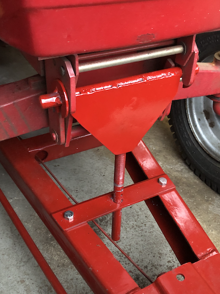

Handy Don 17,561 #13 Posted January 26, 2023 4 hours ago, ebinmaine said: @WVHillbilly520H sent a side movement limiter to me a few years back. It locks into the front attach-o-matic. That would be a great addition. I just made one to install on my son’s 312-H this weekend based on some ideas from @Ed Kennell. Right now gray primed, but it’ll be red when it goes on! Pics once painted and on! 2 Share this post Link to post Share on other sites

Handy Don 17,561 #16 Posted January 31, 2023 On 1/26/2023 at 9:09 AM, Handy Don said: I just made one to install on my son’s 312-H this weekend based on some ideas from @Ed Kennell. Right now gray primed, but it’ll be red when it goes on! Pics once painted and on! Done and installed. Keeps lateral plow frame movement to ±0.25" 1 2 Share this post Link to post Share on other sites
ri702bill 13,190 #17 Posted January 31, 2023 7 minutes ago, Handy Don said: On 1/26/2023 at 9:09 AM, Handy Don said: I just made one to install on my son’s 312-H this weekend based on some ideas from @Ed Kennell. Right now gray primed, but it’ll be red when it goes on! Pics once painted and on! Done and installed. Keeps lateral plow frame movement to ±0.25" Don - the plow frame lifts in a slight arc, hinged at the Unidrive. Does the quick mount give it enough pivot & wiggle to move freely?? Share this post Link to post Share on other sites
Handy Don 17,561 #18 Posted January 31, 2023 (edited) 25 minutes ago, ri702bill said: Don - the plow frame lifts in a slight arc, hinged at the Unidrive. Does the quick mount give it enough pivot & wiggle to move freely?? Yes, it does. We mounted the frame crosspiece about 1.5” foward from where the downrod would be in contact with the Attach-a-Matic’s locking rod to be sure the downrod would have fore and aft play. Tested with it clamped in place before drilling! My son quipped that the plow-mounted bracket will have friction wear. “Yep.” I answered, “In 30 years that’ll be your problem." Edited January 31, 2023 by Handy Don 2 Share this post Link to post Share on other sites

ebinmaine 80,933 #24 Posted January 31, 2023 1 minute ago, ri702bill said: Yassah!!! And, it's got that built in wiggle ability..... Here's the plow stabilizer I'm going to be using I'm fairly sure that rod is smaller than the steering column but I think I'll order up one of those bearings that fits this piece. 1 1 Share this post Link to post Share on other sites
ri702bill 13,190 #25 Posted January 31, 2023 Look at Don's version - right down the middle. Plenty of room to cleanly mount a bearing. Yours may be an issue - wider plate, mount front to back??? 1 Share this post Link to post Share on other sites
