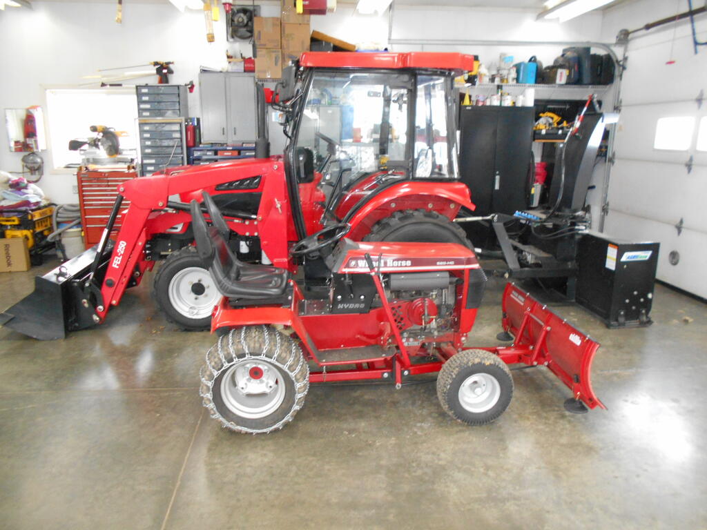

cleat 8,747 #22 Posted March 7, 2023 (edited) My larger tractor has a differential lock pedal as well as independent brakes that go a long ways to get you out of difficult situations. It is 4x4 as well but that is a different story. Funny thing is that my larger tractor is a gear drive with a shuttle shift giving 8 forward and 8 reverse speeds where all my wheel horses but one (the Work Horse) is hydro. Edited March 7, 2023 by cleat 1 1 Share this post Link to post Share on other sites
