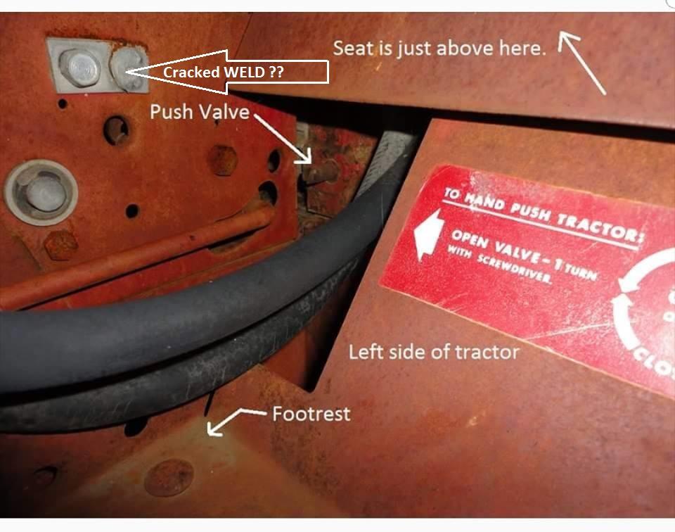

daveoman1966 3,882 #3 Posted January 18, 2023 If that TOW/PUSH VALVE (relief valve) hasn't been opened...for about 50 years... it WILL be very difficult to free it. The threads of the valve will be rusted.... and that's why it is stuck tight. see pic. I've struggled with these before... some success, some not. Try to get a small set oof VISE GRIPS on the stem of the valve. To do that, you'll need to remove the footrail and get the hoses out of the way. Even with that, there is still little clearance to get the vise grips LOCKED on to the stem TIGHTLY. MAYBE the mechanics old trick of heating the valve, then melting some candle wax onto it...drawing the wax to the threads...will help...don't know. 3 Share this post Link to post Share on other sites

Ed Kennell 45,796 #6 Posted January 18, 2023 I've had success opening a few by using a small 8" pipe wrench. Like Dave said, you need to remove some tin and the wheel to get access. Try closing it then opening and repeat many times. Share this post Link to post Share on other sites

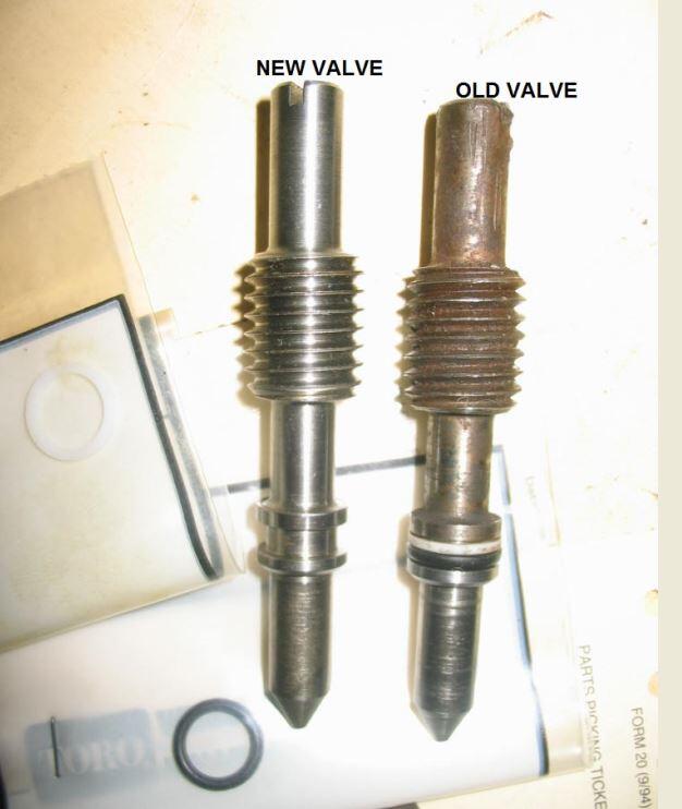

daveoman1966 3,882 #17 Posted January 18, 2023 The part# of the TOW VALVE is 103460... but is marked as NLA. ...Yoy MAY be able to source a used one as it is common to Sundstrand models 90-1136, 90-1137, 90-1140 in the 'B-100 auto' and C' automatics that use SUNDSTRAND. I just happend to have this one on-hand a couple years ago. 1 Share this post Link to post Share on other sites
ebinmaine 78,353 #18 Posted January 19, 2023 16 hours ago, daveoman1966 said: The part# of the TOW VALVE is 103460... but is marked as NLA. ...Yoy MAY be able to source a used one as it is common to Sundstrand models 90-1136, 90-1137, 90-1140 in the 'B-100 auto' and C' automatics that use SUNDSTRAND. I just happend to have this one on-hand a couple years ago. Do we know if the o-ring is a Standard Part ? Looks like 2 stacked? Share this post Link to post Share on other sites
pfrederi 20,302 #19 Posted January 19, 2023 (edited) It is an O ring and Plastic backer. All my hydros are old style top tow valves. I reuse the plastic ring and out in a new Oring (I believe yours would use Dash #012) Edited January 19, 2023 by pfrederi 1 Share this post Link to post Share on other sites
