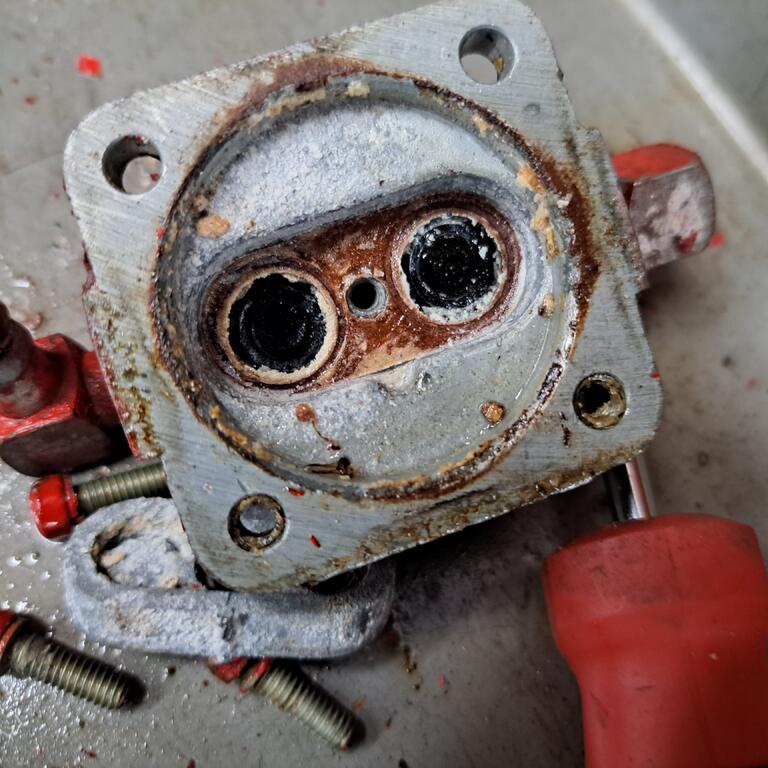

WHX?? 58,388 #51 Posted January 31, 2023 Yep this wasn't gonna work...cleaned up and running good now. This was the offset lever style. On to other issues. 3 2 1 Share this post Link to post Share on other sites

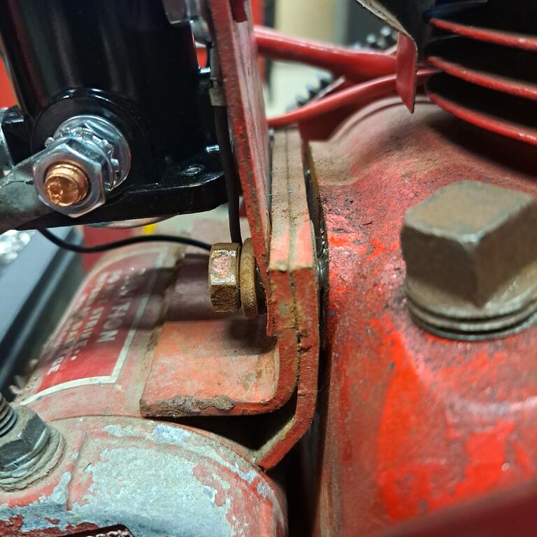

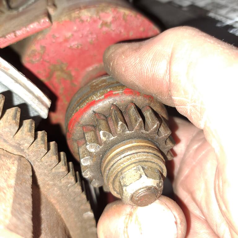

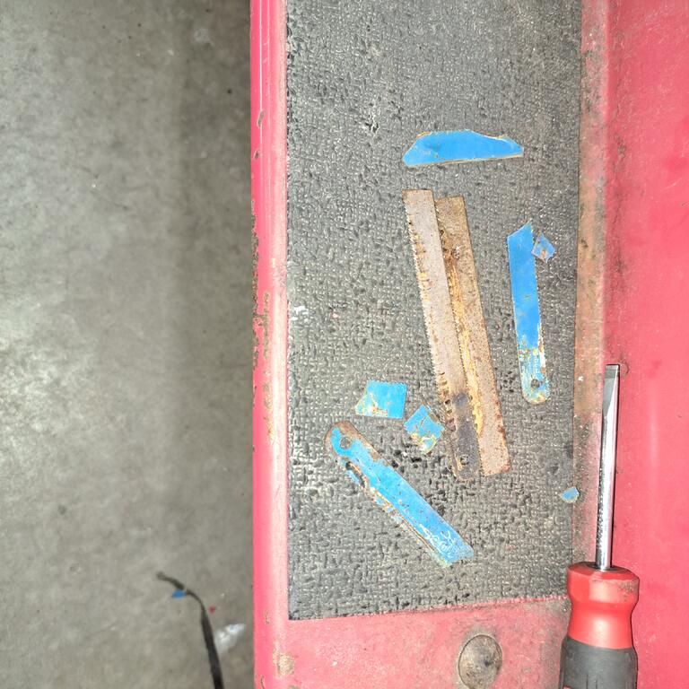

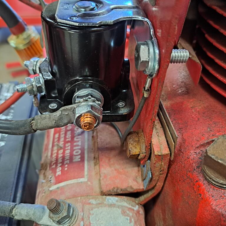

WHX?? 58,388 #52 Posted January 31, 2023 (edited) I noticed this when replacing the solenoid. Shims behind the starter and coil mount. From the seen it all files... hacksaw blades??? Here's why. Bendix isn't even close to ring gear. Any thoughts why? Teeth don't look all that worn. Wrong Bendix gear? Edited January 31, 2023 by WHX?? 2 2 Share this post Link to post Share on other sites
ebinmaine 81,289 #53 Posted January 31, 2023 Wrong starter? Bent starter mount flange? Wrong gear of course as stated... Is wrong flywheel a thing (??) You got another K181 to pop a starter off? 2 1 Share this post Link to post Share on other sites

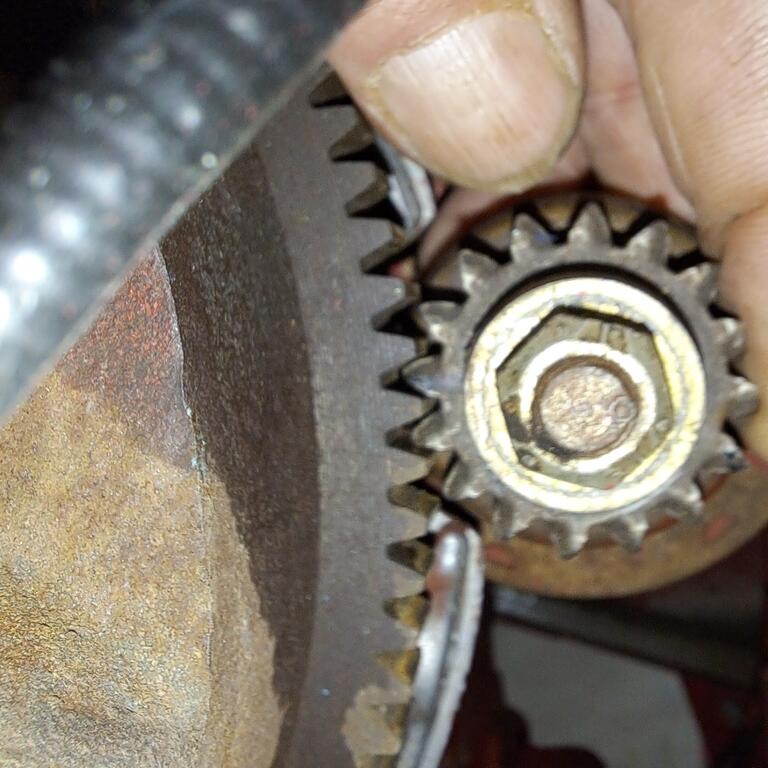

Handy Don 17,740 #54 Posted January 31, 2023 2 hours ago, WHX?? said: I noticed this when replacing the solenoid. Shims behind the starter and coil mount. Here's why. Bendix isn't even close to ring gear. Any thoughts why? Teeth don't look all that worn. Wrong Bendix gear? My first impression is that the teeth on the starter and flywheel do not seem to have the same pitch--could be the photo angle, though. The flywheel seems to be the right diameter using the bearing plate as a reference so... I’ll go with wrong bendix gear! 2 1 Share this post Link to post Share on other sites

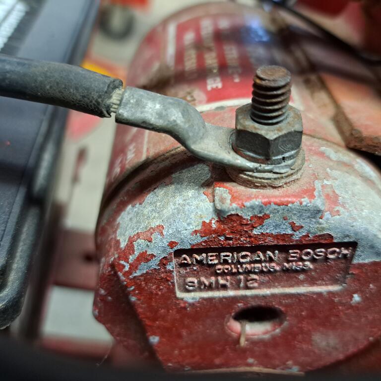

WHX?? 58,388 #55 Posted January 31, 2023 (edited) 2 hours ago, ebinmaine said: Wrong starter? Bent starter mount flange? Wrong gear of course as stated... Is wrong flywheel a thing (??) You got another K181 to pop a starter off? Appears to be original Bosch starter. Starter mount looks OK and pretty stout. Tuff to bend that. No only other starter I have like this is on a '68 Raider 12. Was hoping some had one to measure or count teeth on. This one has 16 teeth. Just the pic Don they mesh fine. Edited January 31, 2023 by WHX?? 4 Share this post Link to post Share on other sites

WHX?? 58,388 #57 Posted January 31, 2023 (edited) Then again @Handy Don maybe you are right? Edited January 31, 2023 by WHX?? 2 Share this post Link to post Share on other sites
WHX?? 58,388 #58 Posted January 31, 2023 Wrong starter I 'm beginning to think ... IPL says it should be a United Technologies Kohler 41 098 01 1 Share this post Link to post Share on other sites
Achto 32,964 #59 Posted January 31, 2023 43 minutes ago, WHX?? said: I'm guessing the mount got bent some how, hence the saw blade shims. May be put the starter in the vise, warm the mount up, & bend it back in shape?? Or... jamb the saw blades back in and run 'er. 3 Share this post Link to post Share on other sites
WHX?? 58,388 #60 Posted January 31, 2023 3 minutes ago, Achto said: Or... jamb the saw blades back in and run 'er. May just come to that... 2 Share this post Link to post Share on other sites
Achto 32,964 #61 Posted January 31, 2023 Check the mount with a square, if it is supposed to 90 degrees it sure don't look it. 3 Share this post Link to post Share on other sites
squonk 48,429 #62 Posted January 31, 2023 11 minutes ago, Achto said: I'm guessing the mount got bent some how, hence the saw blade shims. May be put the starter in the vise, warm the mount up, & bend it back in shape?? Or... jamb the saw blades back in and run 'er. He's going to have to find stainless steel blades! 5 Share this post Link to post Share on other sites

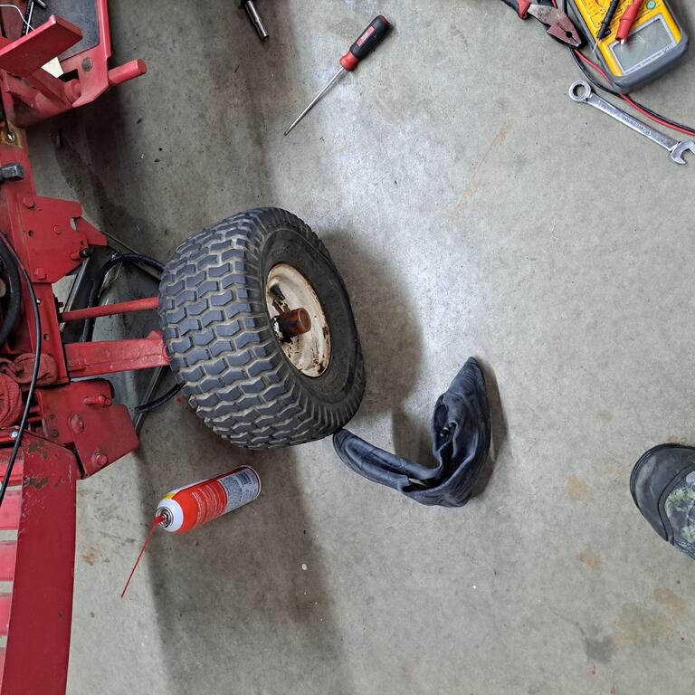

WHX?? 58,388 #67 Posted February 1, 2023 Today's work on her...tube the fronts. 4 1 Share this post Link to post Share on other sites
ebinmaine 81,289 #68 Posted February 1, 2023 1 hour ago, WHX?? said: Today's work on her...tube the fronts. Do you have a half decent method of holding the wheel in place? Along with a good volume of classic expletives lined up ready to go? 3 Share this post Link to post Share on other sites
WHX?? 58,388 #69 Posted February 1, 2023 3 hours ago, ebinmaine said: Do you have a half decent method of holding the wheel in place? Horror fright mini changer the best i can do. 3 hours ago, ebinmaine said: a good volume of classic expletives lined up ready to go? Ain't that the truth. So I get one bead off to find the inside of the rim needs to cleaned up so the tire has to come off. Six inch rims should be outlawed. 2 1 Share this post Link to post Share on other sites
squonk 48,429 #70 Posted February 1, 2023 I see the voltmeter. How many microamps is needed to get the tube in? 6 1 Share this post Link to post Share on other sites

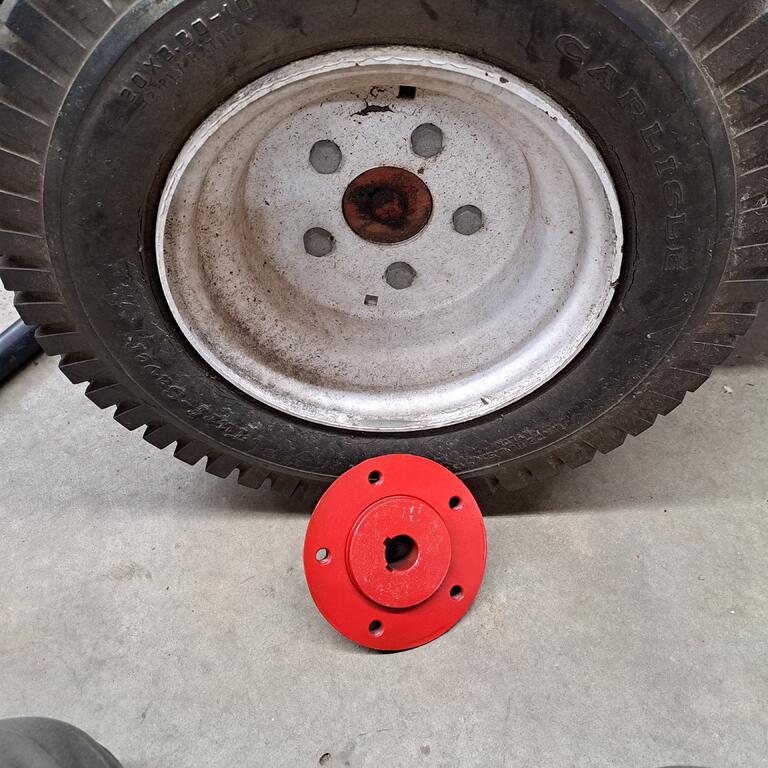

WHX?? 58,388 #71 Posted February 2, 2023 (edited) 3 hours ago, squonk said: I see the voltmeter. How many microamps is needed to get the tube in? None if yer gonna come and deal with 6 inch rims... you'll sally out Yer right @ebinmaine ... taught myself some new French just getting one off. Decided well if the Pullhosen @Pullstart has some 12" rims and wants to trade for these 10's I'll just put some eights on the front. Worked to keep it a roller anyway. One thing I did finger out tho is hubs for a 10" rim have a different center diameter than 12's ??? Edited February 2, 2023 by WHX?? 4 1 2 Share this post Link to post Share on other sites
squonk 48,429 #72 Posted February 2, 2023 I see its a UEI. " You Electrocute Individuals! " 2 Share this post Link to post Share on other sites
Pullstart 71,571 #73 Posted February 2, 2023 1” axles Uncle Jim? We need to make it a package deal and trade hubs too? 1 Share this post Link to post Share on other sites
Darb1964 1,176 #74 Posted February 2, 2023 On 1/31/2023 at 6:47 PM, Achto said: Check the mount with a square, if it is supposed to 90 degrees it sure don't look it. On 1/31/2023 at 6:47 PM, Achto said: Check the mount with a square, if it is supposed to 90 degrees it sure don't look it. I think the plate should go behind the starter bracket. 2 1 Share this post Link to post Share on other sites
Handy Don 17,740 #75 Posted February 2, 2023 6 minutes ago, Darb1964 said: think the plate should go behind the starter bracket. That would put the starter even further from the flywheel. 3 Share this post Link to post Share on other sites
