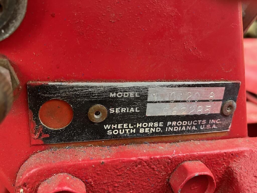

Sparky-(Admin) 25,934 #26 Posted January 18, 2023 11 hours ago, Achto said: Jim wanted me to add the ID tag for this tractor to this post. 1-0120 1973 Lawn & Garden Tractor 8 hp 4 Speed 4-Speed Kohler K181S-30461D 8Wheel Horse 5085 2 1 Share this post Link to post Share on other sites

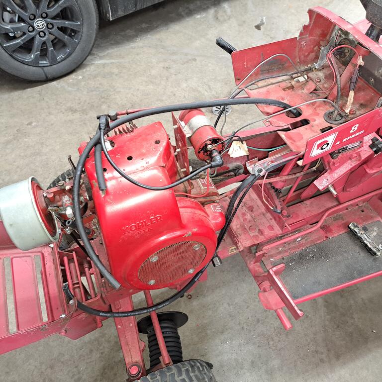

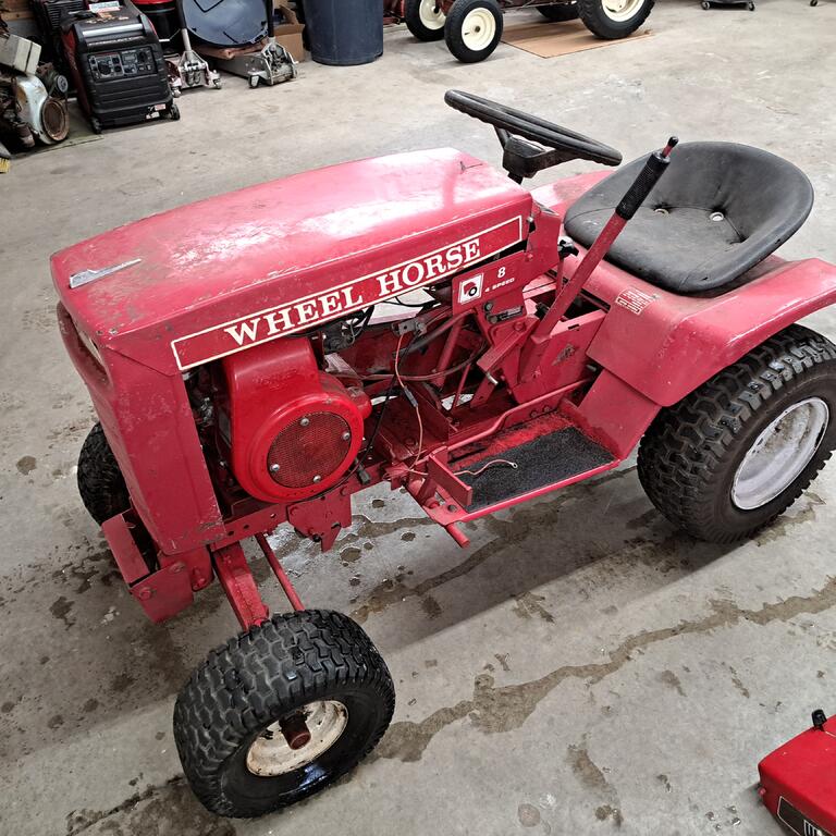

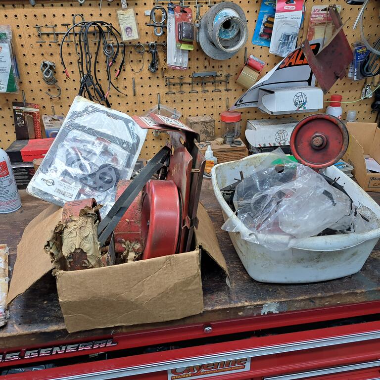

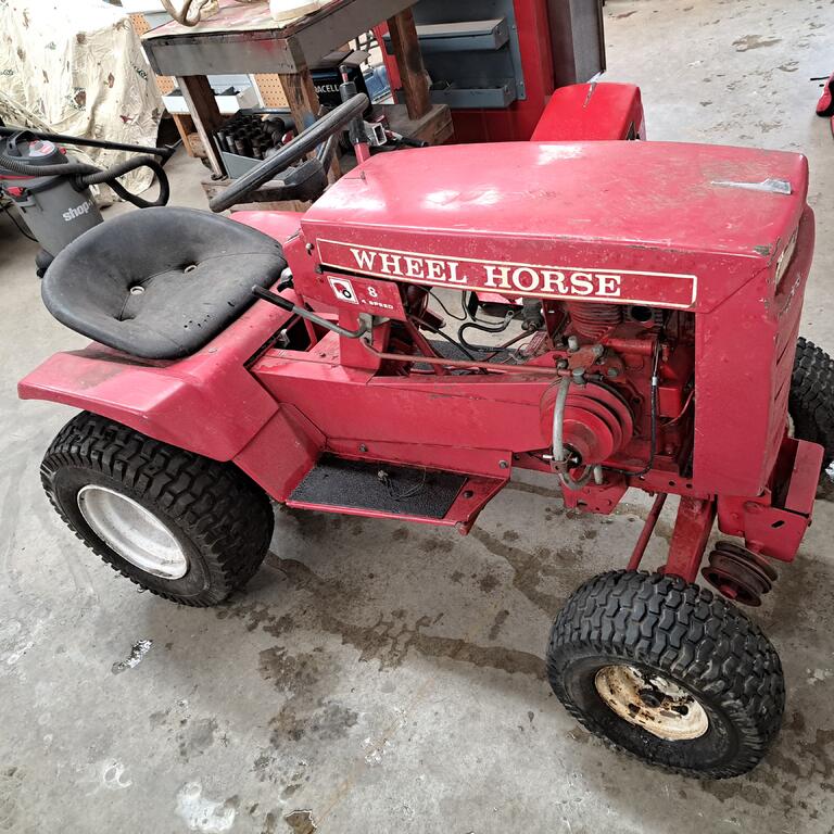

WHX?? 57,384 #30 Posted January 28, 2023 (edited) Got her home today. I usually don't name my tractors but she came with two big boxes of parts and one had a tank stand for a C-160 and a B-80. So no more no name... she's Aunt B... Overall she's in pretty good shape. No gas tank and some other minor stuff. Nothing a trip out to the magic parts shed won't fix. Pop the head off tomorrow and other wrenching and the new to me list. See what this "rebuild" looks like. Go thru those boxes and see what shakes. Looks to be both horse parts and others. The gasket set is for a sweet 16. Edited January 28, 2023 by WHX?? 5 3 Share this post Link to post Share on other sites

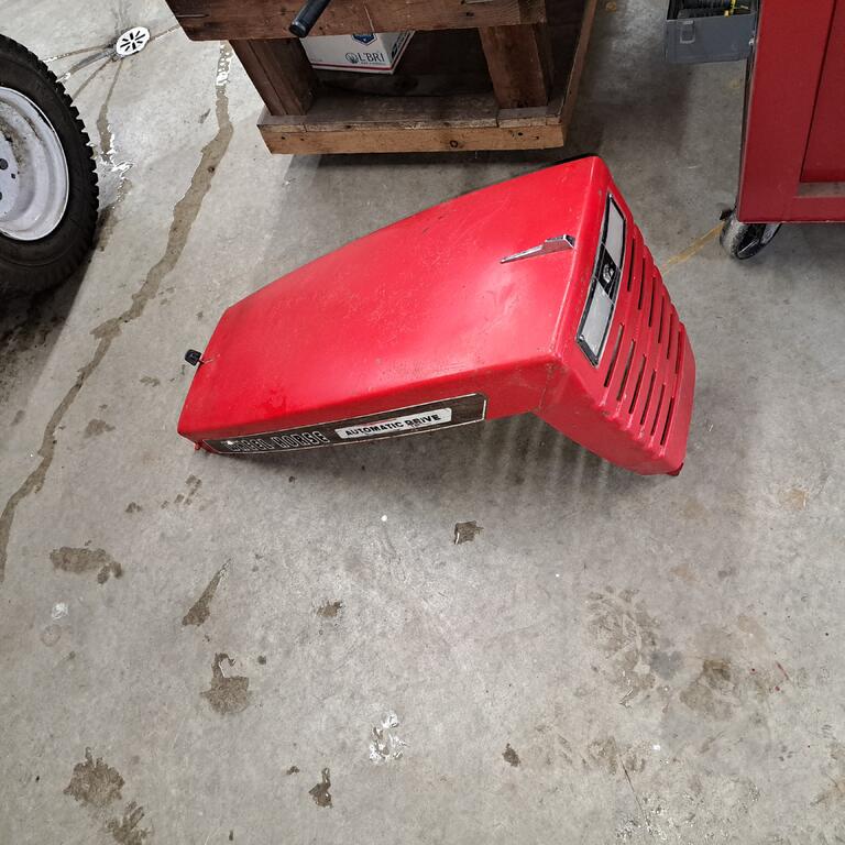

WHX?? 57,384 #31 Posted January 28, 2023 Bonus hood... looks like the hood collection got added to @Pullstart Me thinks the seller was trying to clean out his parts on me. I can live with that. Really good shape and strait. Off a long frame hydro... 10 or 1277? 5 1 1 Share this post Link to post Share on other sites
Achto 32,095 #32 Posted January 28, 2023 Awesome score!!! All for a Benny? 2 Share this post Link to post Share on other sites
WHX?? 57,384 #33 Posted January 28, 2023 Yep... & a nice RD 36 deck. Shell in real good shape. Missing some things as well but nothing major and certainly not a deal breaker. 2 1 Share this post Link to post Share on other sites

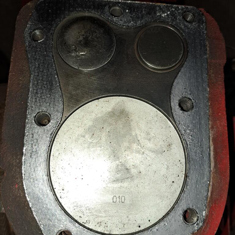

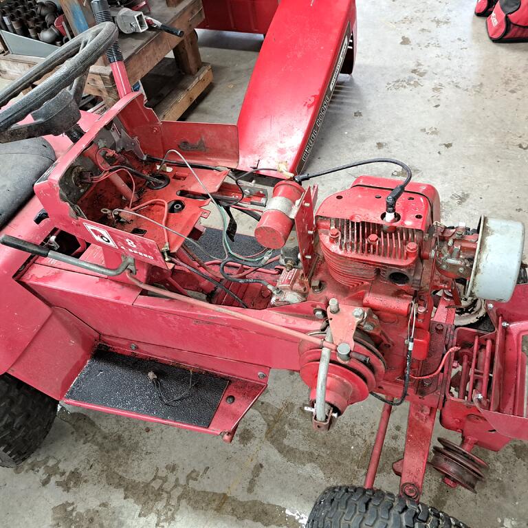

WHX?? 57,384 #35 Posted January 28, 2023 (edited) Looks like it's been rebulit but never saw fire. Bore looks fresh valves ground or at least lapped. Points pitted and never set & no wire from points to coil. Appears to me no one ever tried to fire it after rebuild. Points in Terrible shape but cleaned up and throw a new condenser at her. Working on fuel line and wiring now. Edited January 29, 2023 by WHX?? 4 5 Share this post Link to post Share on other sites

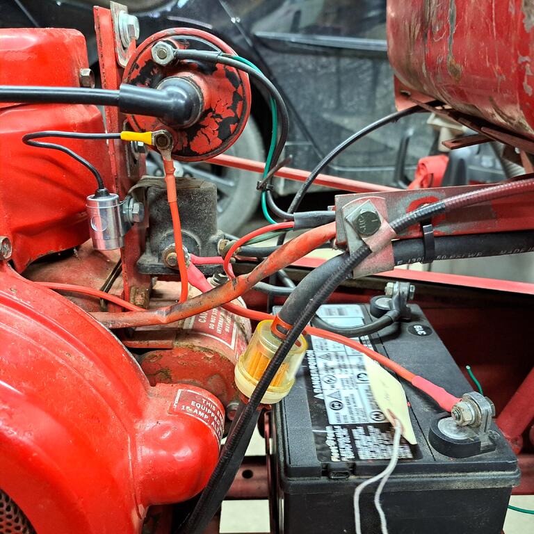

WHX?? 57,384 #36 Posted January 29, 2023 Update ... Got a little bit done between $crewin the pooch and chores. A plastic C-160 tank will not fit but older metal ones do with minor mods and plumbed. What condenser? There was none .. there is now. Might have got lost in the rebuild? Abit more wiring to get sorted and might be ready for fire. Dan says I should drop the float bowl.... damn him I know he's right! A guy has got to wonder why someone would go thru the trouble and expense of a rebuild but then never finish? Life got in the way I suppose. 3 3 Share this post Link to post Share on other sites

WHX?? 57,384 #43 Posted January 30, 2023 Got the wiring done. Crap... solenoid bad. 3 3 Share this post Link to post Share on other sites
ineedanother 2,579 #44 Posted January 30, 2023 14 minutes ago, WHX?? said: Got the wiring done. Crap... solenoid bad. Looking good, and doesn't there always seem to be something else left to do? On another note and it may be a non-issue if you don't ever spray you motor down, but you really never want water to lay on the business end of the condenser. If the wire has enough length, you might want to flip it over when you install the new solenoid 4 1 Share this post Link to post Share on other sites
ebinmaine 79,642 #45 Posted January 30, 2023 6 hours ago, WHX?? said: Got the wiring done. Crap... solenoid bad. No worries Jim. I've gotten in the habit of bench testing those or even just replacing the older ones. 2 Share this post Link to post Share on other sites
WHX?? 57,384 #46 Posted January 30, 2023 3 hours ago, ebinmaine said: No worries Jim. I've gotten in the habit of bench testing those or even just replacing the older ones. Yep ... shoulda been tipped off by another used one in the boxes of parts that came with it but it looks questionable so will pick up a new one at napa today. 3 Share this post Link to post Share on other sites

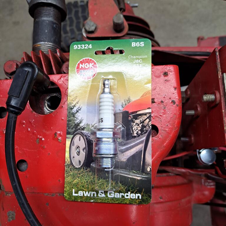

WHX?? 57,384 #47 Posted January 31, 2023 (edited) Got it turning over and running on sniffing choke cleaner... actually had it running on her own for abit but now nothing. When i had the head off i lubed the bore abit for not a dry start. Lack of fuel I suspect and pump issues. Pull that apart and a full carb cleaning instead of just a bowl wipe out. Sorry @Achto... I have failed you! Switched teams on the plug. Only cause FF did not have a J8 in Chomponion... go figure. Like this plug better anyway. Nice bright fire. Tire valve stem rack was completely empty. Yah... supply chain issues. WTF? Flipped the condenser per @GAJoe and fitted my analness perfectly. Thank you sir. 😊 Edited January 31, 2023 by WHX?? 6 Share this post Link to post Share on other sites
