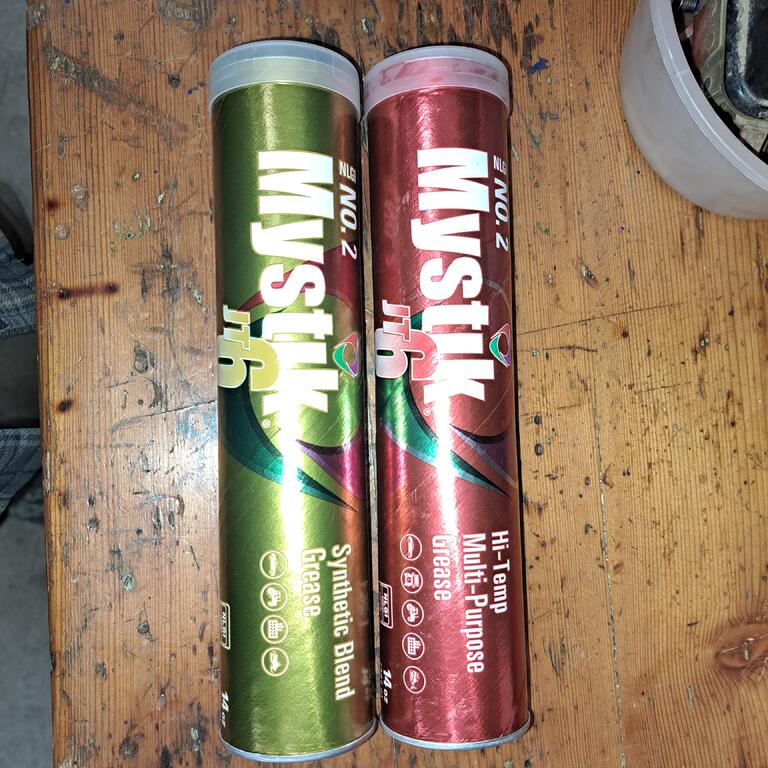

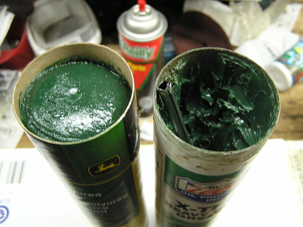

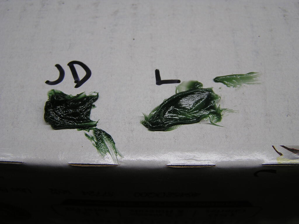

ri702bill 13,399 #1 Posted January 14, 2023 All: We are all well aware the our beloved Lucas X-tra Heavy Duty Green Polyurea Grease is no longer readily available unless you are willing to pay a scalping premium for it. I conferred with our local Grease Guru, @peter lena, aka Slippery Pete on what I found as a possible short term substitute, although it it is not the exact formulation. He agrees it is NOT the same - not surprized as both are manufactured by separate companies to the specification given them by the seller. OK - here goes - don't kill me, Im just the messenger...... Seems the John Deere sells their version of a green Polyurea premium grease that is readily available and "reasonably" priced. The larger quantity ordered, the better the price. I took pictures of both the products and the labeling for comparison. By its makeup, polyurea grease does not play well with lithium based greases - the spec sheets for both say so. They do play well with each other though since they share the same base. They do both carry the highest Lubrication and Grease Institute rating - both are premium greases. The difference is in the working temperature ranges - the Dropping Point for the Lucas is 580 degrees F, the John Deere TY6341 is 380 degrees F. Both would be fine, in my opinion, for low speed applications like front axle pivot and slindles, along with lower steering components. My only area of concern is the high RPM bearings on cutting deck spindles and snowblower augers. I recall the slindles being warm after use in July, but not to the point of sizzle and fizzle when washed down. I actually called John Deere's Tech Support 800 number to ask if there were any Technical Service Bulletins issued specifying where their Polyurea grease should not be used. (Got nowhere on that - got shuffled over to a Customer Service Rep - explained my request - she offered no direct answers but two choices. I could ask the large regional JD service dealer for their opinion, or get this - fill out an email request on the main website for Tech Support and they would contact me AFTER I gave a credit card number - they charge for their Tech Support. No - I did not persue that. Yes, I know there those amongst us that would rather undure the thrill of either gargling double edged razor blades or being the recipient of a crushed glass enema before they consider using a JD product on their Wheel Horses. Your options are few: 1. Pay the scalper price for Lucas 2. Park your Ponies until Chemtool rebuilds after the fire and gets back into production.(IF they do continue to produce this product) 3. Do nothing - no more grease, just run them. 4, Dis-assemble all the greased components, flush them, switch over to a Lithium based grease. 5. Try a tube to grease your Mother-in-law's tractor. All jokes aside - if anyone can offer another worthy substitute, please add it to this post. Bill Pictures... 1 1 1 Share this post Link to post Share on other sites
WHX?? 58,388 #2 Posted January 14, 2023 At the risk of incurring the wrath of the slippery one ...what's wrong with the off the shelf farm & barn grease? 3 1 Share this post Link to post Share on other sites
ri702bill 13,399 #3 Posted January 14, 2023 (edited) @WHX?? - Jim, are either one of the Polyurea based?? I am looking for a compatible substitute. I got on the Mystik website - seems they do not offer a Polyurea based grease in their lineup...... Edited January 14, 2023 by ri702bill Share this post Link to post Share on other sites
