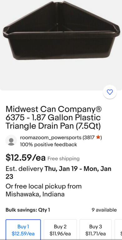

ebinmaine 79,297 #1 Posted January 13, 2023 Found these on the fleeeBay. Figured I'd share. Price is great. They feel pretty strong. Fit under a Horse. 4 Share this post Link to post Share on other sites

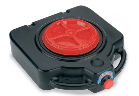

davem1111 2,279 #5 Posted January 14, 2023 I have one kinda like this that I've had for many years: Under the big lid is a plastic screen so drain plugs, wrenches, and oil filters won't fall into it. I don't know what the capacity is or where it was made, but I think I can drain 2 cars into it before I have to empty it. Very easy to pour off into another jug, or just take like this to the recycle center to empty into their barrel. 2 Share this post Link to post Share on other sites

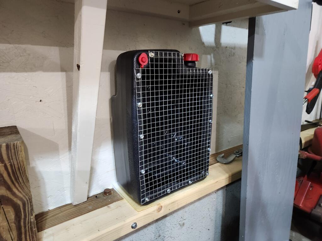

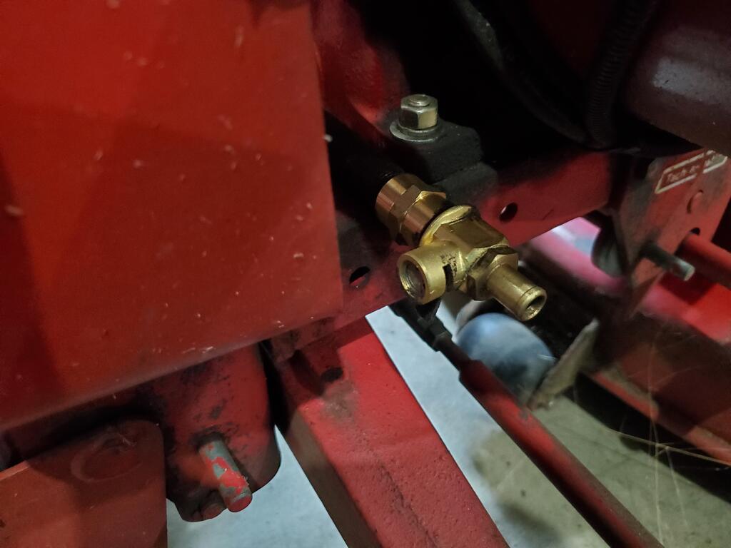

Racinbob 13,004 #10 Posted January 14, 2023 I use these whenever I can. A short piece of hose and drain right into a jug and off to recycling. I use this for the vehicles that I don't have a valve on. It was totally enclosed and tapered to a hole in the center. The problem was that the oil would splash all over. Not a problem with an open pan but I always dropped the drain plug into the pan of oil. Cutting the side out and screening it solved the problem. Easy to pour into another container. 2 Share this post Link to post Share on other sites

Brockport Bill 2,389 #16 Posted January 14, 2023 19 hours ago, ebinmaine said: Found these on the fleeeBay. Figured I'd share. Price is great. They feel pretty strong. Fit under a Horse. i just used that triangle shaped rubber tub -- because of its shape, 1 Share this post Link to post Share on other sites
Brockport Bill 2,389 #17 Posted January 14, 2023 the traingle shaped tub works well under rear axle because of its manuverability 2 1 Share this post Link to post Share on other sites

ebinmaine 79,297 #19 Posted January 14, 2023 5 minutes ago, Brockport Bill said: the traingle shaped tub works well under rear axle because of its manuverability That's a primary thing that I liked about it. 2 Share this post Link to post Share on other sites
