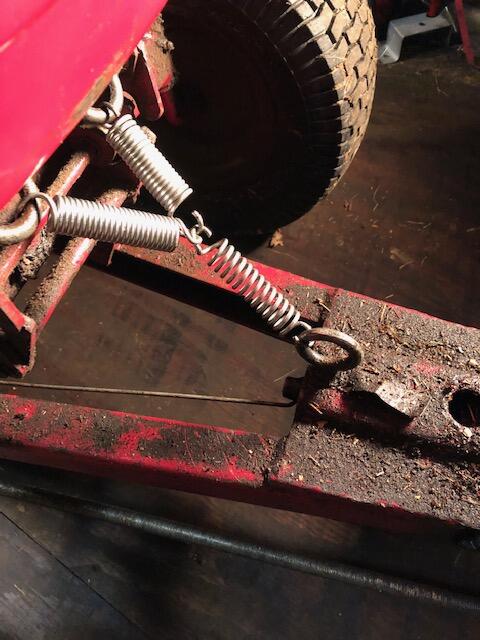

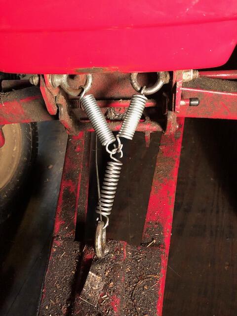

peter lena 10,090 #1 Posted January 8, 2023 with plows going on , its easy to relate to a heavy arm lift , without hydraulics , used my existing threaded lift eyes on the lower corners of my hood attachment points ,and also added a lift eye to the handy rear hole in the back of the quadrant area . having an assist , right at the weight area , makes it very affective. using 3" x 3/4 " extension springs , found these , just let the balde gently clean , yet make lifting much easier . you could also add a turnbuckle to this , for a dial it in perfect setting . add small shackles if you want . tightened up the spring ends to insure , no pop offs . arm lift ease is about 60/ 70 % lighter . that combined with a slick / smooth steering quadrant , makes for much easier operation . only a suggestion , have this set up on 2 horses , tried it on one , worked out the issues , and duplicated that on the other. you can't do that , pete 6 Share this post Link to post Share on other sites
peter lena 10,090 #2 Posted January 9, 2023 @ebinmaine was also thinking about a straight vertical lift from frame to plow frame , just enough to take the dead weight off the lift arm . a simple go to point , would let you experiment with springs . pete 1 Share this post Link to post Share on other sites
peter lena 10,090 #3 Posted January 9, 2023 @WHGuy413 often experiment with an idea , the unassisted lift arm set up is the issue , has to be easy to hook up , spring pull has to be just enough to make lift much easier , yet not hold it off ground . that was my TURNBUCKLE thought , with that on a vertical spring , you could dial in what you want . think the closer you are to the heavy / blade front , the more effective . have no issues at all with improving / enhancing what I do think a frame build up stage , in a restoration set up , would allow more idea areas . adding a lift eye is easy , don,t worry , I won,t tell you , that you can't do that . make it better , pete 1 Share this post Link to post Share on other sites
peter lena 10,090 #4 Posted January 9, 2023 @WHGuy413 look see without the , work gives you the possible lift areas , pete Share this post Link to post Share on other sites
