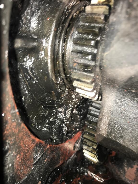

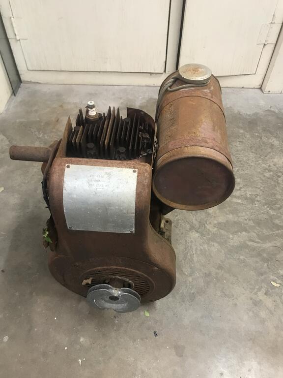

oliver2-44 11,632 #51 Posted February 2, 2023 On 1/7/2023 at 5:32 PM, Brockport Bill said: Was wondering if when people obtain engines with old "black" oil, if people do an engine oil "flush" with fresh oil, and then drain and then put in the "final oil"?? I know oil sits in the sump and can accumulate residue, shavings etc. So was thinking a "flush" with new oil, run engine to get warm, jack up front, -- then draining and put in final oil. Back to your original question about doing an oil flush on new to you/me engines. I was recently given a 1945 Wisconsin AEH. It had been sitting some number of years. This engine is a brother to the Wisconsin AEN used on the WH Seniors. The oil on the dipstick LOOKED GOOD. These engines have an oil plunger pump that lubes the crank rod journal. The pump plunger check ball can stick after setting awhile, so I opened it to check it. I wish I had taken an initial picture of the pump pickup screen and sump bottom. It was just full of old black sludge in all the corners and crevices. The picture below is after I had been cleaning awhile. The non-detergent oil was doing what it was designed to do. Let the sludge settle out. This engine would have benefited from several hot oil drains. Even after spraying solvent and getting it as clean as I could (without a full disassembly) I will still do a hot drain/flush after a few run hours. On the other end of the spectrum Modern detergent oils are designed to keep the contamination in suspension so the oil filter can remove it. I spent most of my career working at Hydro Dams with 1940-50 vintage equipment. All of it originally had no oil filters and used non-detergent oil. On yearly maintenance shutdowns the hot oil was drained to a large 1000-2500 gallon tank with a cone shaped bottom. This oil was allowed to “Rest” for a year. They had a full change of oil in a second similar tank. The ”Rested” oil was pumped to the unit from a tap above the cone. Every 5-10 years they pulled the side hatch on the tanks and the crew rookie got to swab out the settled sludge. 1 Share this post Link to post Share on other sites
