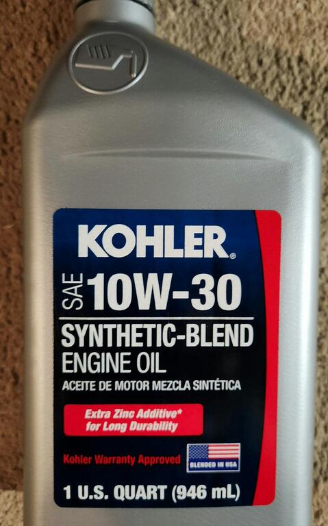

Brockport Bill 2,455 #1 Posted January 7, 2023 Was wondering if when people obtain engines with old "black" oil, if people do an engine oil "flush" with fresh oil, and then drain and then put in the "final oil"?? I know oil sits in the sump and can accumulate residue, shavings etc. So was thinking a "flush" with new oil, run engine to get warm, jack up front, -- then draining and put in final oil. I am using "winter" oil of synthetic Kohler 10w30 with zinc additive. 4 Share this post Link to post Share on other sites

Brockport Bill 2,455 #4 Posted January 7, 2023 18 minutes ago, lynnmor said: I have flushed dirty engines with cheap oil. The Kohler oil already contains the proper amount of zinc, adding more can make it acidic. i am not adding zinc -- the Kohler syn 10w30 comes with zinc additive 4 Share this post Link to post Share on other sites

lynnmor 9,012 #7 Posted January 8, 2023 34 minutes ago, Brockport Bill said: i am not adding zinc -- the Kohler syn 10w30 comes with zinc additive All motor oils have zinc, some more than others. When you said additive it appears as thou you were adding something. Share this post Link to post Share on other sites
Brockport Bill 2,455 #8 Posted January 8, 2023 56 minutes ago, lynnmor said: I have flushed dirty engines with cheap oil. The Kohler oil already contains the proper amount of zinc, adding more can make it acidic. here is the "zinc" oil i located recently - a prior thread from few weeks ago i read here provided excellent discussion about the zinc - - so after much searching i located the Kohler label oil -- i ordered 30w, and 10w30 - should provide the benefit to older Kohlers as has been discussed here on RSq. 1 Share this post Link to post Share on other sites
Brockport Bill 2,455 #9 Posted January 8, 2023 4 minutes ago, lynnmor said: All motor oils have zinc, some more than others. When you said additive it appears as thou you were adding something. i did lots of google work a few weeks ago to find the actual measurments of zinc -- and this was a formula higher than typical - - thanks for the insights 1 Share this post Link to post Share on other sites
lynnmor 9,012 #10 Posted January 8, 2023 3 minutes ago, Brockport Bill said: here is the "zinc" oil i located recently - a prior thread from few weeks ago i read here provided excellent discussion about the zinc - - so after much searching i located the Kohler label oil -- i ordered 30w, and 10w30 - should provide the benefit to older Kohlers as has been discussed here on RSq. Good deal, I have been using the same for a few years now. I did notice that the price went way up and there are considerable differences between suppliers. @ebinmaine found another brand that was fairly priced, maybe he can chime in about current pricing, brand and stores. I wouldn't doubt that it is the same oil with a different label. 3 Share this post Link to post Share on other sites
ebinmaine 80,289 #11 Posted January 8, 2023 12 minutes ago, lynnmor said: Good deal, I have been using the same for a few years now. I did notice that the price went way up and there are considerable differences between suppliers. @ebinmaine found another brand that was fairly priced, maybe he can chime in about current pricing, brand and stores. I wouldn't doubt that it is the same oil with a different label. Lyn the oil I found is called Kinetix. It was at the dealer where I bought the new commercial grade Ariens snowblower a few years ago. Used and recommended by them. Their price wasn't too bad and I found it available online by the case lot delivered to my house. We use either straight 30 or 10W30 depending on machine needs and season/temperature. 3 1 Share this post Link to post Share on other sites

lynnmor 9,012 #25 Posted January 10, 2023 Did you check the amount of zinc in other oils? I said before that they all have it, just some has more than others. ZDDP is in motor oil to reduce wear, I can’t imagine that there are any noticeable changes in the short run. 1 Share this post Link to post Share on other sites
