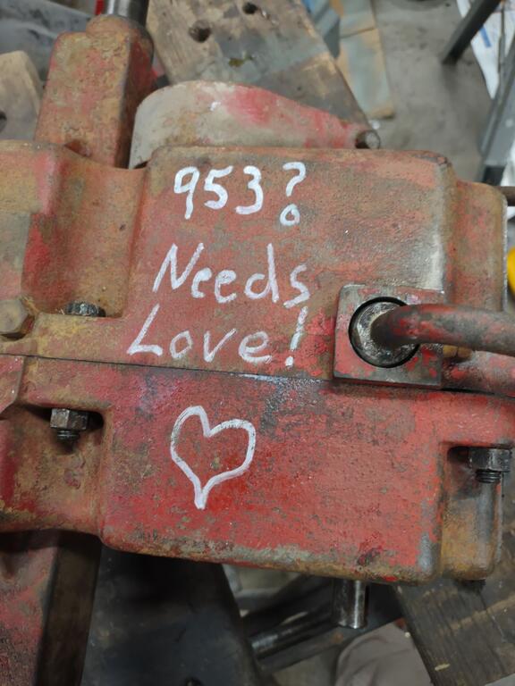

953 nut 70,663 #51 Posted February 14, 2023 10 hours ago, Achto said: No room for this. with the way the frame is designed for the hydro lift. When I put the six speed in "Hot Wheels" ,now owned by @Pullstart, fifteen or so years ago I drilled and tapped a hole in the transaxle mount to line up with the hole near the lift cylinder pivot. Had to slightly elongate another hole in the plate but don't remember which one. The case for the transaxle wass empty when I drilled and tapped it. 2 1 1 Share this post Link to post Share on other sites

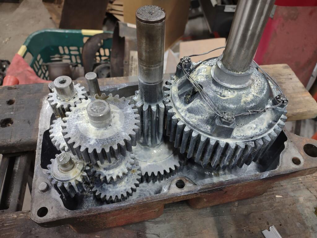

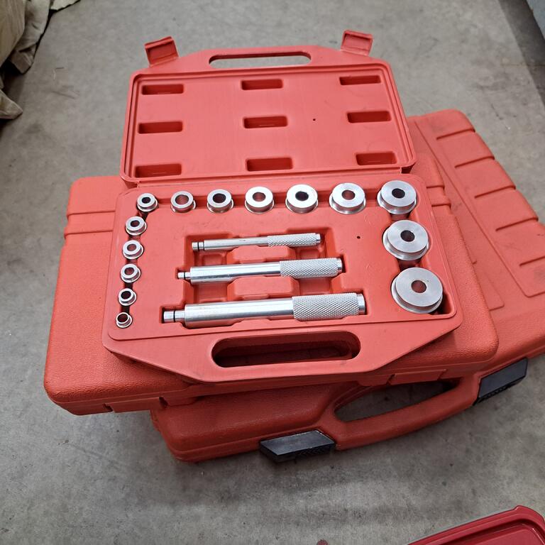

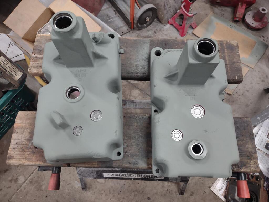

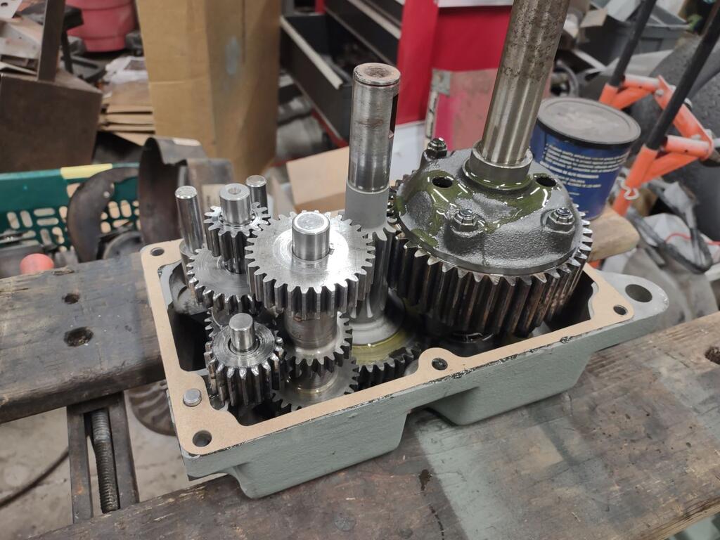

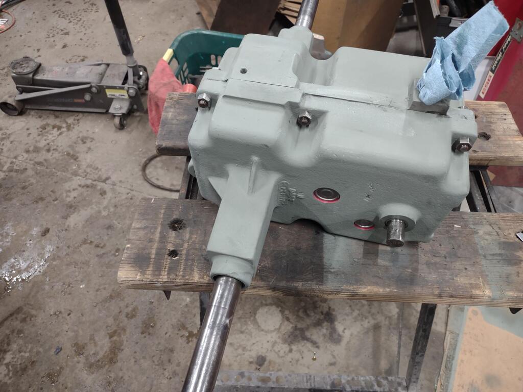

Achto 32,964 #52 Posted February 25, 2023 Tranny issues are over. A Special Thanks to @jeremi3210 for hooking me up with a good right hand case. I took a little drive up to his place last week to grab my much needed part. Was great to do some catching up with him. After some degreasing and a trip through the blast cabinet both halves received a couple of coats of self etching prime to keep rust at bay until I am ready to paint. This week I purchased a new addition to my tool arsenal. A bearing and seal driver kit with a very wide range of sizes. Got to try out my new toys this morning by installing all new bearing into the cases. Bearings in, time to stack some gears. All went pretty smooth other than dropping the detent ball down the hole 3 or 4 times. Finally was able to get enough sticky grease on the spring and my push rod tool to get it in place. All the bearings & gears got drizzled with some Lucas oil treatment (my favorite assembly lube) before the left hand case was installed. Buttoned up & ready for paint. The donor tranny also got put back together, mostly. I put the detent hard ware in a bag & stuffed it inside the tranny. The entire inside was soaked down with some white lithium lube to preserve it. Labeled for storage. 5 9 1 Share this post Link to post Share on other sites
WHX?? 58,388 #53 Posted February 26, 2023 3 hours ago, Achto said: donor tranny also got put back together, mostly. I put the detent hard ware in a bag & stuffed it inside Never know when we may need it for parts or if we stumble on some 1 1/8 cases build one for a shelf spare. That driver kit is way better that the one I got. 3 1 Share this post Link to post Share on other sites
jeremi3210 759 #54 Posted February 26, 2023 4 hours ago, Achto said: Tranny issues are over. A Special Thanks to @jeremi3210 for hooking me up with a good right hand case. I took a little drive up to his place last week to grab my much needed part. Was great to do some catching up with him. Happy to help! Best part of this hobby is the friendships you make while doing it!!! 4 2 1 Share this post Link to post Share on other sites

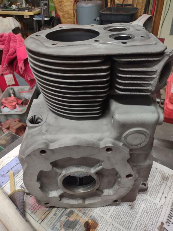

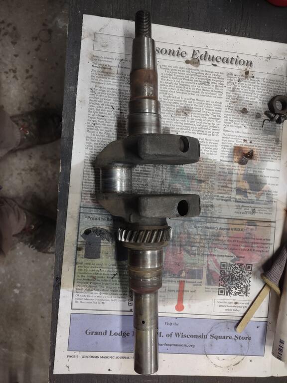

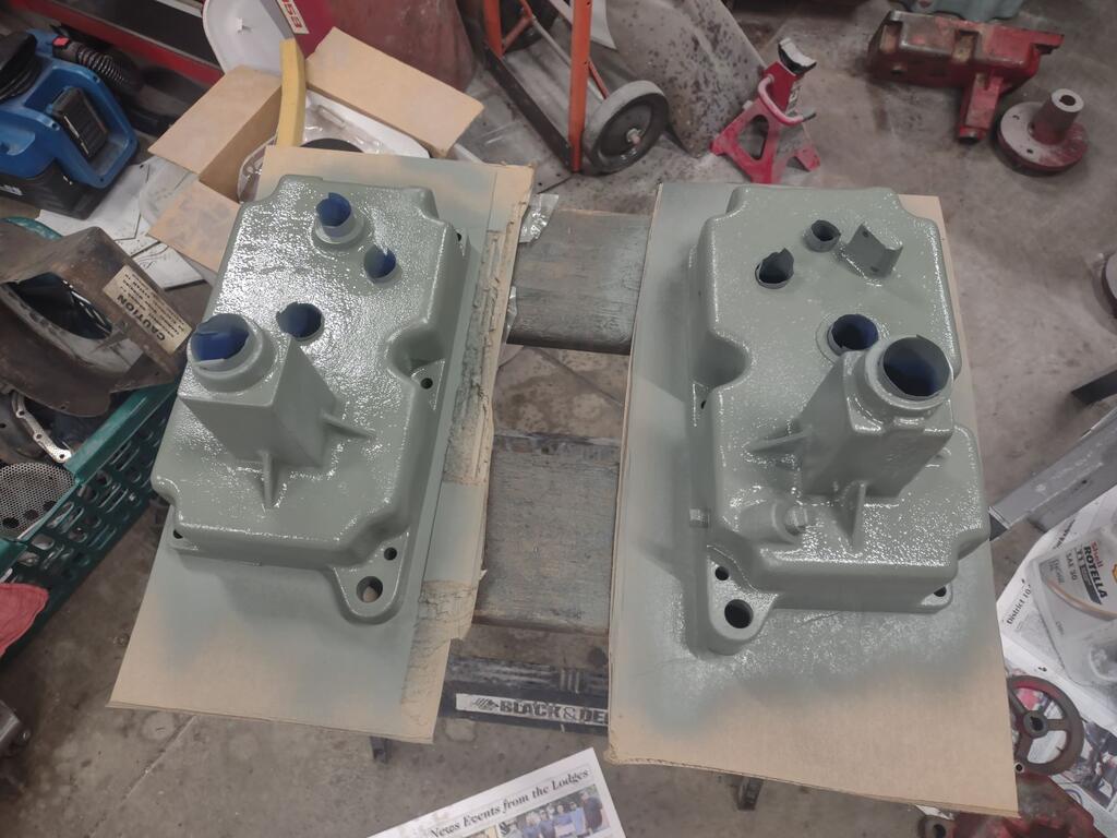

Achto 32,964 #55 Posted February 27, 2023 A lot of sand blasting and a little bit of painting today. Painted some of the small pieces that wouldn't pay to hang up for spraying with the gun. Parts are in so I have the crank shaft cleaned up & ready to go to my machinist to get turned down to .010 under. Unfortunately I have to use different machinists for the crank & block. Block is also ready to head off to get bored out to .020 over. 5 3 Share this post Link to post Share on other sites
Wild Bill 633 943 #56 Posted February 27, 2023 10 hours ago, Achto said: Unfortunately I have to use different machinists for the crank & block. Block is also ready to head off to get bored out to .020 over. FYI, I have used Fond du Lac Auto Machine & Parts & Pakes Engine & Machine in Janesville. Both very good. 2 1 Share this post Link to post Share on other sites
Achto 32,964 #57 Posted February 27, 2023 (edited) 11 minutes ago, Wild Bill 633 said: FYI, I have used Fond du Lac Auto Machine & Parts & Pakes Engine & Machine in Janesville Currently I use Tiry Race Engines in Ripon for the crank work & Mag machining in Pine River for the block. I will check out that Fond du Lac shop. Thanks Edited February 27, 2023 by Achto 2 Share this post Link to post Share on other sites
WHX?? 58,388 #58 Posted February 27, 2023 1 hour ago, Wild Bill 633 said: FYI, I have used Fond du Lac Auto Machine & Parts & Pakes Engine & Machine in Janesville. Both very good. I had no luck with FDL auto machine. Took a Clinton block there for work once. They had it for 6 months and never got at it. Finally had to get it back and go elsewhere. Thing that ticked me off is if they couldn't get at just tell me. I would stick with your guys Dan or my guy in Columbus. My guy ground crank & 10 over bore for a buck quarter in that motor that Ryan toasted. He does race motors but appreciates us guys doing vintage motors. 4 1 Share this post Link to post Share on other sites

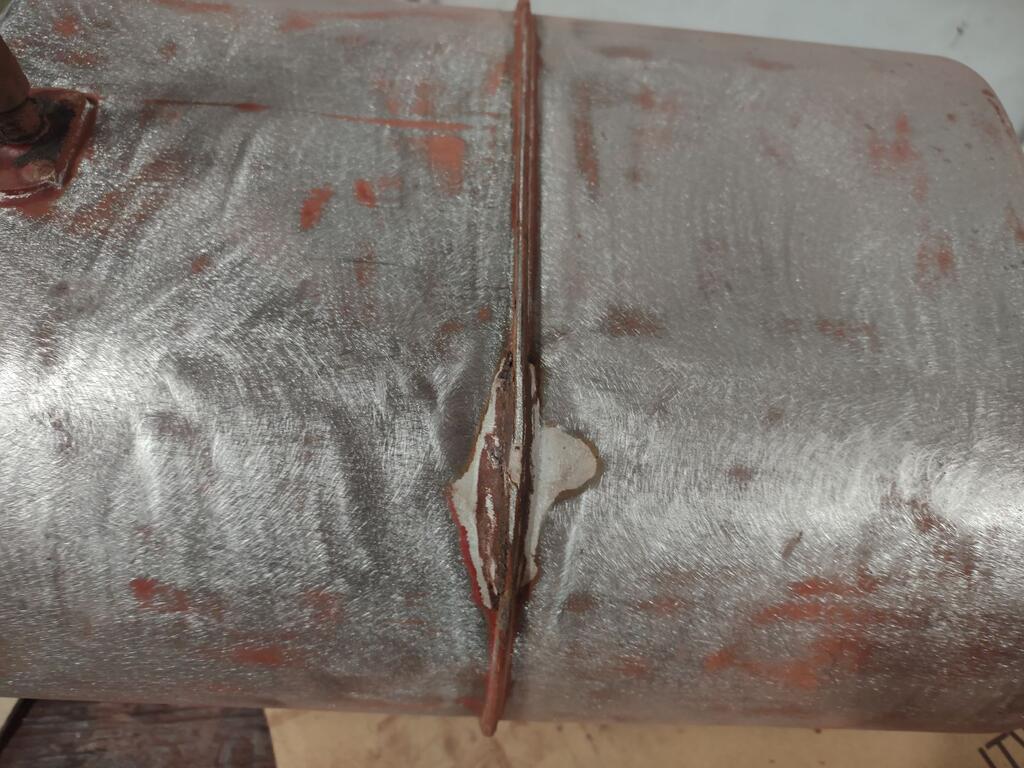

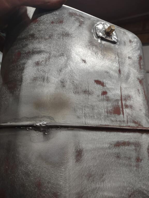

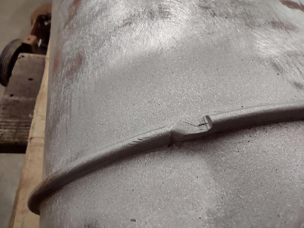

Achto 32,964 #59 Posted March 19, 2023 While striping the paint off from my gas tank today I noticed that there was a lot of flaking paint on it. This is never a good sign as that usually means that there is a leak some place. Really made me wonder because the inside of the tank looks like brand new. After getting the paint off I found history of a JB Weld repair. Sorry but as this tank showed, JB weld is usually not a long term tank repair. After cleaning things up completely it looks like the seam either rubbed through on something or someone hit it with a grinder. I silver solder the seam, spread a baking soda past on it and put some gas in to see if I had the leak fixed. It was fixed but noticed a leak around the petcock plate. Gas was leaking around one of the rivets. Dump the gas out, clean the area well, and silver solder the rivets. Put gas back in and it has been sitting for 4hrs now with no leaks. My solder job ain't real pretty but it's holding. 6 9 1 Share this post Link to post Share on other sites
Lane Ranger 12,167 #60 Posted March 20, 2023 12 hours ago, Achto said: While striping the paint off from my gas tank today I noticed that there was a lot of flaking paint on it. This is never a good sign as that usually means that there is a leak some place. Really made me wonder because the inside of the tank looks like brand new. After getting the paint off I found history of a JB Weld repair. Sorry but as this tank showed, JB weld is usually not a long term tank repair. After cleaning things up completely it looks like the seam either rubbed through on something or someone hit it with a grinder. I silver solder the seam, spread a baking soda past on it and put some gas in to see if I had the leak fixed. It was fixed but noticed a leak around the petcock plate. Gas was leaking around one of the rivets. Dump the gas out, clean the area well, and silver solder the rivets. Put gas back in and it has been sitting for 4hrs now with no leaks. My solder job ain't real pretty but it's holding. Those tanks can be a problem. Big and a lot of surface to collect water! 3 Share this post Link to post Share on other sites
WHX?? 58,388 #61 Posted March 20, 2023 I have that KBS kit to use on the Amigo and now the two piece 502 tank. Last kit I ended up dumping most of it. They send enought to do a five gallon tank. It really does work if you apply it right. 2 1 Share this post Link to post Share on other sites

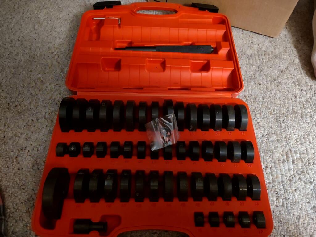

squonk 48,429 #62 Posted March 20, 2023 Details on the bearing and seal driver set Daniel! 2 Share this post Link to post Share on other sites
Achto 32,964 #63 Posted March 20, 2023 3 minutes ago, squonk said: Details on the bearing and seal driver set Daniel! Not real expensive, great variety of sizes, very happy with it so far. https://www.amazon.com/Prokomon-Bushing-Transmission-Bearing-Removal/dp/B0BHSJC3NJ/ref=sr_1_1_sspa?crid=TEJHDTSQ41AA&keywords=bearing+race+and+seal+driver+set&qid=1679316979&sprefix=bearing+%26+sea%2Caps%2C123&sr=8-1-spons&psc=1&spLa=ZW5jcnlwdGVkUXVhbGlmaWVyPUExSlhGWEJLMjc3SkJQJmVuY3J5cHRlZElkPUEwNjMxNTg2MkZVWEtFSVlMVEVYSiZlbmNyeXB0ZWRBZElkPUEwNjg0MTQ0T0tPQ0ZJTEFKM0ROJndpZGdldE5hbWU9c3BfYXRmJmFjdGlvbj1jbGlja1JlZGlyZWN0JmRvTm90TG9nQ2xpY2s9dHJ1ZQ== 4 Share this post Link to post Share on other sites
WHX?? 58,388 #64 Posted March 20, 2023 Way better than the set I got Squonky ... half the price but half the pieces and no sizes that fit our stuff... metric? Going to get one like Dan's . 2 Share this post Link to post Share on other sites
ebinmaine 81,284 #65 Posted March 20, 2023 3 hours ago, squonk said: Details on the bearing and seal driver set Daniel 2 hours ago, WHX?? said: Way better than the set I got Squonky ... half the price but half the pieces and no sizes that fit our stuff... metric? Going to get one like Dan's . I'll second that vote for a good kit. I have the same as @Achto's. All millimeter sized so there's a driver for whatever you need. I've used it just a few times and been very glad I bought it. 2 1 Share this post Link to post Share on other sites

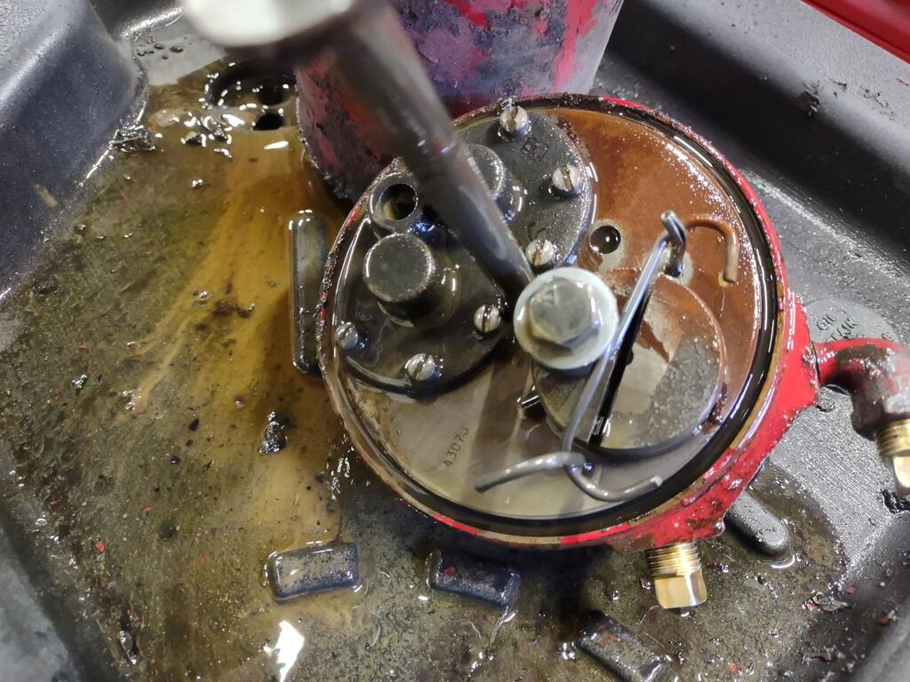

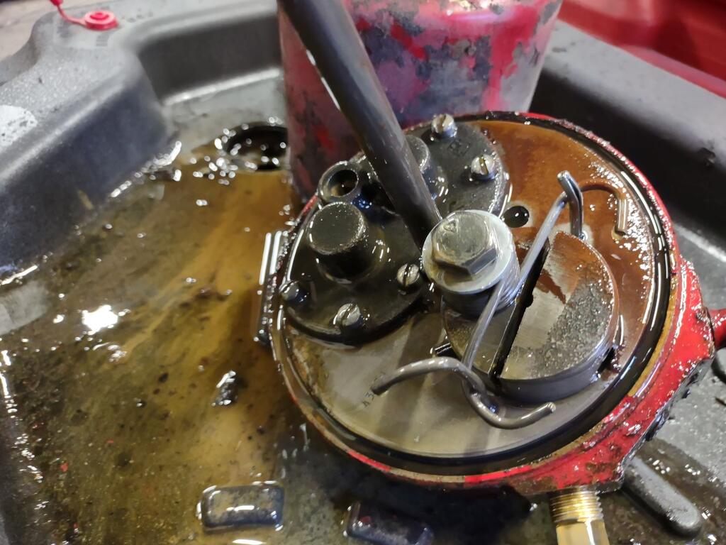

Achto 32,964 #66 Posted March 27, 2023 (edited) I pulled my HY pump apart so that I knew for sure what I need for parts. After I took the cover off all I could think was "What in the wide wide world of sports is a going on here?!?!?" Given the fact that this spring does not look in any way shape or form correct. I'm going to guess that this was an attempt to replace the stand up spring that should be in here. I think that I am going to order a stand up style spring to put it back how it should be. Any thoughts on this are welcome. Edited March 27, 2023 by Achto 7 Share this post Link to post Share on other sites
Handy Don 17,736 #67 Posted March 27, 2023 39 minutes ago, Achto said: Given the fact that this spring does not look in any way shape or form correct. I'm going to guess that this was an attempt to replace the stand up spring that should be in here. I think that I am going to order a stand up style spring to put it back how it should be. Any thoughts on this are welcome I have no idea what it should look like, but it looks like some pretty imaginative hacking there. 2 Share this post Link to post Share on other sites
Achto 32,964 #68 Posted March 27, 2023 8 minutes ago, Handy Don said: I have no idea what it should look like The return spring should look like this for a 953 pump. Newer pumps had this style of return spring. 4 1 Share this post Link to post Share on other sites
WHX?? 58,388 #69 Posted March 27, 2023 Well ya gotta remember the springs were made of unobtainium for a bit so necessity was the mother of invention. The donor transmission case in point. Poor PO prolly went to a dealer to get a part and dealer says yer nuts but I got a shiny new MTD here... 4 Share this post Link to post Share on other sites
Handy Don 17,736 #70 Posted March 27, 2023 Seeing that it’s an 953-style pump it looks like the PO had seen the setup of the newer style and did, IMHO, a pretty clever job of “upgrading” it to the newer style spring. Points awarded for ingenuity and effort. Bonus points if it was functioning as expected. 3 Share this post Link to post Share on other sites

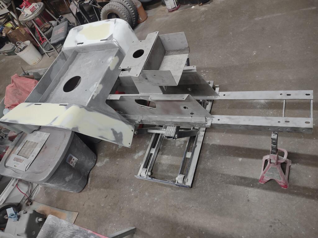

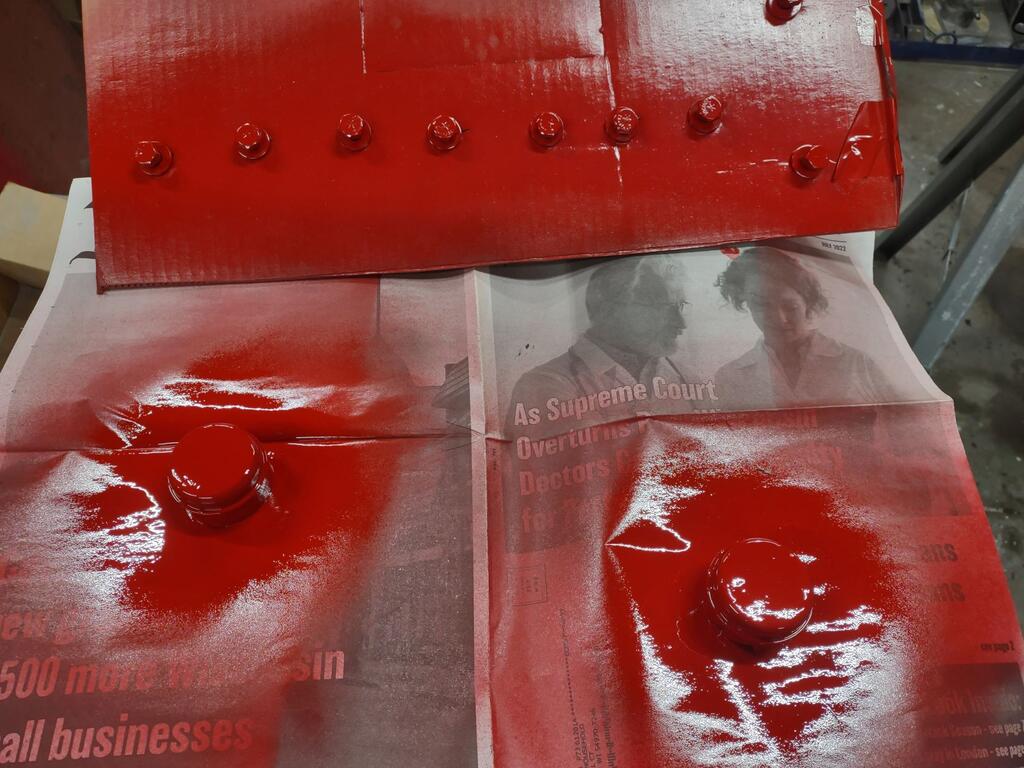

Achto 32,964 #72 Posted April 16, 2023 Been off this project for a bit while I was dong an engine rebuild on a farm tractor. With that off my plate it's time to get back on track. The only thing that I had not sand blasted yet was the frame / rear fender assembly. It was a nice 80+ degree day today so what would be better than to put on a coat, gloves, and a hood on. Then go stand in the sun to do some sand blasting. Sweated my way through it but forgot to take a picture, sorry. Some body work left to do on the fenders before it's ready for paint. After I was done blasting I was able to make some paint fly on the rims. 4 6 Share this post Link to post Share on other sites

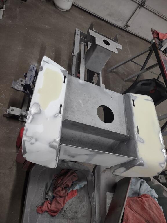

Achto 32,964 #73 Posted April 16, 2023 Todays agenda was to get the body work done on the rear fenders. With this done I am ready for primer & paint. Before I make paint fly on my tractor though, I have a few parts that I need to spray for a friend of mine. @WHX?? gonna need you to get me the rest of the parts for your 701. You've patiently waited long enough. 3 4 Share this post Link to post Share on other sites
WHX?? 58,388 #74 Posted April 16, 2023 20 minutes ago, Achto said: a few parts that I need to spray for a friend of mine. @WHX?? gonna need you to get me the rest of the parts for your 701. You've patiently waited long enough Waited hell... I got alot of other projects that are waiting for me to get off my kester... Betting it was a bastage to blast that beast... now you know why I am staying original. Shoulda borrowed @953 nut's rotisserie! 2 1 1 Share this post Link to post Share on other sites
Achto 32,964 #75 Posted April 17, 2023 3 minutes ago, WHX?? said: Betting it was a bastage to blast that beast Was not real fun, a lot of nook and crannies to get into. Even after a good pressure washing, I still found some grease to push around with the blaster. 5 1 Share this post Link to post Share on other sites
