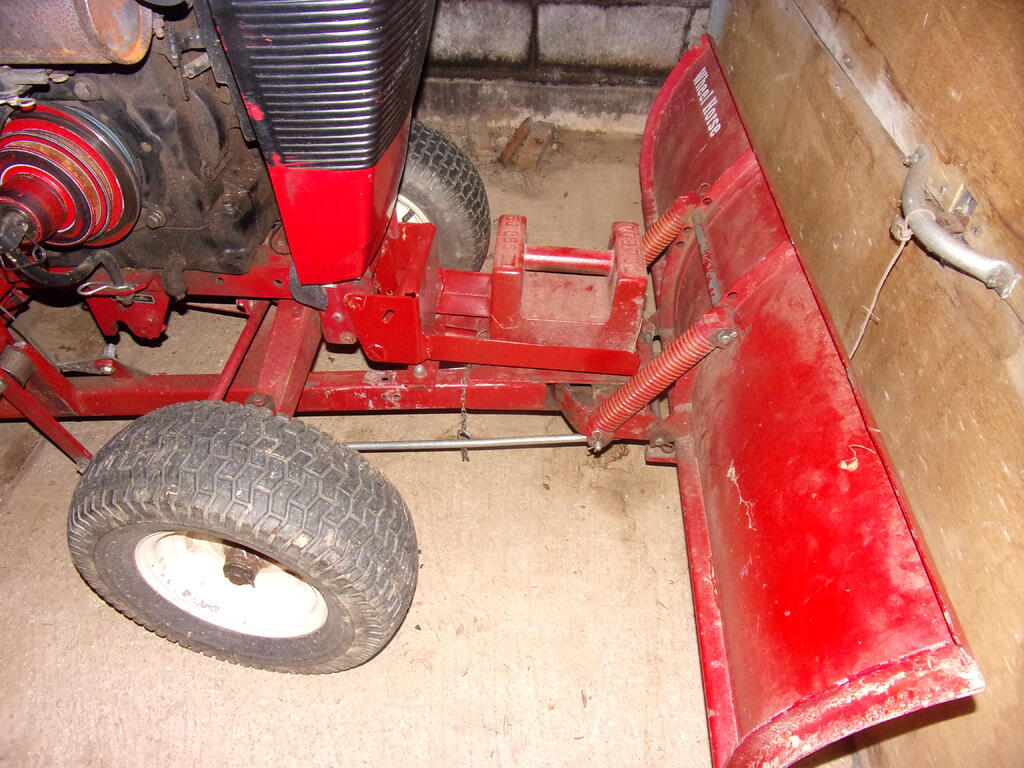

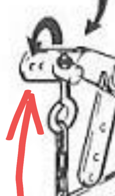

Ed729 57 #1 Posted December 26, 2022 Probably a stupid question so I apologize in advance. I’m trying to adjust the lift height to get my snow plow up as high as possible on a 312-8. While fine tuning the height I’m moving the nut up and down in my picture. The only way I can move the nut is by removing the pin and pulling it out, moving the nut with a wrench, then putting it back in the tractor. This seems inefficient and is very difficult to reinstall due to tight spaces and big hands. Is there an easier way? Thanks 2 Share this post Link to post Share on other sites

ebinmaine 80,100 #6 Posted December 26, 2022 Park the machine on level flat hard ground. Connect the rear (pivoting) point. Use blocks under the blade or frame to hold the plow up as high as possible. Hold it HIGHER than you actually want it. It'll settle down a bit. Adjust the nut and link while the plow frame is held in its max upward position. 1 2 Share this post Link to post Share on other sites

Blasterdad 3,167 #11 Posted December 26, 2022 You can also move the trunnion forward for more lift. 1 2 Share this post Link to post Share on other sites
ebinmaine 80,100 #12 Posted December 26, 2022 That's a good pic to show where the solid lift link would go. Outer lift hole at red arrow to the longer of the two plow holes. 2 Share this post Link to post Share on other sites
peter lena 9,993 #13 Posted December 26, 2022 @Blasterdad yup that trunnion , in my own opinion is the culprit , first off its a sloppy fit , attempted thin washer ing it up , is difficult at best . that threaded lift eye bolt would be my male / female 90 deg heim joint trial , very durable and smooth, also a solid , no wobbling fit. you can get those hein joints in all sizes / threading . think I would also , move lift chain , DOWN a link letting you thread heim joint up / down for smooth solid fit . BTW while / if you have that steering plow quadrant removed , great time to red grease detail that spring loaded pin slide point , can slide like a rifle bolt , smooth / solid . talk to me , pete 1 Share this post Link to post Share on other sites

Ed729 57 #19 Posted December 27, 2022 15 hours ago, ebinmaine said: Park the machine on level flat hard ground. Connect the rear (pivoting) point. Use blocks under the blade or frame to hold the plow up as high as possible. Hold it HIGHER than you actually want it. It'll settle down a bit. Adjust the nut and link while the plow frame is held in its max upward position. Thanks everybody. I’ll have to try this and see if I can get my hand up there. With the blade down it’s tight between the frame rails. I have it moved to the forward most hole for max lift, but the plow frame was hitting the axle before the lift mechanism would latch so I needed to bring it down just a little. I really wish the blade would go higher so you can still use the tractor with a plow on it for other tasks. It would be nice if there was a hinge at the front of the frame to move the plow up higher when not in use. I would probably leave it on all winter if it wasn’t always getting caught on every hill. 2 Share this post Link to post Share on other sites

ebinmaine 80,100 #21 Posted December 27, 2022 5 hours ago, Ed729 said: wish the blade would go..... ...... How about off? If it's the corner of the plow that keeps catching up, you could pull the two long pins at the front and drop the blade. Leaving the frame and pivot lever in place would be a little easier maybe? You can also put a pair of spacers between the rear axle mount and the axle. Lowering the rear of the plow frame raises the front. How much, I'm not sure. 1 Share this post Link to post Share on other sites
Ed Kennell 46,807 #22 Posted December 27, 2022 22 hours ago, Blasterdad said: You can also move the trunnion forward for more lift. Can you simply turn the chain /eyebolt around putting the trunnion at the bottom where you reach it without disconnecting it from the rock shaft lift lever? 2 Share this post Link to post Share on other sites

Ed729 57 #25 Posted December 28, 2022 10 hours ago, Ed Kennell said: Can you simply turn the chain /eyebolt around putting the trunnion at the bottom where you reach it without disconnecting it from the rock shaft lift lever? Yes. With the plow blocked up as suggested there is no tension in the chain so I can turn it 90 degrees and get a wrench on it without removing. Thank you everyone for the help, you turned a 15 minute adjustment into a 30 second adjustment. I agree bigger front wheels/tires would help. I would love to switch to 8s which would also add opportunities for front wheel weights. 1 Share this post Link to post Share on other sites
