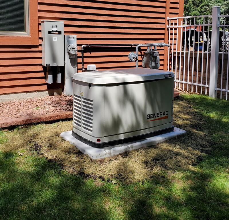

Red-Bovine 337 #30 Posted December 23, 2022 We have a portable 5KW Generac that we used for years on an occasional outage that lasted a few hours or more. We had a 15 hour outage last year in November, so we decided to go bigger with the Natural gas fuel and auto changeover. We travel more and wanted to be sure the house was safe. 3 Share this post Link to post Share on other sites

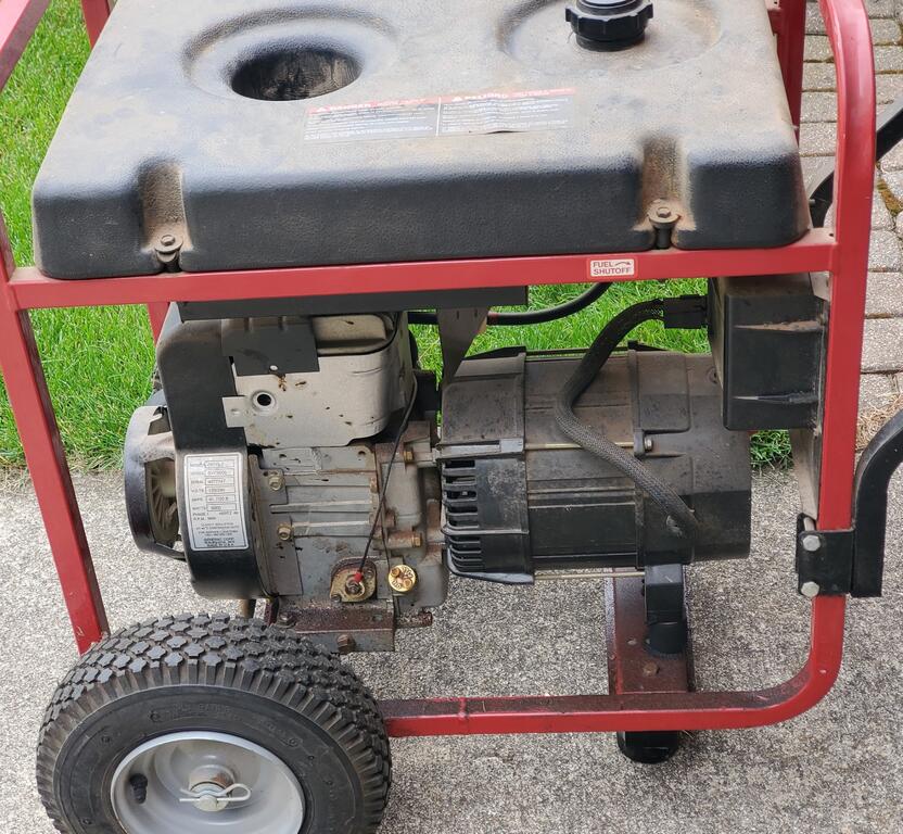

SylvanLakeWH 31,129 #32 Posted December 23, 2022 Fired mine up yesterday... Battery is toast so pullstart 4 times and it fired right up... May or may not replace battery... thinking permanent jump to the E-141 horn battery with quick disconnect ... one less battery to maintain... Needed a bit of the @peter lena red on the choke cable... all smooth now...! 1 Share this post Link to post Share on other sites
peter lena 9,854 #33 Posted December 23, 2022 @ SLYVANLAKEWH gave up on the battery start years ago , just did not last , to be worth it , pull start is quick with choke , like the super lube small bottle oil , on cables , local h/w store 6 $ , BTW . those choke cables are what , I regularly use a small light extension spring on for cable pull assist , like this . you can easily make a cable work like magic , with lube and a light spring pull assist , the spring is always pulling against the cable , to assist close. that way its always involved in the pull assistance of the cable . note the spring extension rods I bent up ? makes adding spring easy . like everything I suggest , have many hours and starts on this , get the cable smooth and easy first , then spring assist it , you will never go back ,don't be afraid to try it have a good christmas , springy , pete 1 Share this post Link to post Share on other sites
pfrederi 20,325 #34 Posted December 23, 2022 My older 5kw unit is pull start (Tecumseh). I always drain the gas and run it out after use. Starts on 3-4 pulls in warm weather. Cold I give her just whiff of carb cleaner and she pops of 1-2 pulls. 1 Share this post Link to post Share on other sites

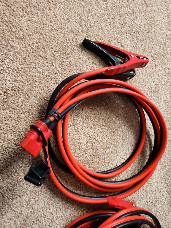

Racinbob 12,904 #35 Posted December 23, 2022 When I was researching the THD thing I looked at dozens of generators in the 8-10 kw range. Most were electric start with a pull backup. Much to my surprise many of them did not charge the battery when running. A few included a separate charger but most didn't. That's something to keep in mind if you're depending on the electric start. The one I ended up choosing did not charge the battery but I didn't care. It didn't come with a battery and I'm not getting one. I don't want another battery to maintain. It often starts on the first pull so that's what I do when it's warmer. Having a bad shoulder and full well knowing that my pull starting days are limited and out of the question for my wife. I also question if I could do it on a day like today (-10) even though it's in the garage. I purchase a medium quality jumper cables that I wouldn't mind modifying. They are only #8 wire but that's plenty big enough for this purpose. I picked up some Anderson connectors, cut the clamps off one end of the cables and installed the connector. I also installed a connector in the battery leads on the generator. If I need the electric start I simply plug the Anderson connectors together and hook it up to the nearest battery. After the fact I decided to purchase another set of the identical jumpers and do the same thing to them. Now, for whatever reason, I can connect them together for clamps at both ends. 2 Share this post Link to post Share on other sites

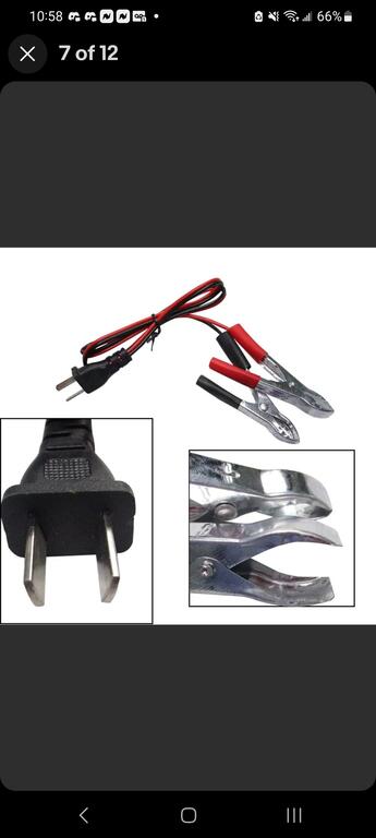

RED-Z06 2,718 #36 Posted December 23, 2022 8 minutes ago, Racinbob said: When I was researching the THD thing I looked at dozens of generators in the 8-10 kw range. Most were electric start with a pull backup. Much to my surprise many of them did not charge the battery when running. A few included a separate charger but most didn't. That's something to keep in mind if you're depending on the electric start. The one I ended up choosing did not charge the battery but I didn't care. It didn't come with a battery and I'm not getting one. I don't want another battery to maintain. It often starts on the first pull so that's what I do when it's warmer. Having a bad shoulder and full well knowing that my pull starting days are limited and out of the question for my wife. I also question if I could do it on a day like today (-10) even though it's in the garage. I purchase a medium quality jumper cables that I wouldn't mind modifying. They are only #8 wire but that's plenty big enough for this purpose. I picked up some Anderson connectors, cut the clamps off one end of the cables and installed the connector. I also installed a connector in the battery leads on the generator. If I need the electric start I simply plug the Anderson connectors together and hook it up to the nearest battery. After the fact I decided to purchase another set of the identical jumpers and do the same thing to them. Now, for whatever reason, I can connect them together for clamps at both ends. Many generators have a 12v outlet that puts out constant low amp 12v current to be used for charging a battery, on-board or external. Its the V shaped or T shaped plug. 1 1 Share this post Link to post Share on other sites
SylvanLakeWH 31,129 #37 Posted December 23, 2022 @Racinbob that is exactly what i'm thinking...!!! appreciate the pictures!!! 1 Share this post Link to post Share on other sites
Racinbob 12,904 #38 Posted December 23, 2022 (edited) 10 minutes ago, RED-Z06 said: Many generators have a 12v outlet that puts out constant low amp 12v current to be used for charging a battery, on-board or external. Its the V shaped or T shaped plug. I didn't know that and didn't see one but that's good to know. I have a 12v outlet but that's what it is, 12v. It won't do much good for charging. Edited December 23, 2022 by Racinbob Share this post Link to post Share on other sites

Darb1964 1,169 #40 Posted December 24, 2022 On 12/21/2022 at 5:34 PM, Red-Bovine said: We just installed a 24KW Generac whole house standby system last May. It motors all by itself every Monday morning so it should be ready if anything gets blown over. Had a 15 hour outage last year in November and the Hubby said no more of this. We put one many years ago and it has saved us many times. It' uses quite a bit of gas ,propane, but worth it, our home was built in1830 so even though I have insulated top to bottom it still cools off fast. Rather pay for fuel than frozen pipes. I think ours is 15KW. 2 Share this post Link to post Share on other sites
Red-Bovine 337 #41 Posted December 24, 2022 We haven't needed it yet, but it's like the fire extinguisher hanging on the wall. Good insurance. 1 Share this post Link to post Share on other sites
