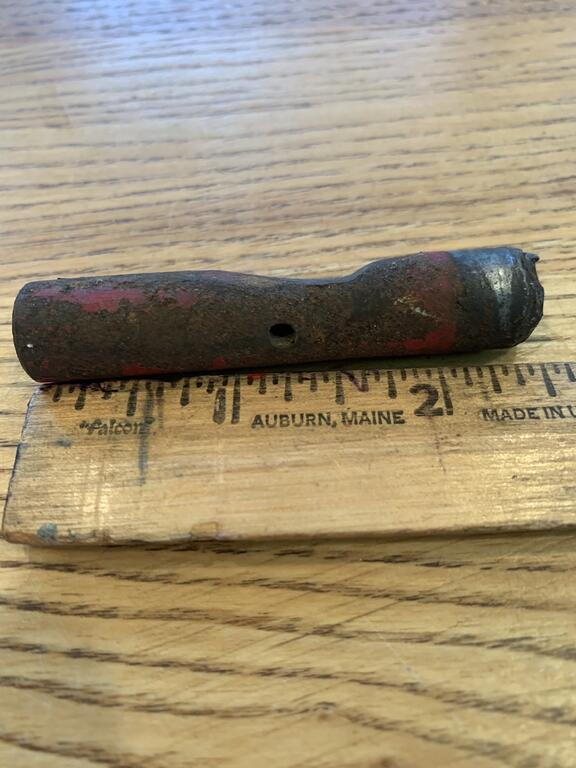

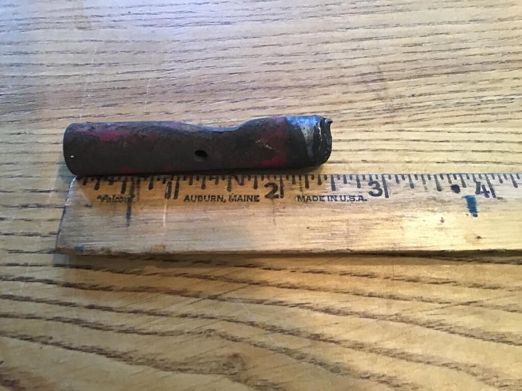

Wendelin Giebel 4 #1 Posted December 14, 2022 I discovered this pin lying on top of my mowing deck. It’s 2.5 inches long and we’ll worn with a hole for a cotter pin in the middle. I checked the deck manual but couldn’t find it? Has anybody seen this thing on their tractors? thank you Wendelin Giebel 1 1 Share this post Link to post Share on other sites
nylyon-(Admin) 8,938 #2 Posted December 14, 2022 Welcome to Looks like it’s the pin to raise the mower. Does the mower deck lift? 2 2 Share this post Link to post Share on other sites
RandyLittrell 3,944 #3 Posted December 14, 2022 On the right side is what is left of the weld I believe. If you look up under the tractor, you should see an arm with a hole and some weld remains around it. Randy 2 3 Share this post Link to post Share on other sites
Wendelin Giebel 4 #4 Posted December 14, 2022 I put the mower into a shop for fuel problems. They took deck off for sharpening . No , the deck wasn’t lifting so I bought a generic clevis pin and stuck it in The pin i photographed was found some time later. The pin Didn’t seem to have any means of staying put and serving as the lift pin so I figured I’d try posting it. I guess it it was just badly worn and lost it’s original dimensions . I will search and hopefully find the OEM part as the pin is a little skinny. thank you for you response. 3 Share this post Link to post Share on other sites
peter lena 9,893 #6 Posted December 14, 2022 @Wendelin Giebel LOOKS LIKE # 27 TO ME , you can pick up a used one or have a new stud welded into your unit , while you are there , lubricate all related movement spots , pete 3 1 Share this post Link to post Share on other sites
RandyLittrell 3,944 #7 Posted December 14, 2022 3 hours ago, peter lena said: LOOKS LIKE # 27 TO ME I would bet a big mac on it!! Randy 2 1 Share this post Link to post Share on other sites
peter lena 9,893 #8 Posted December 14, 2022 @RandyLittrell extra ketchup , pete 1 1 3 Share this post Link to post Share on other sites
Handy Don 16,682 #9 Posted December 14, 2022 A new piece of rod welded back into place on the #27 arm should hold for another 25 years or so. Good luck! 3 Share this post Link to post Share on other sites

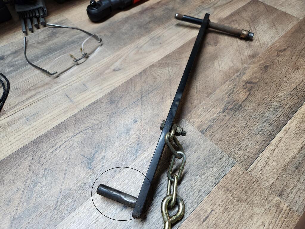

Racinbob 12,980 #10 Posted December 15, 2022 This: 3 1 Share this post Link to post Share on other sites
953 nut 66,305 #11 Posted December 15, 2022 14 hours ago, peter lena said: @RandyLittrell extra ketchup , pete Don't fall for it @RandyLittrell, could be Lucas Red 2 1 Share this post Link to post Share on other sites
953 nut 66,305 #12 Posted December 15, 2022 19 hours ago, Wendelin Giebel said: I will search and hopefully find the OEM part If you call Lincoln at A-Z Tractor Parts he should be able to fix you up with a good arm like the one @Racinbob posted. https://www.a-ztractor.com/ 2 1 Share this post Link to post Share on other sites
